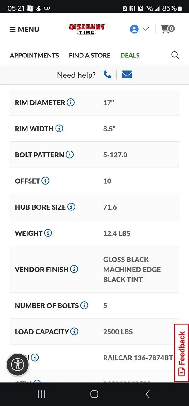

Tires are 68 pounds each rims 13 each.
Ive seen exactly zero 17” wheels for a jeep that weigh less than 24lbs
edit: theres probably a couple that are 7.5 wide somewhere that are a couple lbs less but they are gonna be expensive and not very strong.

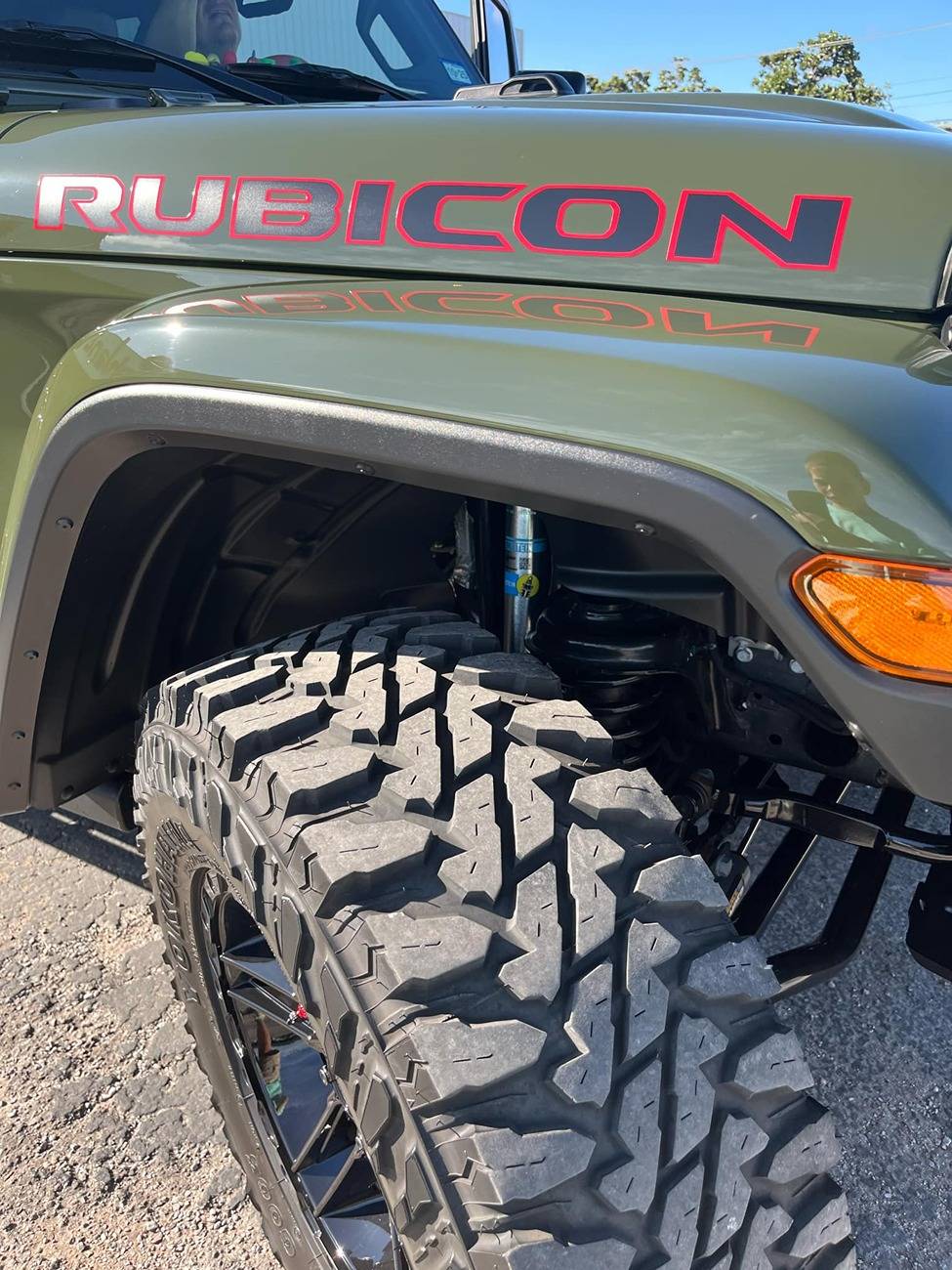

Wow thanks everyone! All this makes me think running 5.13 might not be a bad idea. I have a full steel exo-cage (not pictured) and loaded down bed (~ 600lbs in the bed at all times usually). I was worried I was getting a bit too low, but it seems like no one is having isues with the gears atthis size at distance.
@Zachanadandy - Based on what you were saying though if I can get away with 4.88s it might work out better in the long run as the deep gears might not be worth it unless it's really nessisary. I don't tow, just have a ton of overlanding gear and roll cage.
My factory 17x7 aluminum Rubicin wheels were 44ibs. The steel rims I replaced with 17x9 are 47ibs. The tires are 68ibs. I think 🤔 at any rate 13ibs sounds like a mistyped reply.
The lighest wheel I've ever seen in a 17 in wheel is 21lbs on the dot. What wheel are you running?
