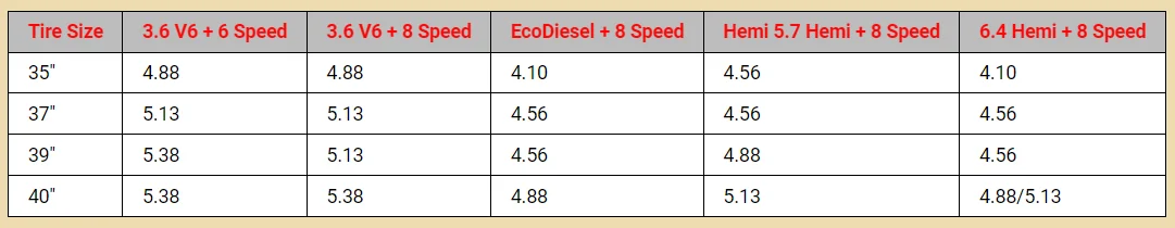

Mine has 4.88 gears and I just took it on a 3,000 mile trip. Here is a chart from my local 4x4 Company tire size and gearing.
Jeep Gladiator 4.88 Gears Safe For Distance On Highway? 1724083479331-tr

4.88 with 37s is about 2,200 RPM at 70 mph.
5.13 with 37s is about 2,300 RPM at 70 mph.
With hills and extra weight, you have a good case for 5.13.

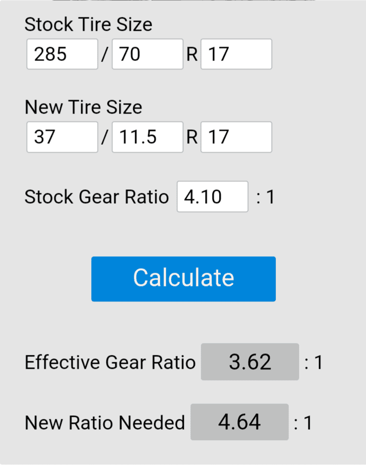

Assuming a Rubicon or Mojave with factory 285/70R17's, a 4.88 gear would get it really close to turning the same rpms and driving very similar to factory.
Jeep Gladiator 4.88 Gears Safe For Distance On Highway? Screenshot_20240819-132243
