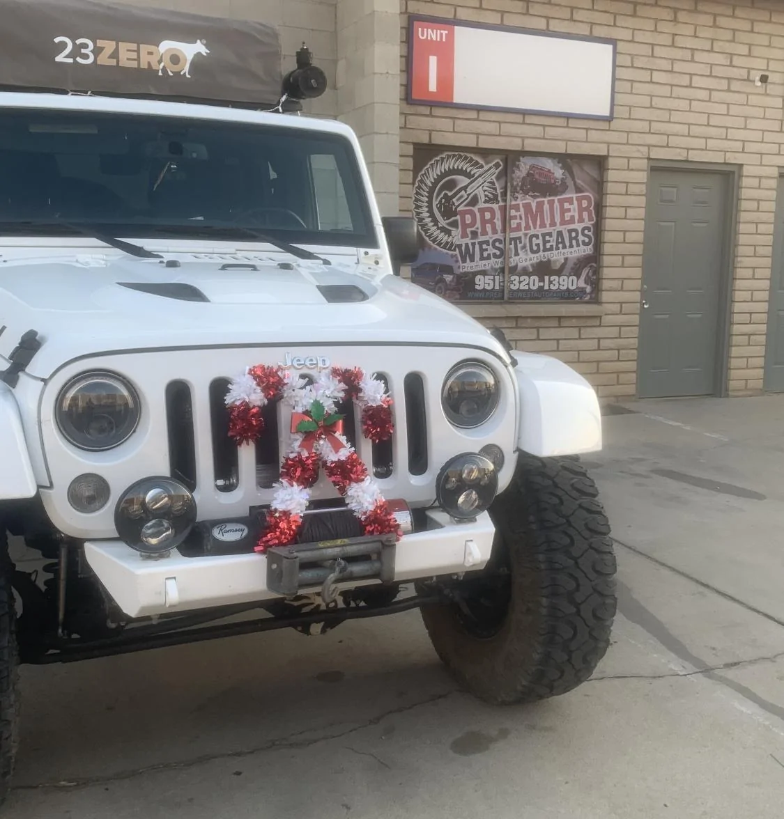

Also- hit these guys up. Hands down best place in Southern California to get gears done!!!!
