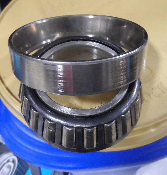

Reuse the bearings? That might be an even worse idea than used gears. I've never done a Dana 44, but usually the bearings and races are press fit. They are meant for that to be done once. IF you get them out without distorting or damaging them, they still arent going to hold like they are supposed to. And bad things happen when parts spin that arent supposed to.
........no kidding. You should see the shims I removed from the right side of a carrier a few months ago. Obviously there was a problem as the shims were scored and gouged. Hmmm, if the bearing race or cup isn't turning, how's that happen? It was just starting to dig into the differential housing itself. Caught it.
