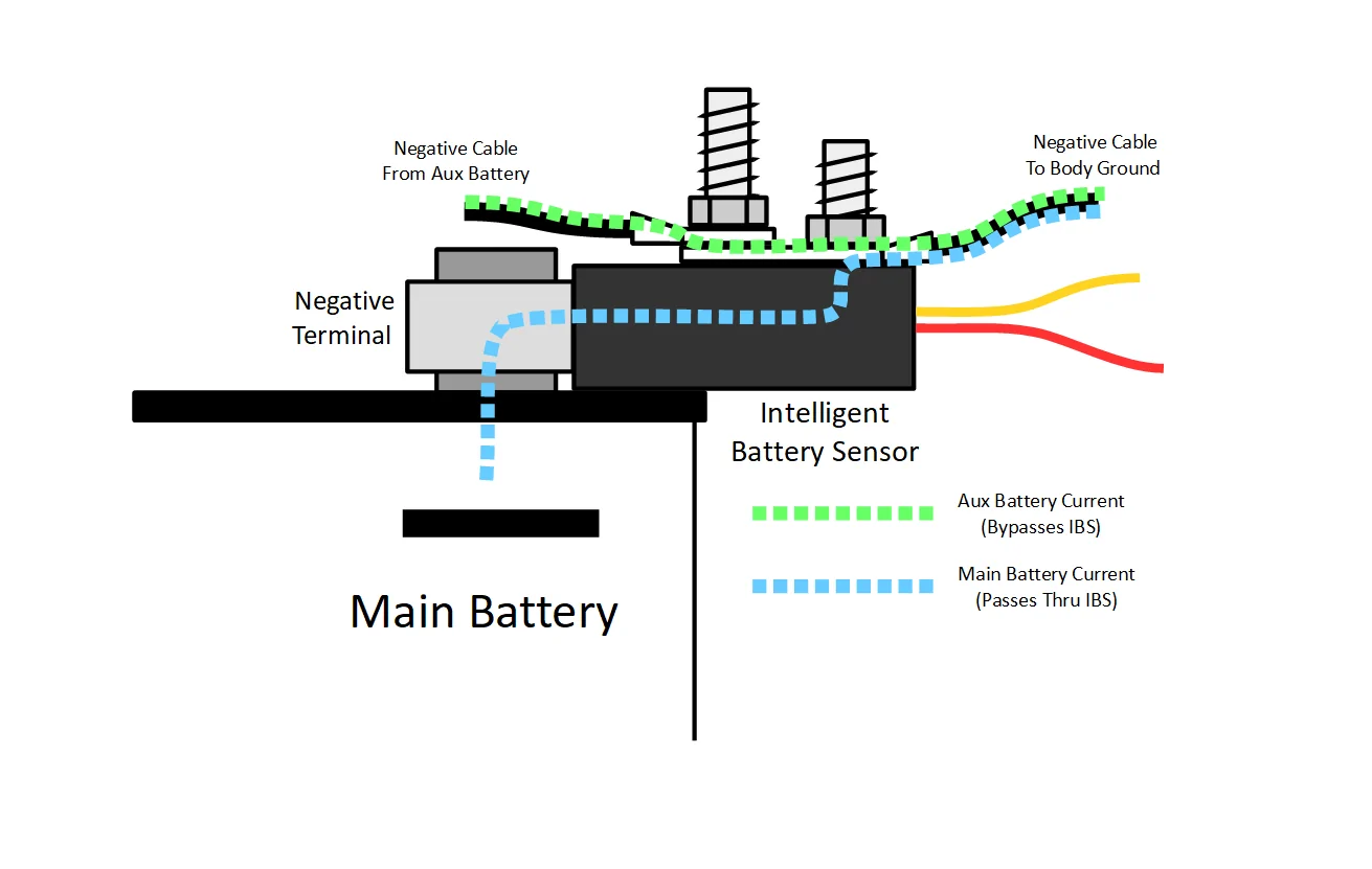

As others have stated, the IBS has nothing to do with the aux battery. Here's my diagram that shows how the aux battery current does not interact with the IBS.

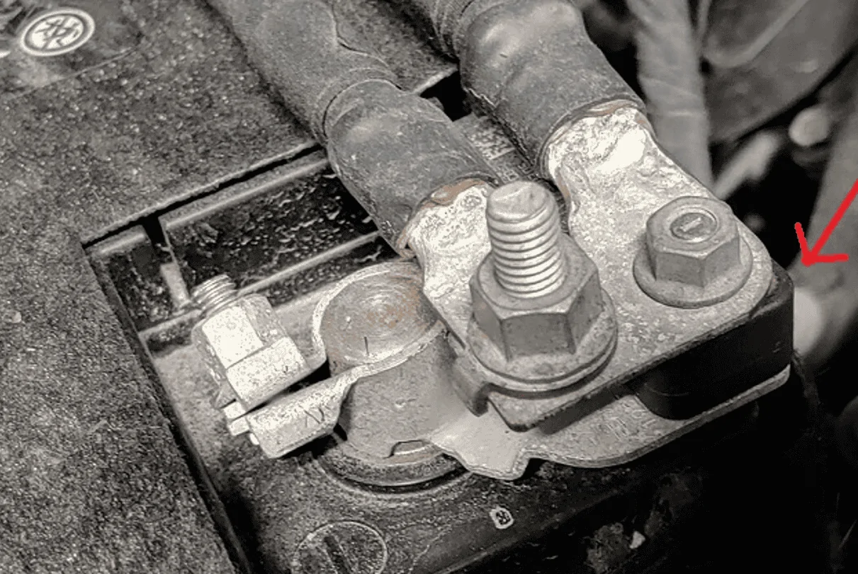

Nailed it. The aux battery ground is pretty much direct to the body ground. The IBS is simply a terminal block, a junction point, where the aux battery cable and chassis ground cable meet. The IBS is basically just a point where they meet. (technically, the IBS isn't even the junction, it's only holding the connection - the connection is the other, larger nut)

If that top connection that joins the two ground cables to the top of the IBS was loose, definitely could run the main battery down - further, heat could have actually damaged the IBS. Resistance, heat, arcing, whatever.

Like the man said - aux battery negative cable clamps directly to the chassis/body ground cable. If that small nut (on the right in this pic) is loose, you have problems.
Upon further review, I may need a new theory. As long as the alternator is working, a discharged main battery should not cause a power failure while the engine is running. Either the alternator failed first and the charging CEL was not noticed or the N3 fuse was already blown and the aux battery ran down causing the power failure.

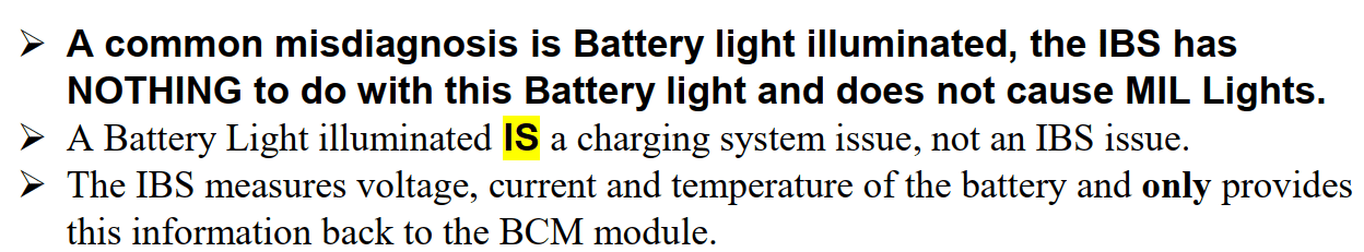

From FCA IBS documentation:
Jeep Gladiator Sudden catastrophic power failure at 13 months 20,000 miles. 1702430352865
if the alternator is working and there's an intact path to both batteries (through the high current fuse) then both would receive charging current.
A blown N7 in the high current fuse array would mean no charging current to either battery, and nothing from the alternator to the bus. So the truck would be running on battery only.
