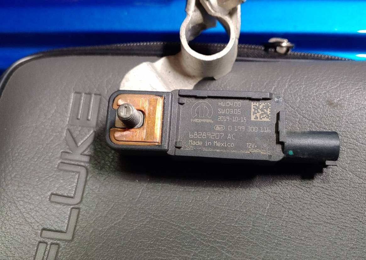

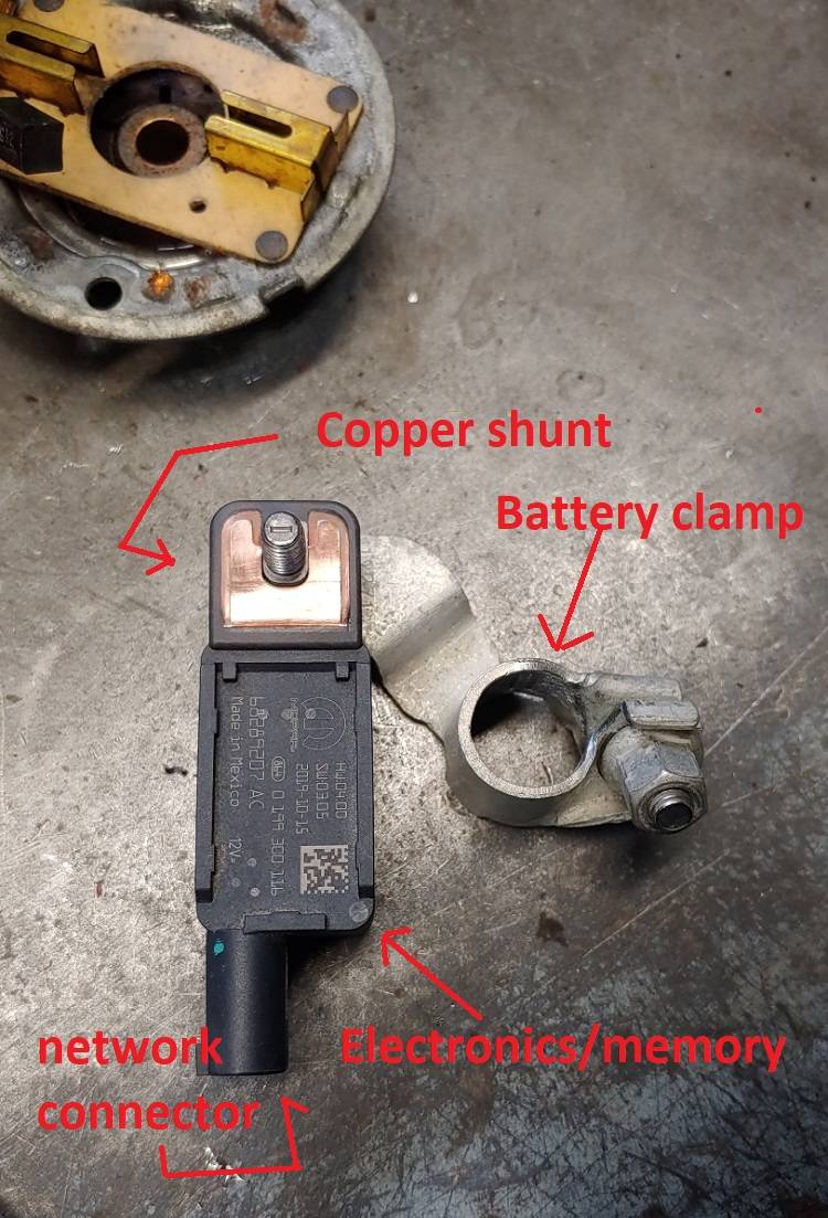

Here is that "sensor" on the negative battery terminal -
Jeep Gladiator Sudden catastrophic power failure at 13 months 20,000 miles. JT-neg-bat-post-cables-ibs
If either of those two nuts is loose, or, the clamp on the terminal is loose, it causes crazy, weird things to happen including shutdown, melted parts and so on.
You say it's a non-essential part - yeah, it is essential as it is part of the vehicle's charging system much like a voltage regulator is. It senses current going INTO and OUT OF the main battery and only the main battery. It senses the battery temperature. Those readings help the PCM determine how much to ramp the voltage up or down for main battery charging (along with other factors like engine torque/load and so on).

IF he's talking the IBS, it is an essential part of the vehicle's charging system these days.
Here's a partial list of cars using the IBS -
RENAULT.
BMW.
AUDI.
OPEL.
MERCEDES-BENZ.
I should say that the IBS helps make ESS possible, but the IBS has many functions and providing SoH and SoC information for ESS functionality is part of that. The IBS is what tells the PCM or BCM when the battery is hot so the charging voltage can be cut down to prevent battery overheating. It's used for emissions and mph benefits as well, since it's a huge waste using a constant charging voltage even with a fully charged battery. That alternator can take some HP from the engine when you need it, so why run it on a full battery?
The IBS is what helps make a smart charging system "smart".
So while it's involved, even without ESS, you'd have an IBS.

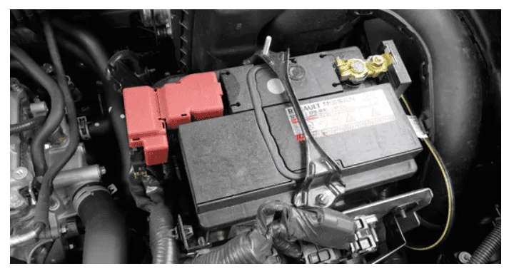

Here's another style of IBS used on a single battery system -

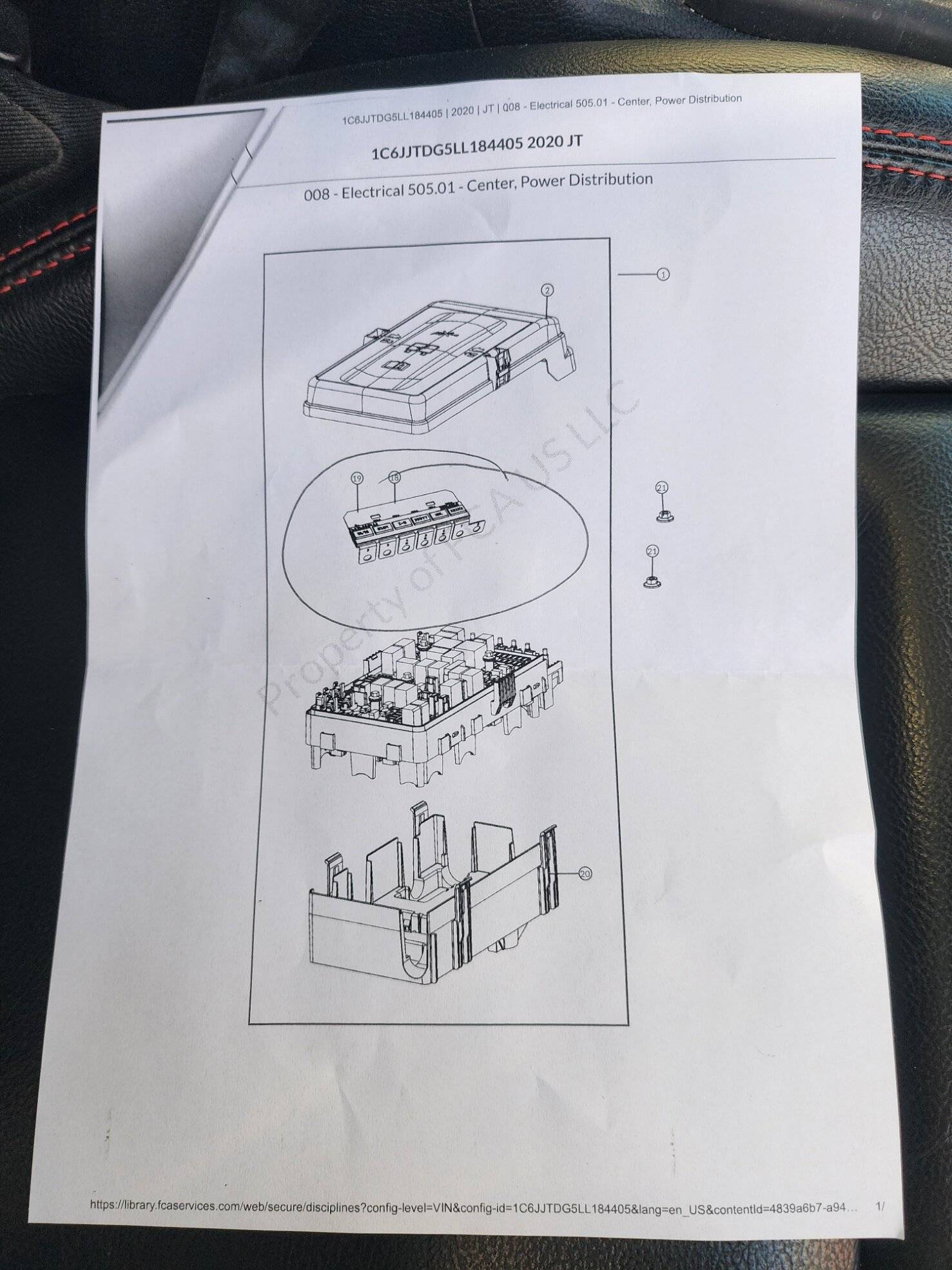

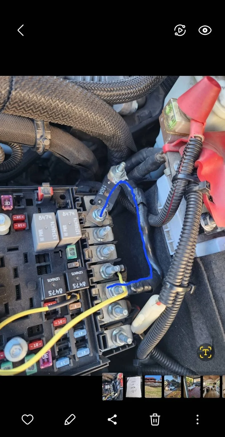

I had this happen to be and it blew one of the main fuses in the Fuse Array. Cause was loose battery leads on MAIN BATTERY after Stop/Start battery replacement by dealer. Dealer would not admit re loose battery leads but they replaced Fuse Array free of charge!! surprise surprise. Attached are videos and the dealer report with recommended part replacement. (Note the dealer that did temp repair was not the dealer that replaced the battery) Also attached is a pic of the temp fix by dealer that handled our breakdown. We drove around for 3 x weeks like this with no fuse box cover on whilst waiting for part.

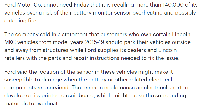

I hope you aren't meaning report to NHTSA........
NHTSA is about safety issues. Reporting "I had electric issues and had to find a place to pull over and stop" is extremely generic. Report what? You had electric issues? And like shown above here - could be loose connection, could be a tech screwed up, could be........... could be.......
Reports like that are nothing to NHTSA and simply work to clog their already busy system when Bubba gripes of some loose handle or something and says he's gonna sue (there's crap like that out there in those "reports" or "complaints". It's hilarious to read some of them)
Report a loose connection? To who? And who is going to prove why it was loose or when it came loose? It could have literally been loose since before the first visit for any work.
NHTSA is about safety concerns, they look for commonality, common causes, root causes, defects in materials, design, workmanship. Issues like in these can be caused by many different things.
I bet if you look at the complaints of this exact scenario, the causes are quite different in many cases, the age of the vehicle very different, and it was totally annoying and inconvenient, but not something the NHTSA would be very concerned with. I'd also bet the numbers are small in the end - made to look worse because forums are where people are funneled in to talk about complaints and problems.
Confirmation bias at its finest. Because I can find similar threads on my issue when I do a search specifically for it, that means it's widespread!
