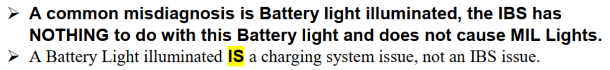

Not saying battery - but that battery symbol means charging system.
So if it's a charging system issue, the thing may be saying "hey, we don't have enough power to keep things going and rather than have you stall in traffic and not get started again, we're going to warn you and shut 'er down"
This is from FCA - note they actually highlighted the word "is" -

Pretty much what i said - there's a charging system issue, low voltage detected...
But jumping at batteries isn't the solution - logical, methodical troubleshooting, using a volt meter............. he could toss in $300 worth of batteries and still have the same problem. At this point, it's very likely the batteries ARE low - that charging system fault light tells us that, even if the batteries are fine, they'll be low if the truck was running purely off the batteries with no help from the alternator.
