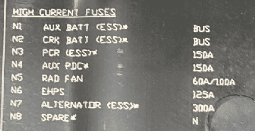

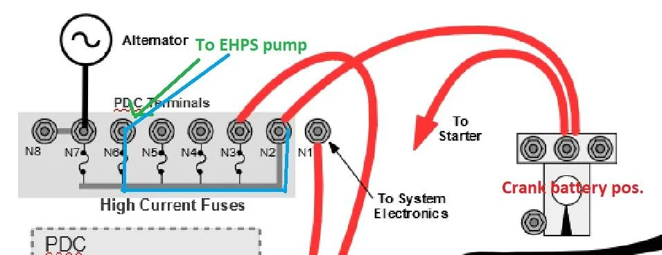

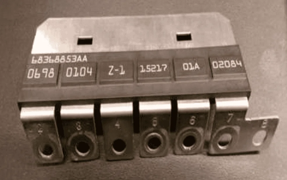

This is the high current fuse array. I suppose if you want to call it a master.......... but it is responsible for the charging of the batteries and the EHPS and cooling fan, etc.

Here is what it handles -
Jeep Gladiator Sudden catastrophic power failure at 13 months 20,000 miles. fuse-array-6

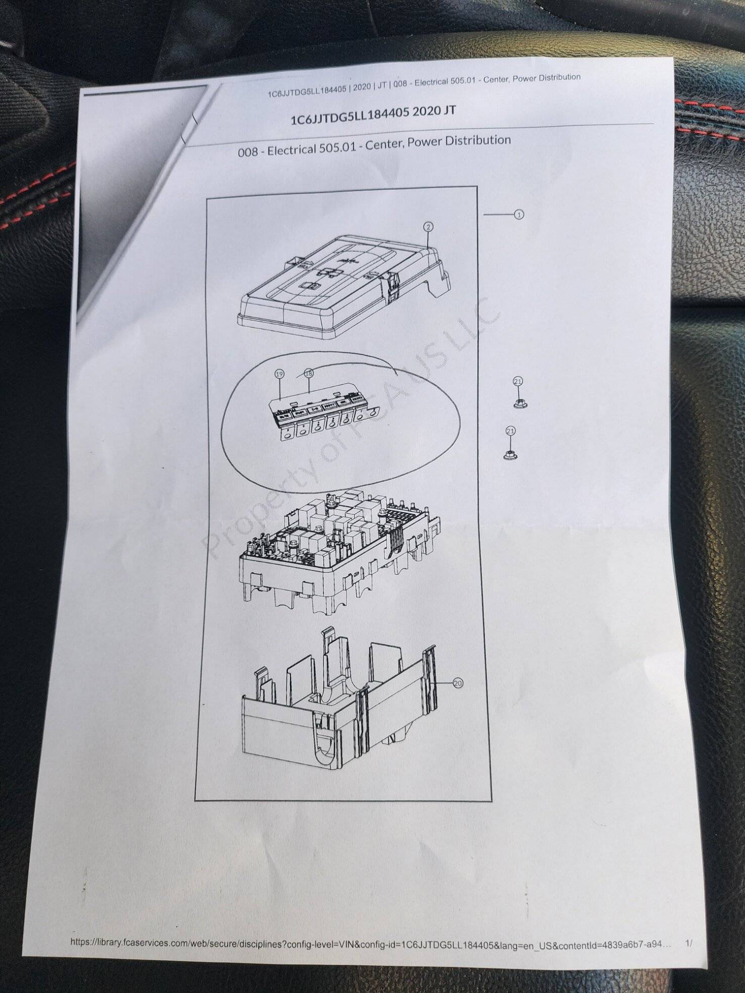

Not sure what he means by a "blown master fuse". All I can figure is one of the multiple legs of the high current fuse array blew. It's not something you carry a spare for unless you mess with and mess up your electrical system. it's not a unplug and plug back in. Not horrible to replace, but does take tools and care and it's cost is something getting close to $200 if I recall correctly - maybe closer to 175......
If he's referring to the high current fuse array - it's at the end of the fuse panel/PDC and it's where those multiple nuts on studs are (marked N2, N3 and so on) - that's one big fuse.

It shouldn't be difficult for them to find out why there's no power to anything - all of that resides in the PDC, where that high current fuse sits on the bus.

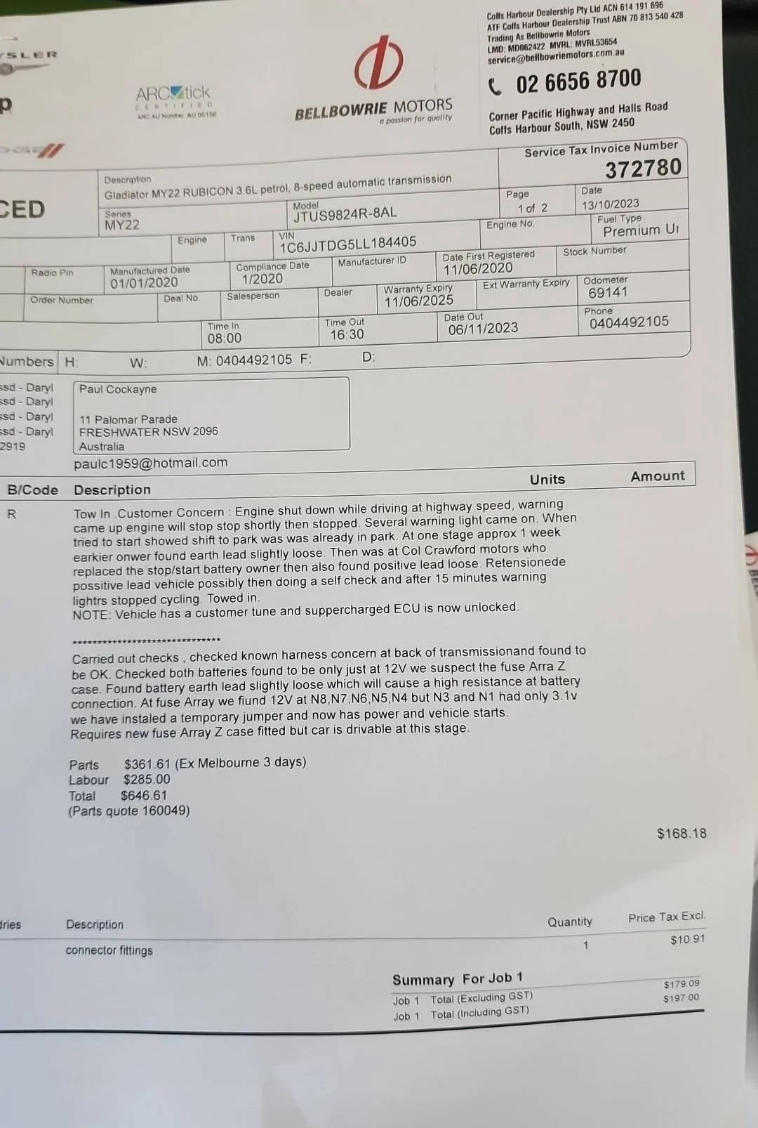

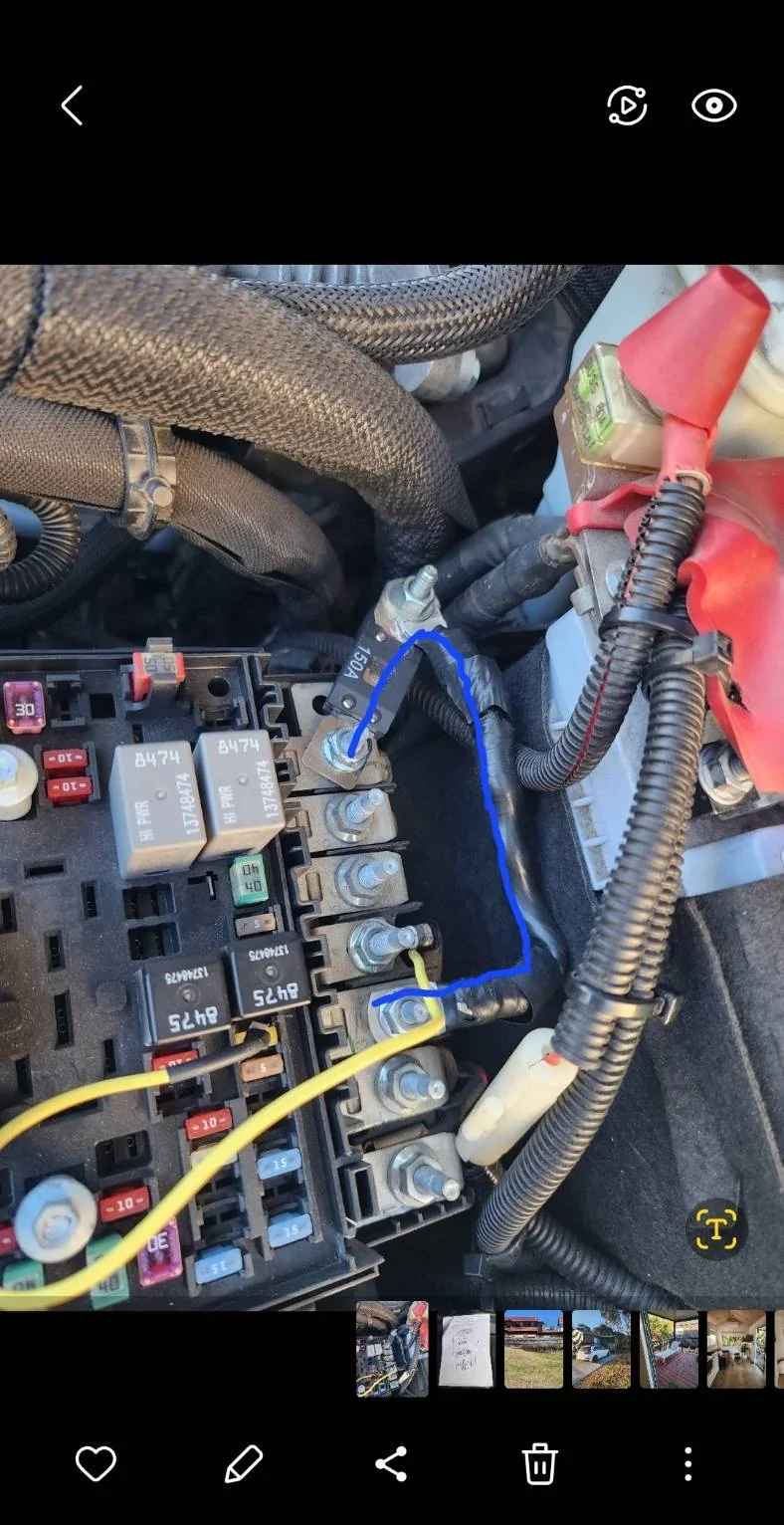

I had this exact thing happen to me here in Australia. The dealer had replaced the stop start battery. I drove 900kms and found the negative battery lead loose so tightened. Drove another 4ookm and had the same pull over warning lights on. Engine kept trying to start and just kept cranking then everything went blank. Checked under bonnet/hood and positive battery lead was totally loose. Thus battery would have been intermittently charging/not charging and spiking. Blew a main fuse. Temporary fix for now by the local dealer where we were at. Now awaiting a whole main fuse bank. PLEASE NOTE THIS WAS NOT THE DEALER THAT FITTED THE LOOSE BATTERY LEADS.
This is where people need to see Tysongladiator's youtube video
https://www.jeepgladiatorforum.com/...-those-batteries-just-yet.74283/#post-1211885
He addresses that high current fuse array (the fuse to which you refer) and the loose connections at the battery terminals and more. Simple stuff that can pretty easily be checked, and he shows the parts and examples.
As often as people through loose connections like this, or owner themselves blowing the fuse by not understanding how cables should be removed and separated, you'd think dealers would have at least a couple of these on the shelf (both versions)
That same high current fuse array is used in Gladiator, Wrangler (JL/JLU) and the Wrangler 4xe - in other words, a huge chunk of the Jeeps out there use this thing. To not stock one is at the very least, interesting.

And you would expect the dealer service to know how to attach/tighten a battery lead!!

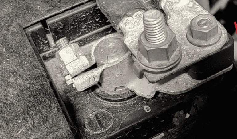

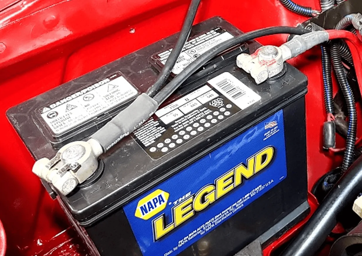

The problem is more that the part isn't designed to any sort of range of battery terminal dimensions.
Once it reaches a point, it's tight. The nut stops turning. The ends of the clamp make contact with each other, butunless they tug on it or actually try to twist it, it will appear they've done a good job. Although it feels tight, the wrench says it's tight, it's a poor fit on the post.
I sort of wonder if the battery terminal sizes have gone the route of toilet paper - same price, smaller rolls. That's just a musing, not fact or even "educated guess".
Modern cable clamps have very little range - or at least aren't made to work on terminals that are worn, have been cleaned or might be on the small size of "spec range".
Look at the range of post sizes these cable clamps can accommodate compared to those on the Jeep -

Jeep - nut tight and yet is it snug on the post?
