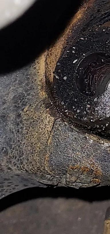

Left front axle.
Jeep Gladiator 23, 19,000 miles ujoint failure 20260127_164737
Jeep Gladiator 23, 19,000 miles ujoint failure 20260127_164737_resized

Looks like what was happening on my 21 JT. I started hearing clicking noises from the front end, noticeable at low speed.
Turns out front axle u-joint bearing cup had lost the retaining clip and was starting to work itself out. Local drive line service shop gave me a couple of clips. I was able to tap the bearing cup back into place. I kept an eye on it after that.

Thanks for the comments, do you think the axle shaft is cracked in the second photo, or a casting line?
That looks like a crack. I suspect you will need to replace the axle.
Is your truck still under warranty?

Thanks for the comment, yes it is still under warranty, I had the same clicking noise as you after applying the brakes at slower speeds.
Good. Hope you dealer takes care of you.
I was lucky that I caught mine before the bearing cup went away and it lost the needle bearings.

I've had a clicking for a year. At slow speeds kind of coasting. Barely under power. Around 10-15 MPH. U joints look ok. No play that I can find. Probably gonna take it to the dealer before warranty is up
Big caliper bolts loose, or splash shield maybe?

What kind of off-roading did this rig see? Any hard hits, or just normal DD on road duties?
