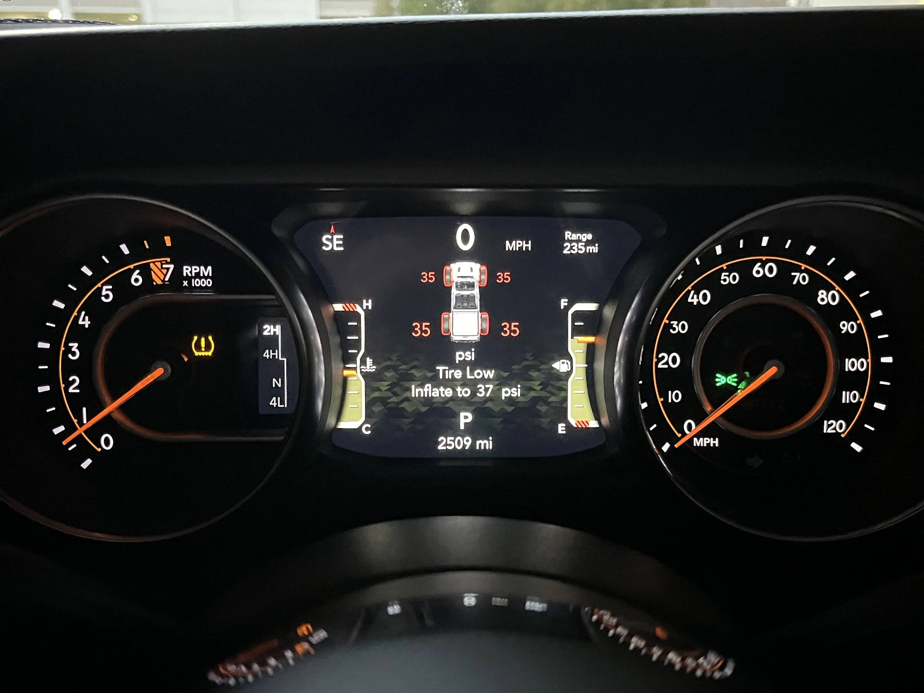

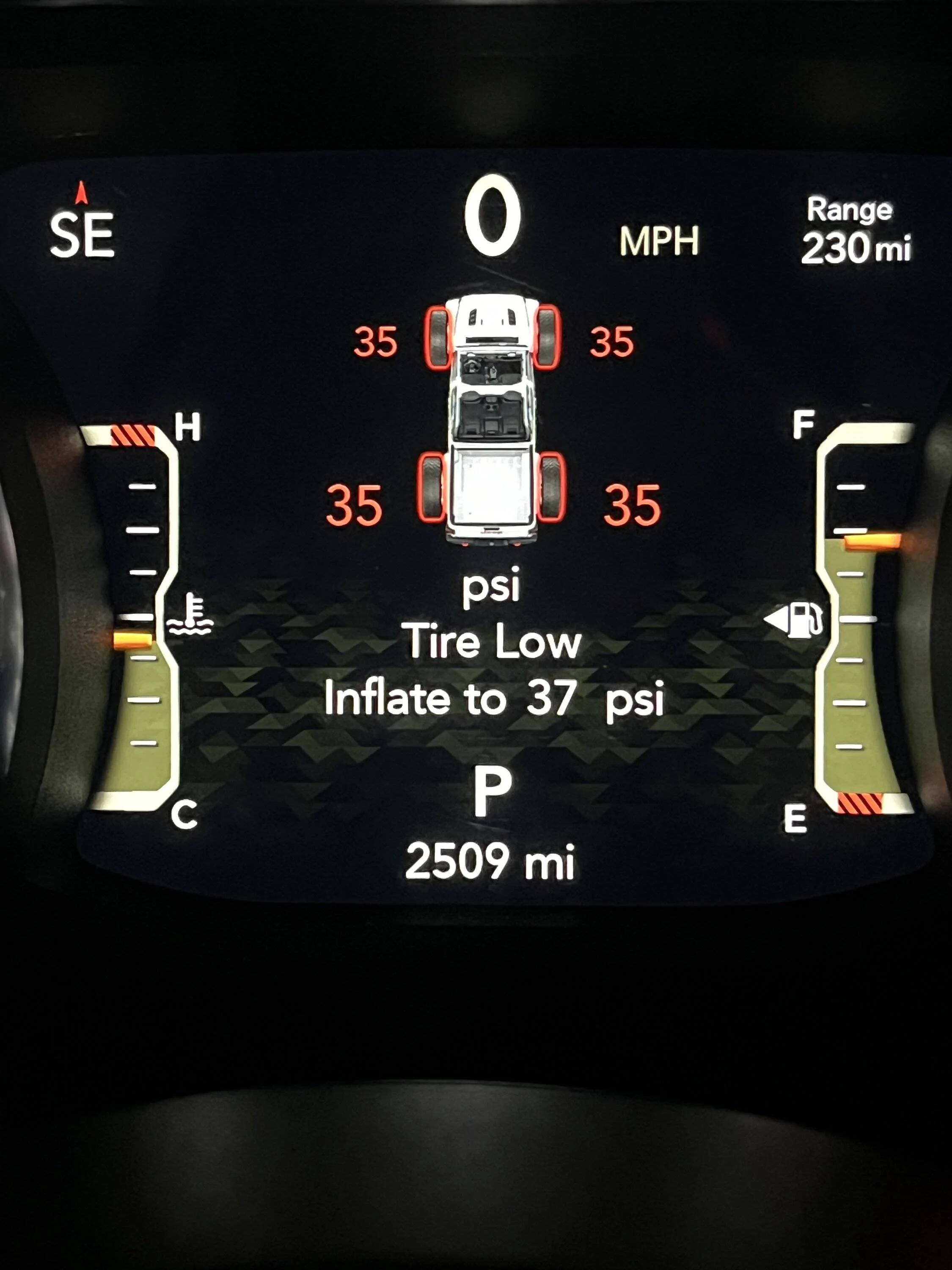

Thanks to all of you who replied. On the way home from work today (this started on the way to work) the sensors fluctuated between 35 and 36 PSI. Once they reached 36 PSI, the red outlines on the TPMS screen cleared and the (!) CEL cleared as well.
Anyway, Im going to inflate all the tires to 38 PSI cold and hope it holds. We shall see I guess…
What I do when I set my tire pressure is I set them at 37psi for what the average temp for the month is gonna be. So right now the temp is around 40 or so and the lows are gonna be 5-10 so I set mine to be 37 at around 20 or 25. That works for me and never any light.
Barely Krawlified
Oct 13, 2023
51
So. Cal
2023 JT Mojave - Punk’n Metallic
Umm, yeah I used CEL inappropriately by using it interchageably with the warning (!) light and corresponding icon. My apologies.
Anyway, I also own a 2019 JLUR since new and in about 40K miles I’ve had it as low as 32PSI without tripping the TPMS warning screen as depicted in my original post. As a result, I’m curious why I would get the warning on my JTM at 35 PSI.
Also, to be clear, the TPMS readings never reached 37 psi on my drive home yesterday. Despite this, near the end of my drive home (I had the TPMS screen active in my center display as depicted in my original post during the entire drive home) the red outlines around the tires cleared one by one with the PSI still reading 35 on some tires and 36 on the others. Also, the instant the last tire to display the red outline was cleared, the (!) warning light cleared as well.
Also, no warning light or TPMS red outlines were displayed today. PSI flucuated between 35-36 PSI on all 4 wheels.
