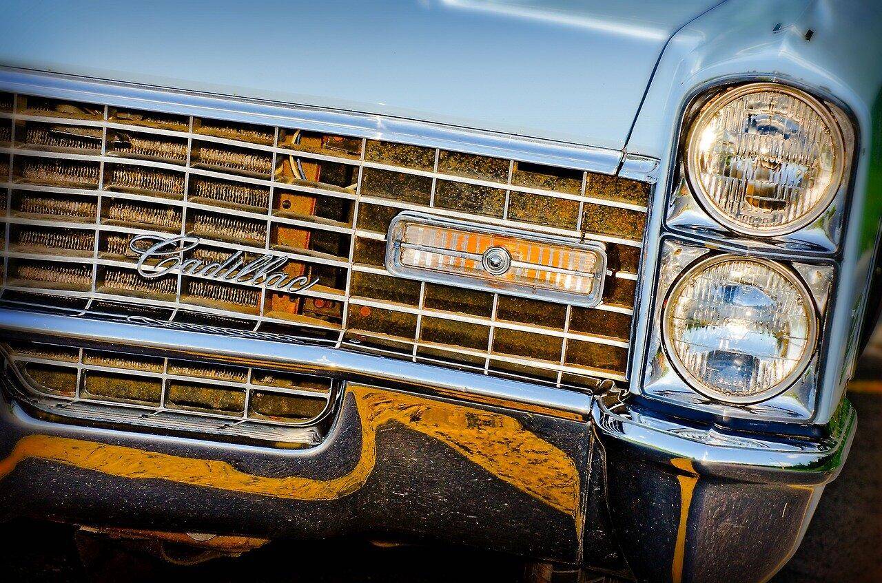

Traditionally the low beams are on top so they can shine down and high beams are on the bottom to shine out. In side-by-side configurations the outside light is low and the inside is high.
Some of us old farts remember the days of DOT standardized sealed beam lights.
Jeep Gladiator Sunpie LED headlights upside down 1748400796644-23
Even on later lights with combination hallogen bulbs, the upper part of the light would illuminate for low beams and the whole light would illuminate for high.
