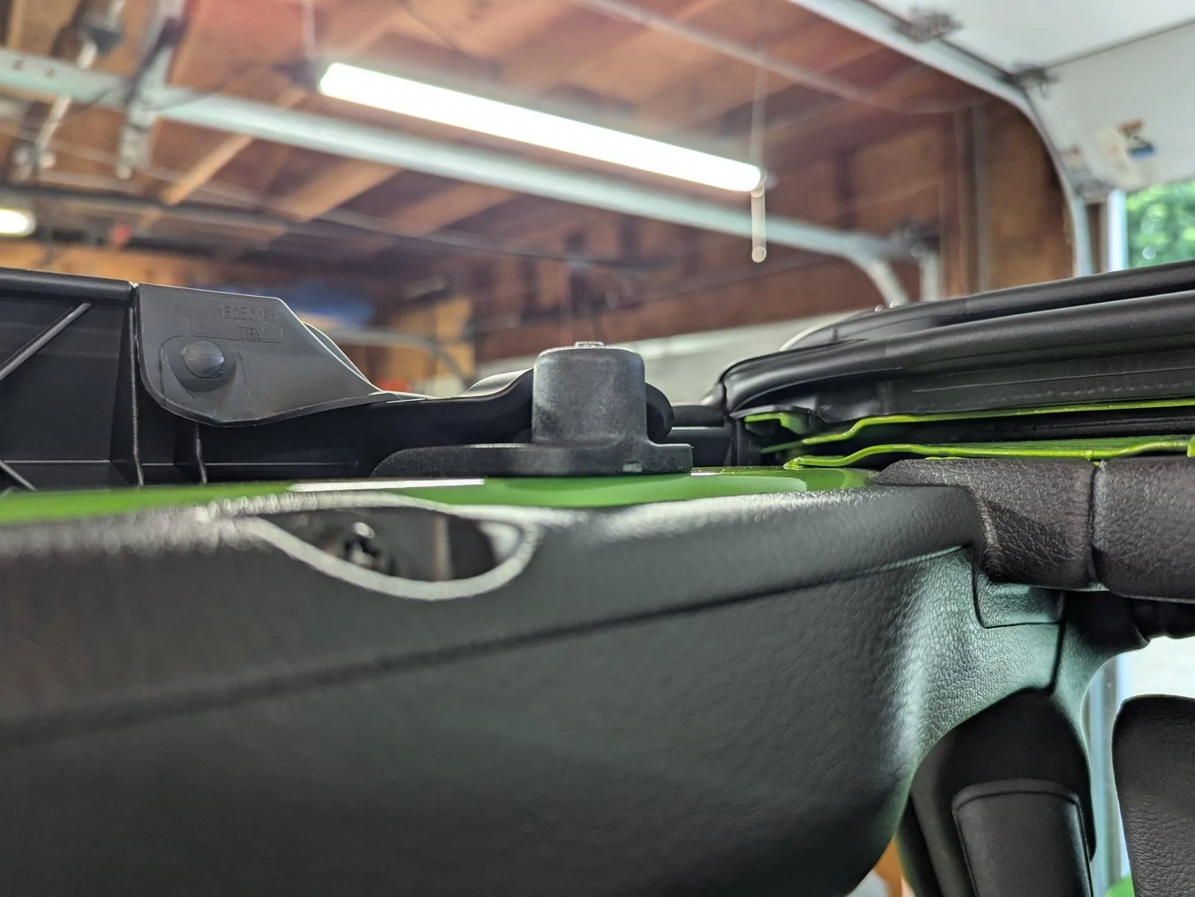

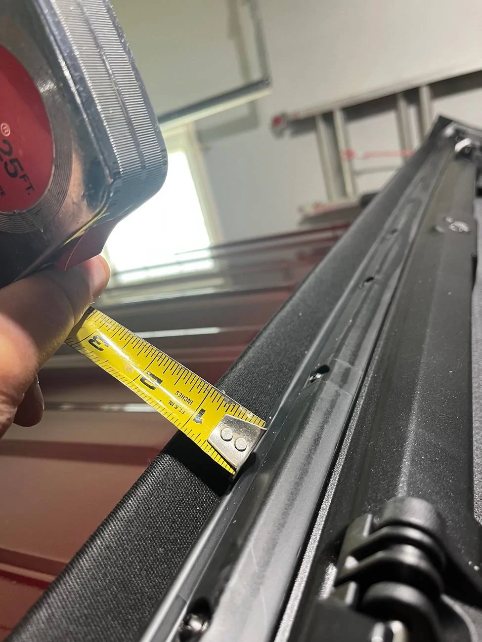

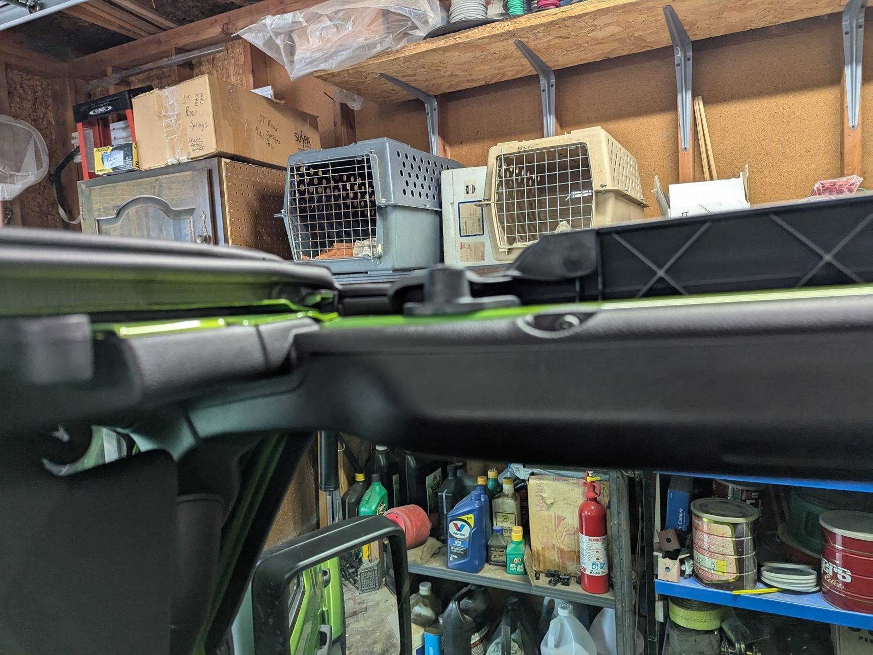

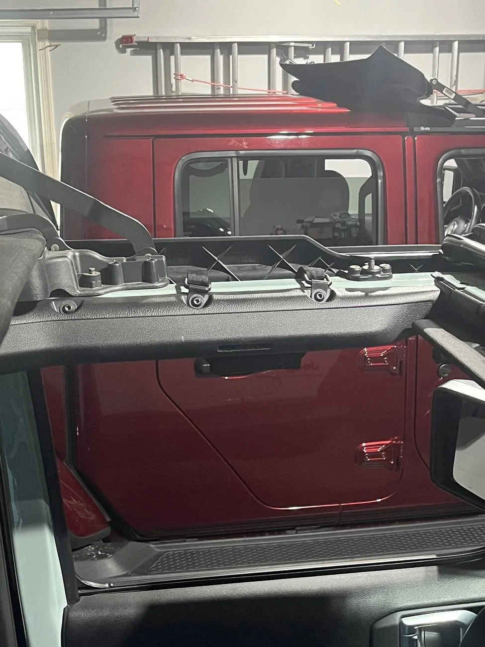

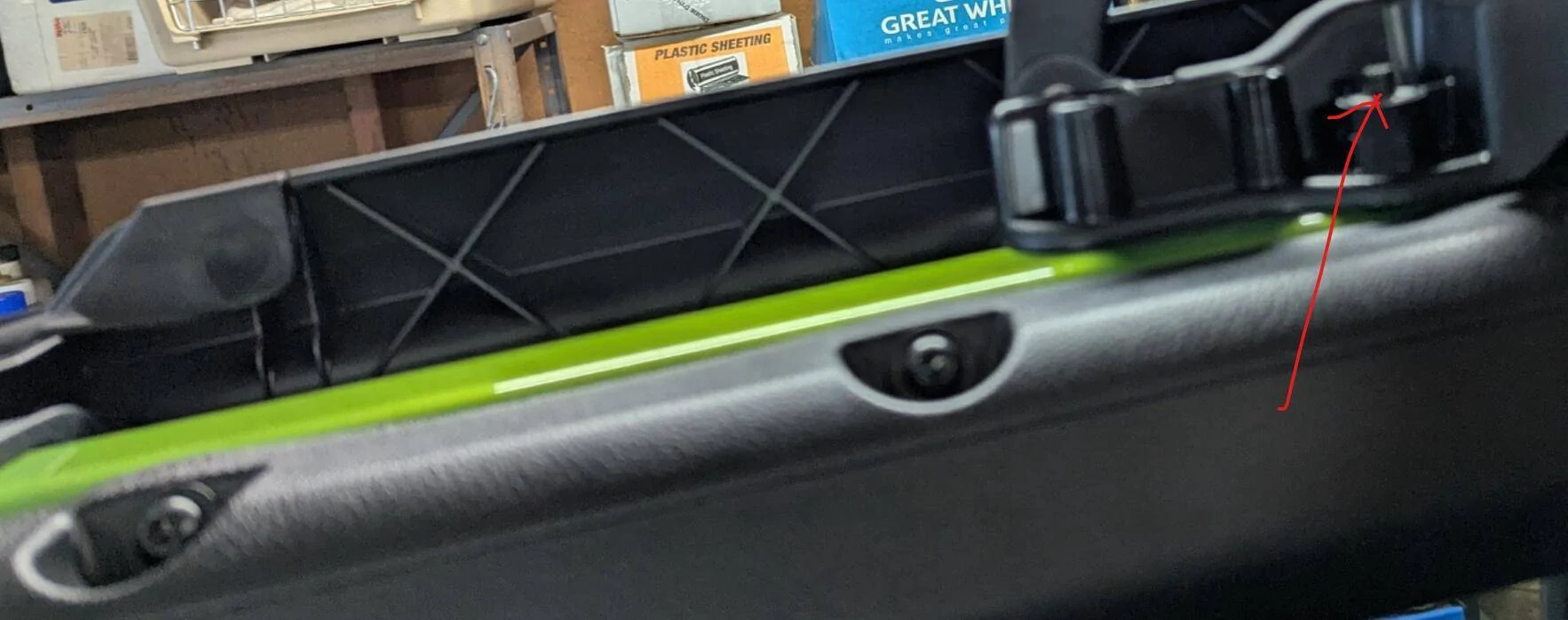

Left side rail, front attachment point, sits on the jeep's structure. there's no adjusting ->
Jeep Gladiator Sunrider owners - MY mess-up, or theirs? PXL_20250608_192153200

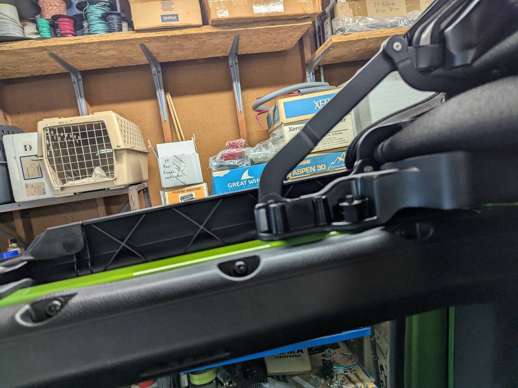

Left side rear attachment, again, it sits on the Jeep's structure. There's no adjusting. And, you can see how the sunrider rail goes downward as it runs to the front of the Jeep.
Jeep Gladiator Sunrider owners - MY mess-up, or theirs? PXL_20250608_192159990
Jeep Gladiator Sunrider owners - MY mess-up, or theirs? PXL_20250608_192207994

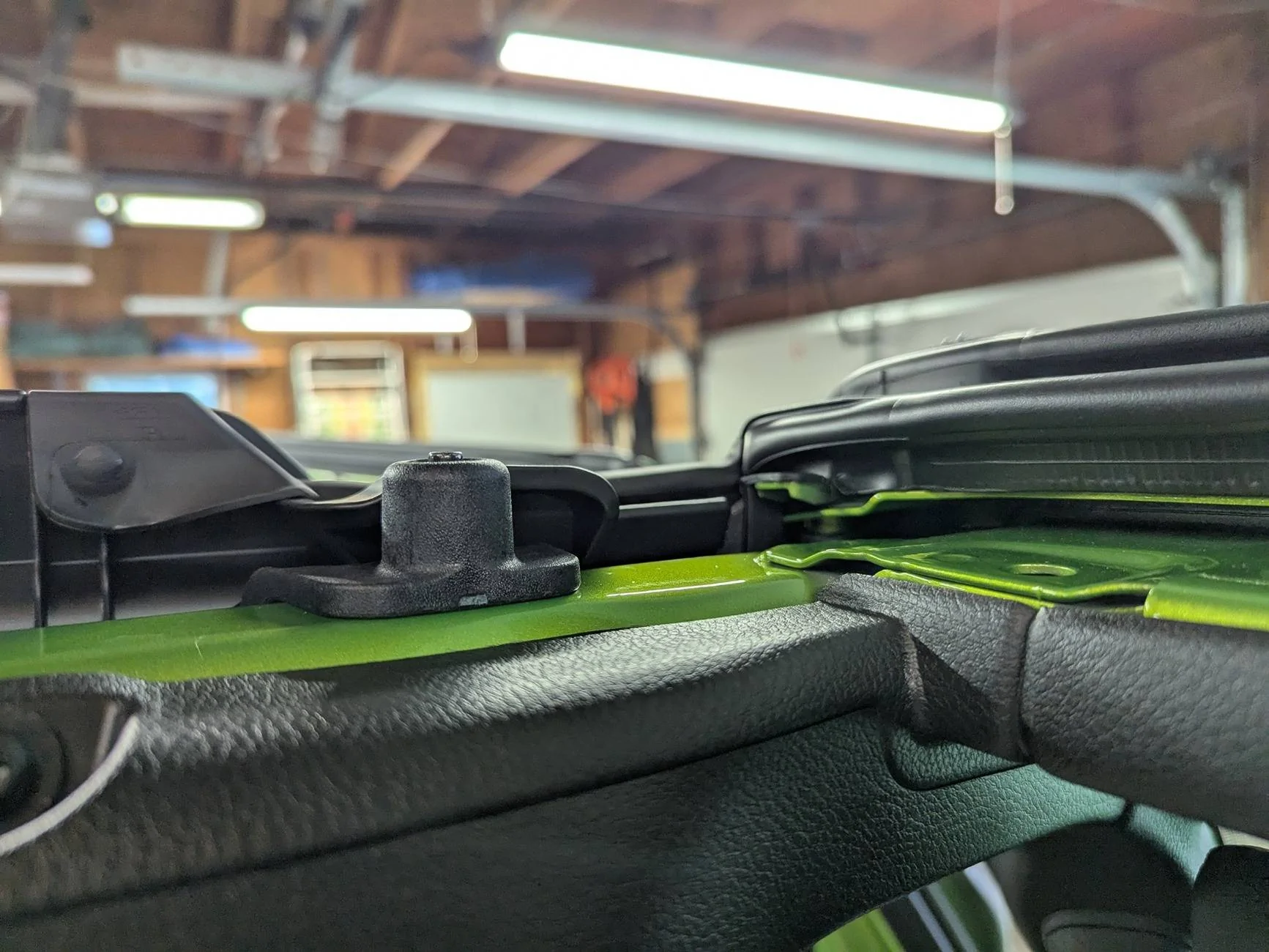

Right side front - sits flat on the Jeep's structure -
Jeep Gladiator Sunrider owners - MY mess-up, or theirs? PXL_20250608_192215320
Right side rear attachment - you can see the end of the bolt sticking up through.
You can also see how the sunrider actually sits LOWER on the jeep as it goes forward - this pic shows that perfectly - so it's likely NOT the Jeep.
Jeep Gladiator Sunrider owners - MY mess-up, or theirs? 1749413563648-i0
Look at hos the side rail of the sunrider appears to go downward as it goes forward (to the left in the pic0
Jeep Gladiator Sunrider owners - MY mess-up, or theirs? PXL_20250608_192219174

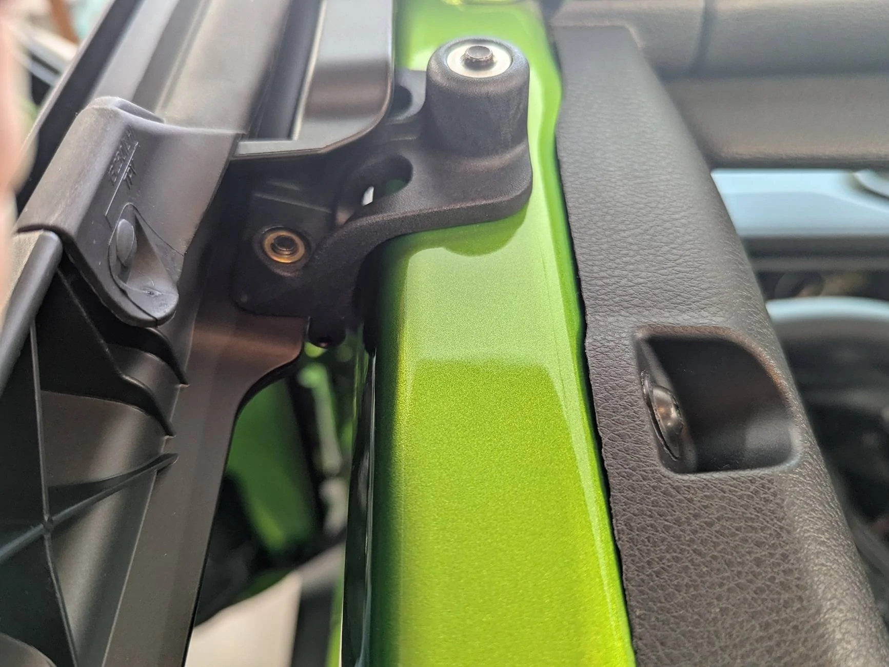

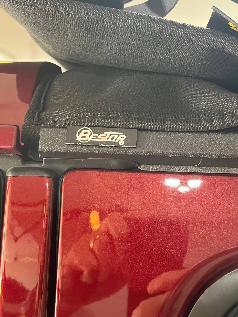

So…something looks very different on your “Sunrider” as opposed to the Jeep’s rails.

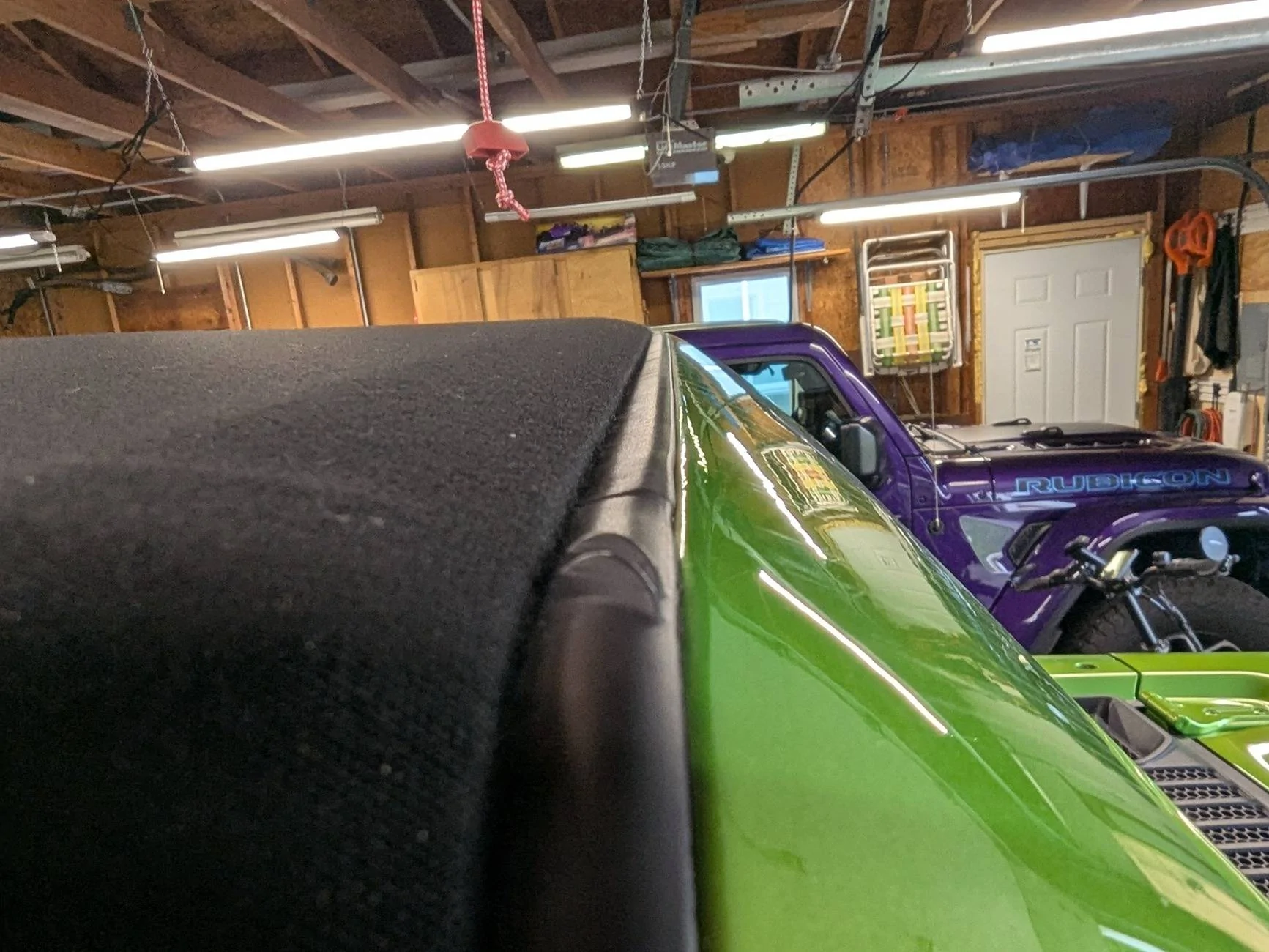

I went out and tried to replicate your photos on both of my Jeeps, on the left (drivers) side:

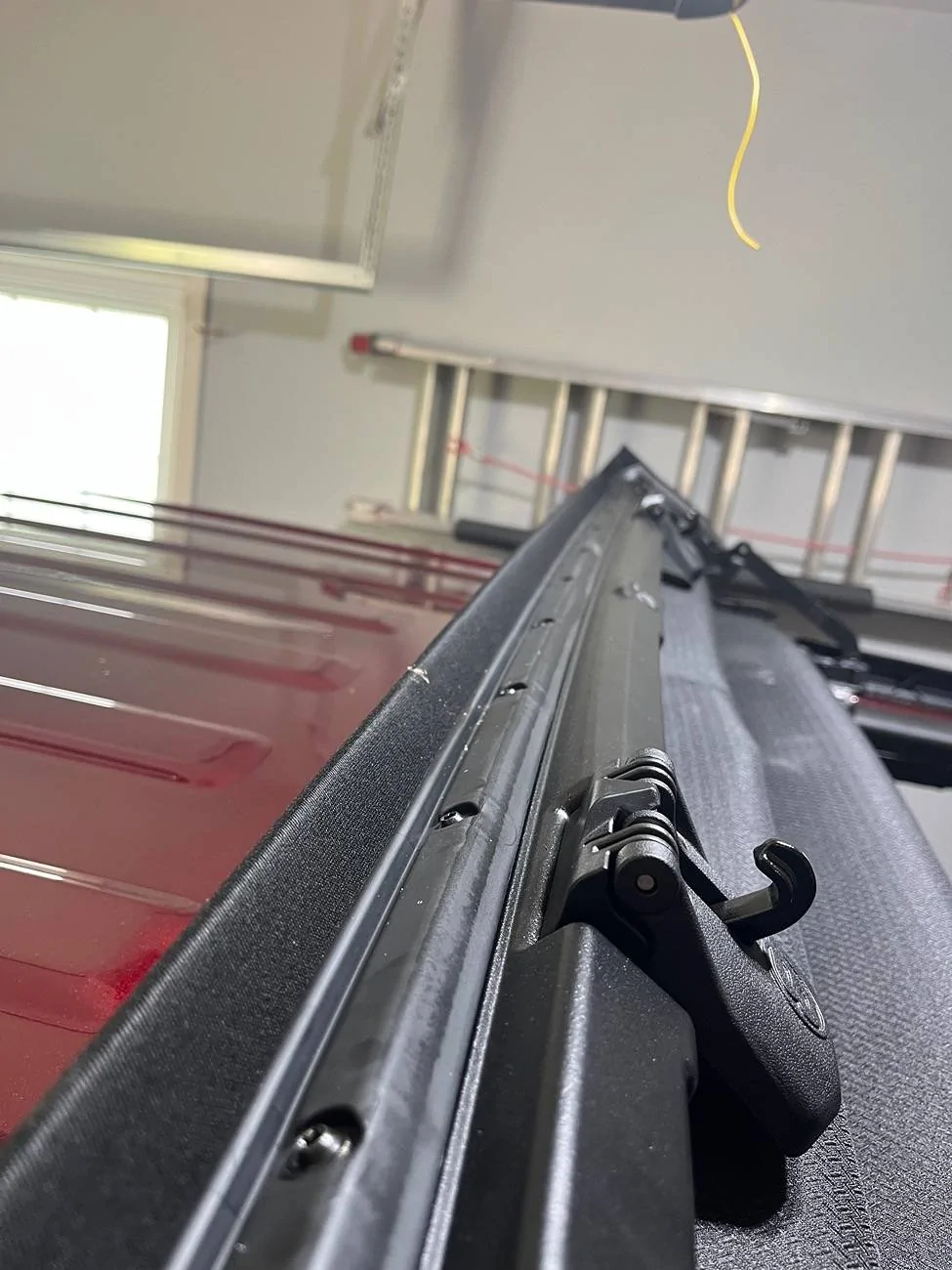

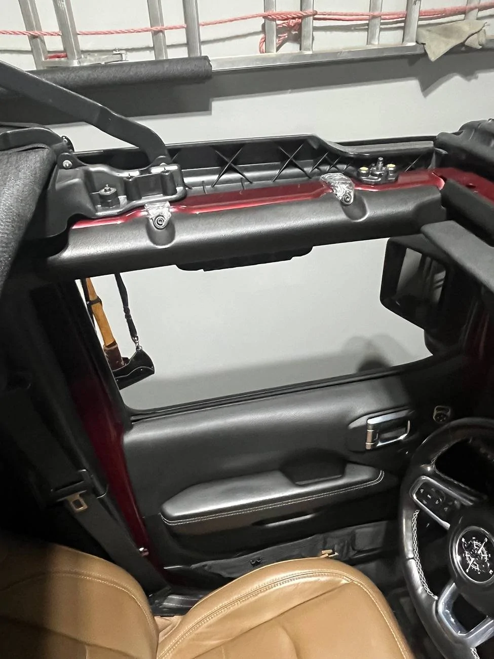

‘24 Sunrider on a ‘21 Gladiator:
Jeep Gladiator Sunrider owners - MY mess-up, or theirs? IMG_2228
‘21 Sunrider on a ‘24 Wrangler:
Jeep Gladiator Sunrider owners - MY mess-up, or theirs? IMG_2226
To me, both the ‘21 and ‘24 Sunrider look the same…but different from your Sunrider.
I also noted that you have. “Jeep” label on your “Sunrider”. Mine says “Bestop”.
Really looks to me like your top is different.

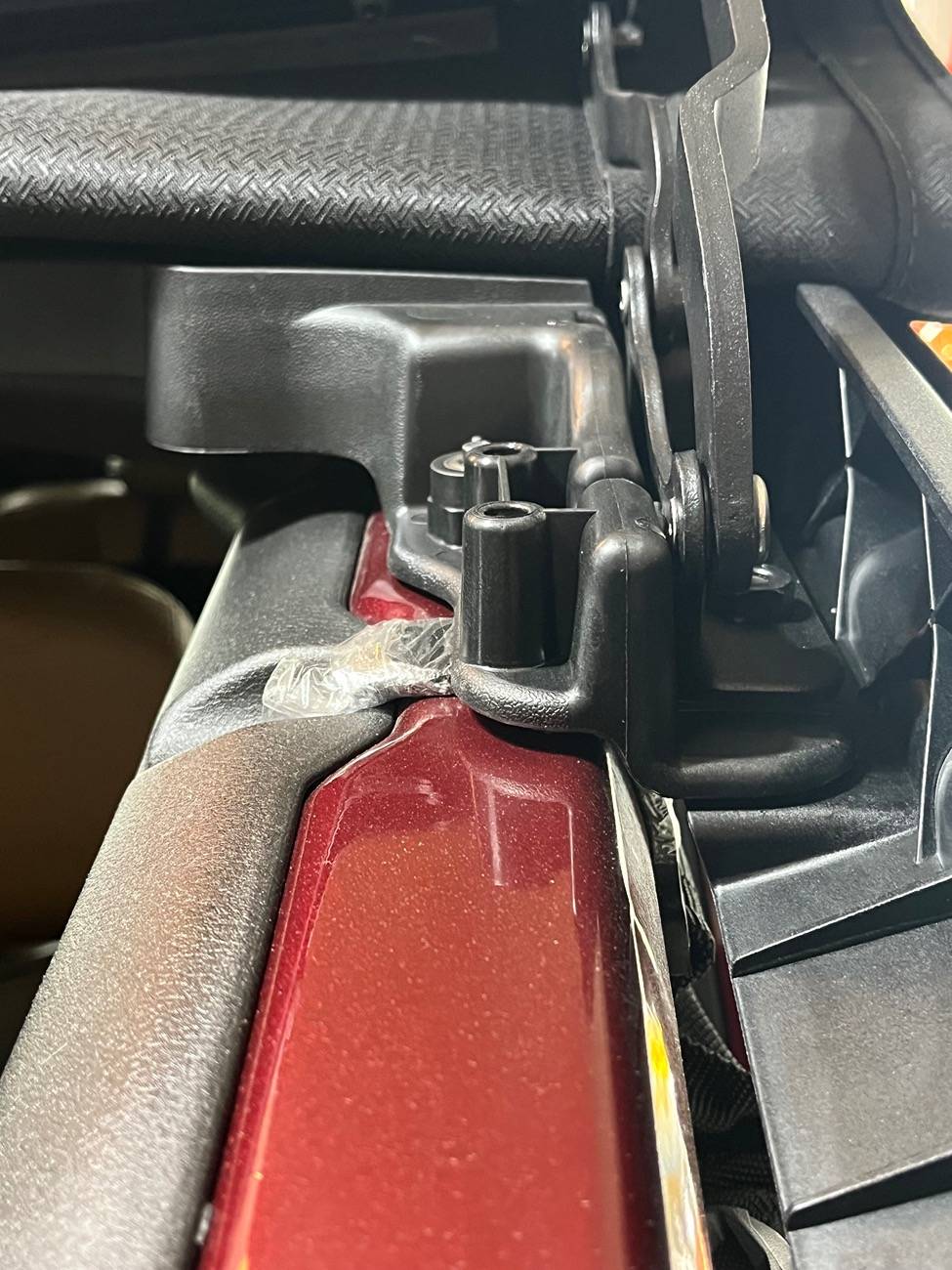

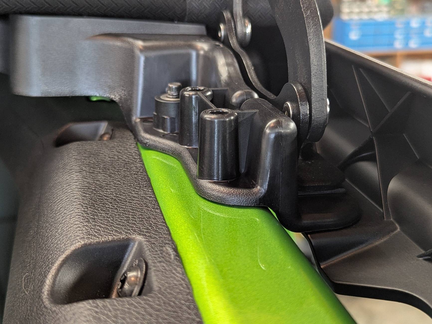

Shadow’s Papa: Note that forward attachment point is significantly different than both of mine.
40,504
54,031
Wow, they aren't' even close. I see other differences, too!

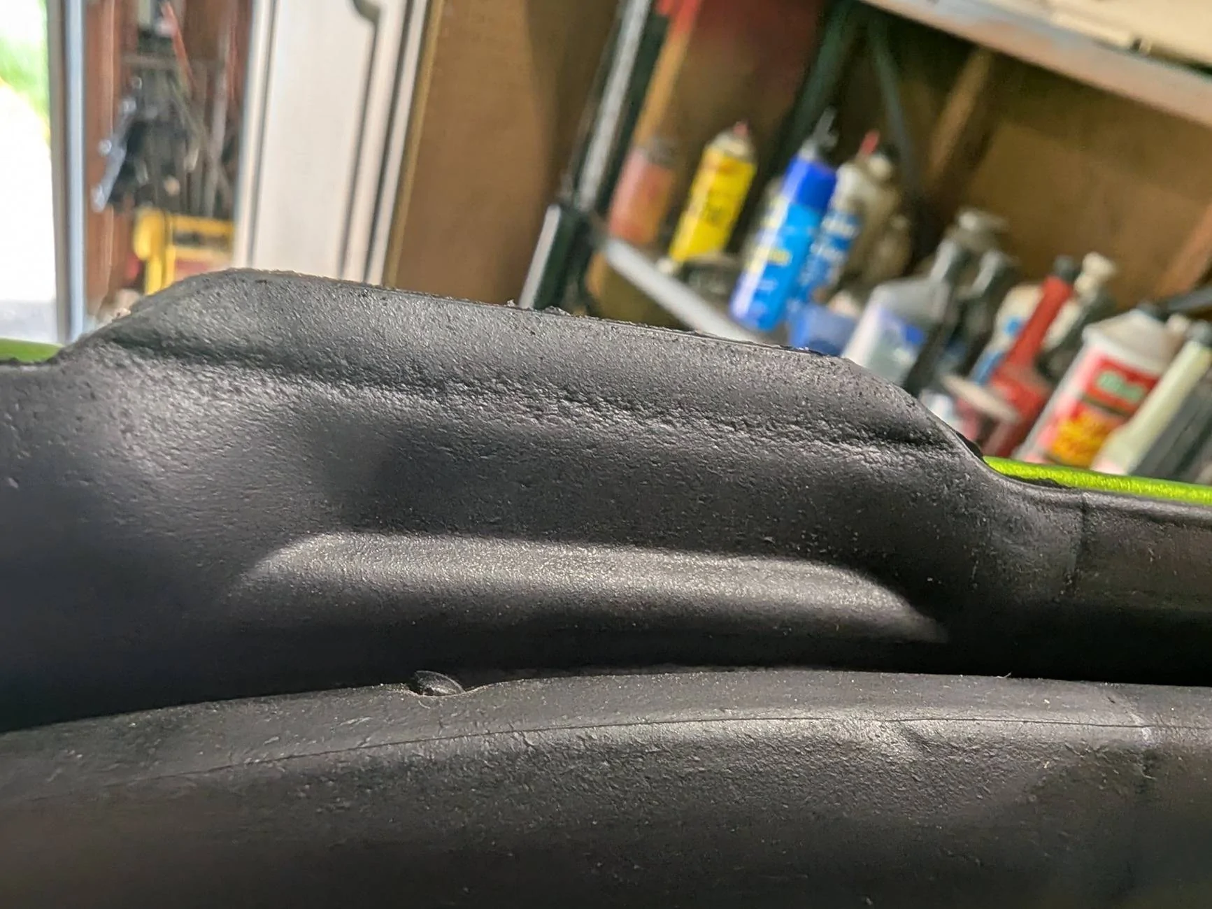

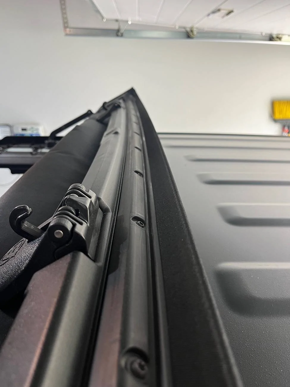

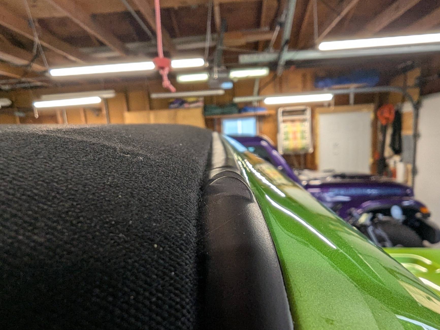

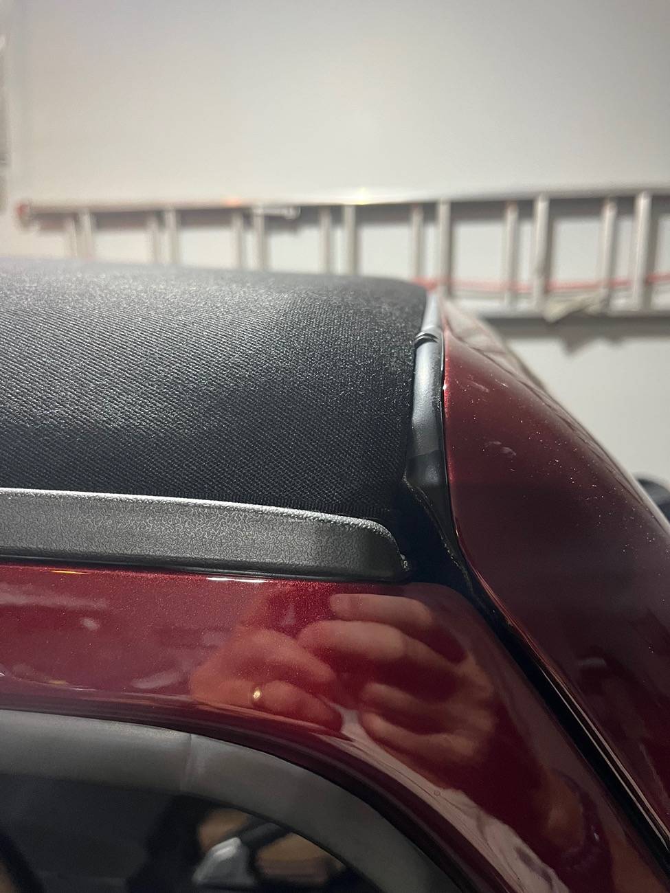

I wonder how "deep" or "low" the front sits on other sunriders compared to mine - I mean at the windshield frame seal..........
Jeep Gladiator Sunrider owners - MY mess-up, or theirs? PXL_20250609_213759253
Jeep Gladiator Sunrider owners - MY mess-up, or theirs? PXL_20250609_213753027

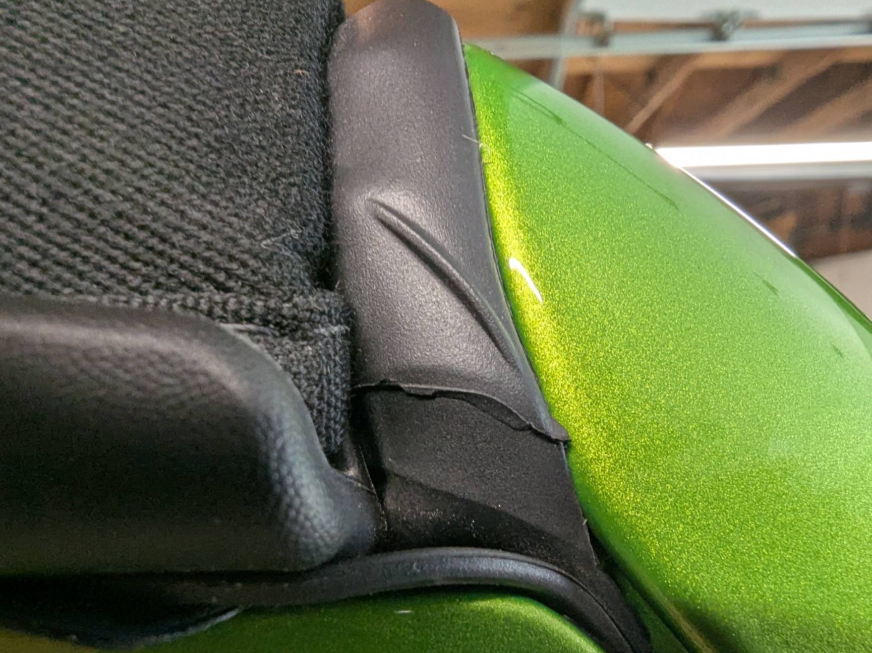

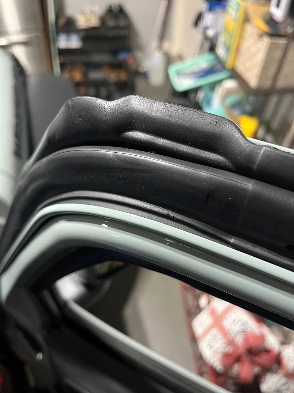

The rubbing and cutting action is getting worse - almost all the way across the top on the right now. It's even happening on the left side.
Jeep Gladiator Sunrider owners - MY mess-up, or theirs? PXL_20250609_212934147.NIGHT
Tons of photos - and from what I can tell, the sunrider where it attaches to the sunrider's own mounting points make it sit too low. I can pull down and push up on it and change how it sits.
Jeep Gladiator Sunrider owners - MY mess-up, or theirs? PXL_20250609_211517385
Jeep Gladiator Sunrider owners - MY mess-up, or theirs? PXL_20250609_211241836

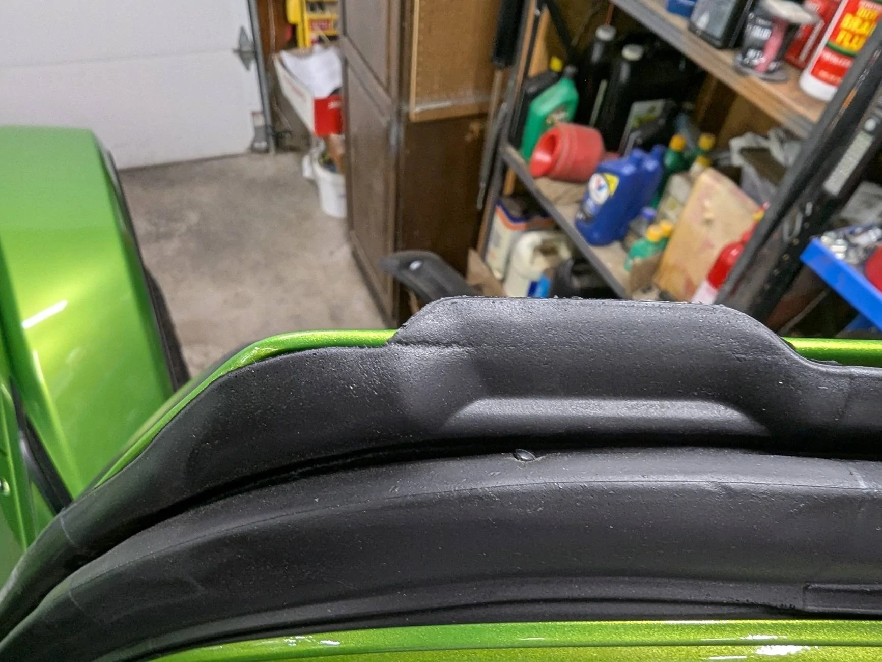

Comparing the wear in the door seal from 9 days ago vs. today.
(It's even cutting into the left one more than before)
Now try to say there's no problem Bestop............
Jeep Gladiator Sunrider owners - MY mess-up, or theirs? PXL_20250602_151859051

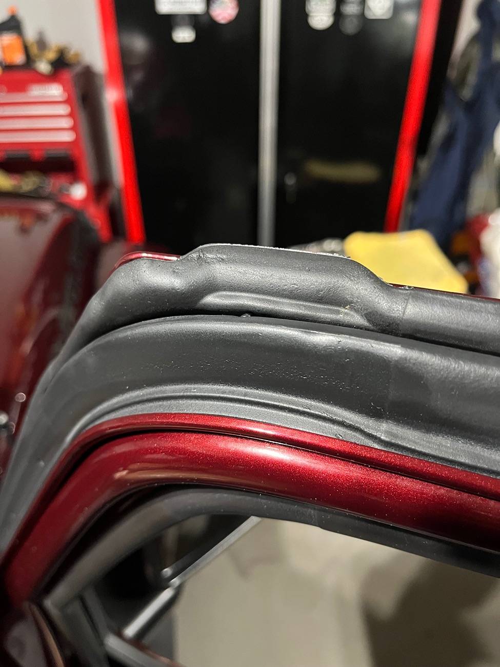

For comparison:
Same seal on '21 JT after four years of Sunrider:
Jeep Gladiator Sunrider owners - MY mess-up, or theirs? IMG_2231
''24 JL after 18 months of Sunrider:
Jeep Gladiator Sunrider owners - MY mess-up, or theirs? IMG_2230

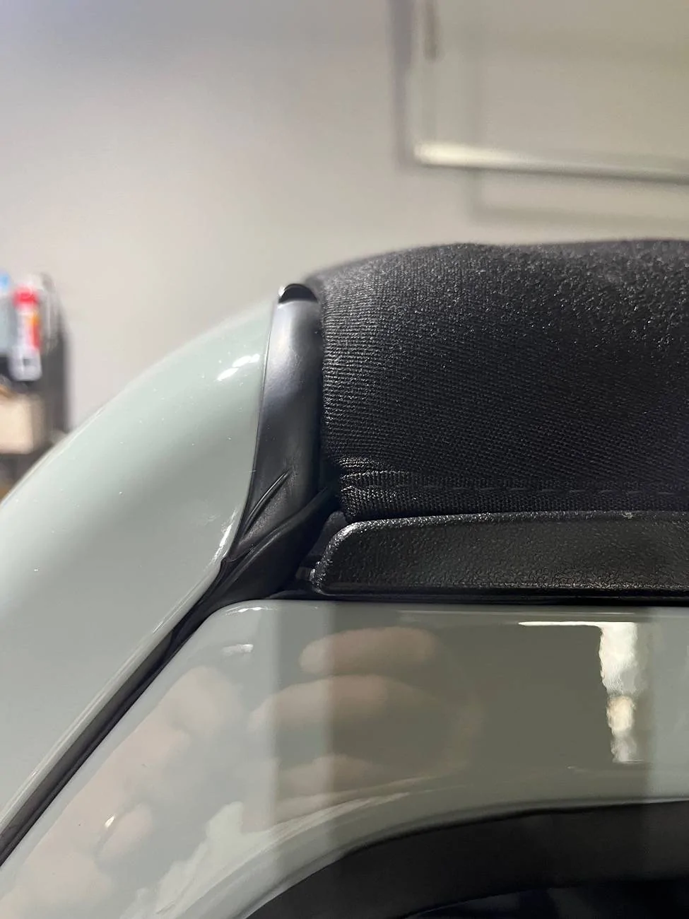

Tried to replicate your photos in your post:
Windshield frame:
This where I see a big difference from your's
Jeep Gladiator Sunrider owners - MY mess-up, or theirs? IMG_2239
The front edge of the Sunrider sits on that windscreen frame seal. It's the same with my JL as well:
Jeep Gladiator Sunrider owners - MY mess-up, or theirs? IMG_2242
In your picture, the Sunrider sits further back...looks like it falls behind the seal, instead of over it, so it rides lower.

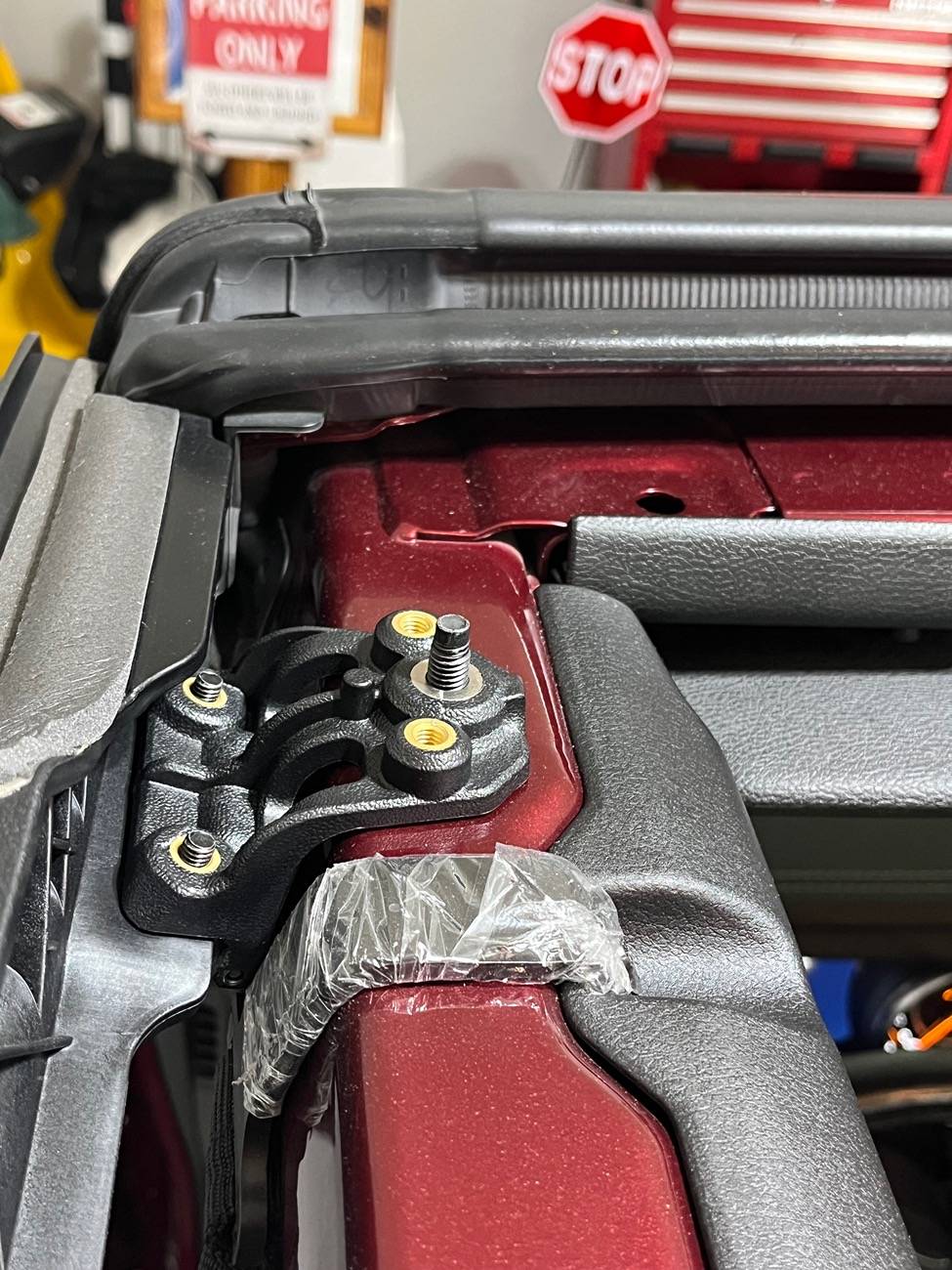

Front attachment point...looks way different than yours: (disregard the straps for the grab handles that run just aft of the attachment point)
Jeep Gladiator Sunrider owners - MY mess-up, or theirs? IMG_2236
and the aft mounting point - this one doesn't look too much different from yours:
Jeep Gladiator Sunrider owners - MY mess-up, or theirs? IMG_2237

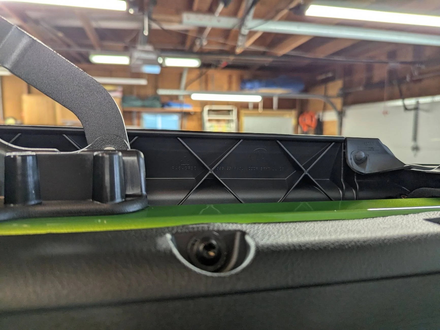

This might be the biggest difference:
Jeep Gladiator Sunrider owners - MY mess-up, or theirs? IMG_2238

Another interesting view/photo would be to see how wide the leading edge is where your Sunrider is supposed to overlap the windscreen frame seal. These are photos of both of mine:
They are ordering another sunrider and letting me pick up my truck this afternoon. I'll do more comparing when I get it back. They ran out of ideas (no shock there)
Windshield frame:
Where I have a "Bestop" label....I think I saw on one of your earlier photos "Jeep". Was yours made by Bestop for Jeep....did Jeep give Bestop different specs for their Jeep labeled product...is it really made by Bestop, or a knockoff that Jeep had produced somewhere else?
My two Sundriders - one purchased in 2021, the other in 2024, appear to be identical, other than a change made by Bestop that replaced the Z clips on the earlier model, with a screw attachment. And as I've said before, the '21 Sunrider fits perfect on the "24 JL, and the '24 Sunrider fits fine on the '21 JT.
Our mounting points are very different. Getting the truck back soon, will do more comparing to your pics.
