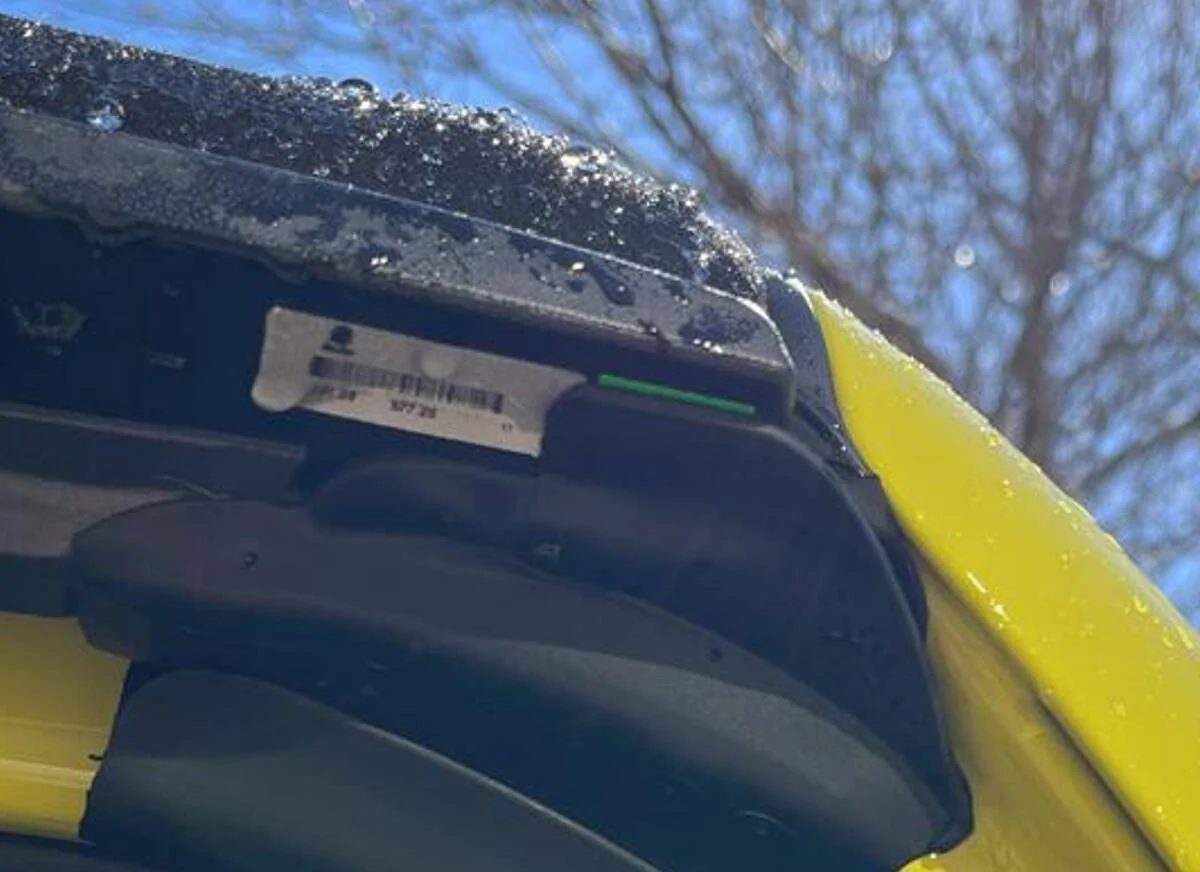

Jeep Gladiator Sunrider owners - MY mess-up, or theirs? IMG_2181
Oh....and also....when I went flap down, the flap was getting crushed by the door.

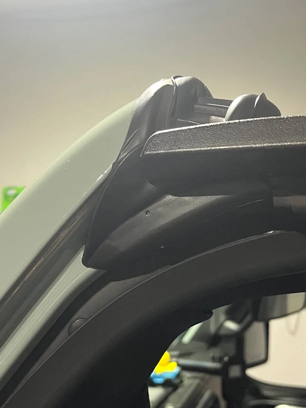

This is how they SHOULD fit - also notice the whole front is a lot higher than mine sits! The whole thing across the front of the windshield sits higher. Hmmmmm.
If mine fit like this, seals PERFECTLY lined up like with the freedom panels, no pushing at all, I'd be thrilled!
Bestop says Don't tuck the seal, no pushing down on the seal.
Jeep Gladiator Sunrider owners - MY mess-up, or theirs? 1749657353527-iu
(I wish a Bestop engineer was closer, I'd take my Jeep to them and ask them to take a look - I bet there's a lot more wrong with mine than just these seals - as another member pointed out, mine even sits wrong across the windshield header seal)

I don't have a '25 so I am unable to confirm gaskets, but I was thinking about the first time I installed mine. It was tight. It has loosened up a little bit with use.
Your one picture across the top of the windshield did make it look like the top was coming up short.
I would try loosening all of the hardware and try resetting it.
Possibly your top just needed to stretch a little.

The "rear bow" is all but gone on mine.
As far as fit - I tried moving it a bit and it either sat worse in the gaskets or the bolts wouldn't then go in.
The dealership had a couple of guys working with it for over 2 hours (I really do feel for them - hope they get paid for this) and tried several things and were also unable to get it to fit even just "better" and gave up. It's not really funny, but it sort of is - they spent all of that time and didn't get anywhere, in a selfish way, made me feel a bit better - AHA, it's not just me! if you get my drift.
I didn't want to be William Shatner in that aircraft - the only one seeing the monster on the wing!
Yes, I'm picky as @#$% - and does make me feel better when I'm not the only one who can't make something fit correctly, sad as that may sound. I was glad they had trouble, but sorry that they now have to somehow find the issue and get PAID for it.
You aren't the only one who thought it didn't look quite right at the windshield header either. And it would make sense in a way, sitting too low at the front forces it down and behind that front seal, not on top of it.

posting this only to remind people of what that seal does, why it's there and how it came about - it came about because Jeep owners griped, Jeep listened, and Jeep fixed it with this seal and trough setup below.
But for some fun - picking on those who might have complained but then don't care if the sunrider interferes with the shape of this part of the seals.
I have a question for those who advocate tucking that seal up behind the sunrider rail........
Actually, for anyone who has a 2021 (I think that's the year) or earlier Gladiator or even JLU and has ever complained about opening the door to get out and getting rain dumped on your leg or into the floor of the Jeep.
Raise your hand if you have ever complained about your earlier JLU or JT dumping water on you or into the truck as you open the door to either get in or out of the Jeep.
( I could spend some time and find you - who you are - because a lot of folks here complained about the fact that when you opened a front door, you got water dumped on the floor, or on your or a passenger. It was a big topic and some came up with some stick-on solutions, and so on)
If you are one of those people who complained about the rain dumping on you, your wife, or into the floor of the Jeep and you are also saying "tuck that seal, it serves no purpose" or "it doesn't lean, so doesn't matter" - you are contradicting yourself.
Did you know that due to the many, numerous complaints, Jeep actually DID something about it? And they issued a sort of TSB for it - if you complained while it was under warranty, they replaced your windshield header seal and other parts under warranty! Free! You got the upgrade that came along on 22 and later model years.
That piece people are tucking up is what diverts water into a special trough to prevent rain from dumping on you or getting onto the seats or the floor when you opened the door after or during a rain!
Water comes off the front end of the drip rail, is diverted by that seal you want to tuck, and into the plastic channel added for the 22 model year - maybe it was 2021?
(Does anyone here have the TSB for this??)
This is a 2023 and you can see exactly how rain water would behave -
Jeep Gladiator Sunrider owners - MY mess-up, or theirs? PXL_20250602_151201725
I had the TSB for the water fix and went to the dealership to see a 2022 model Gladiator to see what was different, how it looked, so I could show people here what it was and how it worked back in that year - this is new for 2022 model year. (really wish I could find that TSB!)
It catches rain water off the drip rail and diverts it into the plastic channel away from you, your leg and the inside of the Jeep.
Jeep Gladiator Sunrider owners - MY mess-up, or theirs? 20220405_101459
But tuck that thing and you have just undone what Jeep did to satisfy people who were complaining about getting wet, or water dumping INSIDE the vehicle or onto your leg.
See? Water flowing forward in the drip rail will drop off the end and into the Jeep or onto you just like the 2020 and 2020 models or all years of the JL did before Jeep's mod to FIX the water dumping issue.
Jeep Gladiator Sunrider owners - MY mess-up, or theirs? PXL_20250609_211202098
So I guess I just refreshed my memory, don't know why I didn't think of all of this days and days ago because I KNEW IT, I knew what it was for - but it didn't come to me until now.
With a correctly fitting sunrider, this works exactly as Jeep intended and keeps you and your interior DRY when you open the door.
When it doesn't fit - it defeats the purpose of the TSB fix (and crushes and destroys other seals)
So those who say "who cares, don't need it anyway" - think back- did you own a JL or JT model year 2021 or prior? Did you complain about getting wet or the floor or seat getting wet when you opened the door?
