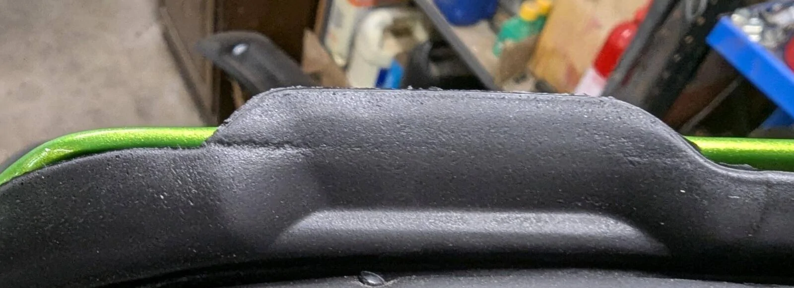

I have a dealership appointment Tuesday.
There isn't any way that seal can sit properly - the sunrider simply sits way too low at the front on my truck at the front, and plenty high at the back. It slopes down badly front to back.
Others picture an even gap between sunrider rails and the top of the door.
Mine slopes heavily downward as it goes forward.
(Even the guys who looked at it at the dealership while I was asking them advice were confused as to how low it sat at the front)
It's cutting away at the right door seal.......... The underside of the sunrider rail is like a rasp, or a course file. Nothing smooth about it and it rubs/crushes this part of the door seal.
These were smooth before the sunrider went on, the front is almost cut through now

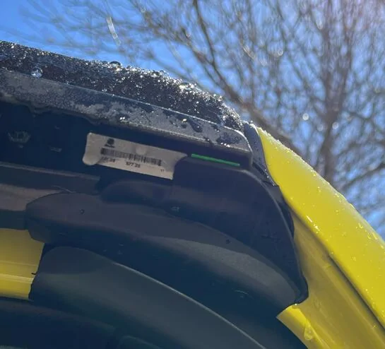

The gap between sunrider and top of the door should be EVEN, front to back, back to front. The gap should be exactly as it is with the freedom panels in place, nice and even.
The mucket/seal should sit exactly as it does with the freedom panels in place - so if you open your door with the freedom panels ON, that's how things should look with the sunrider in place.
And for many, it does - but for quite a few others, it's a bad fit.
This is correct -
Jeep Gladiator Sunrider owners - MY mess-up, or theirs? 1749221474503-jg

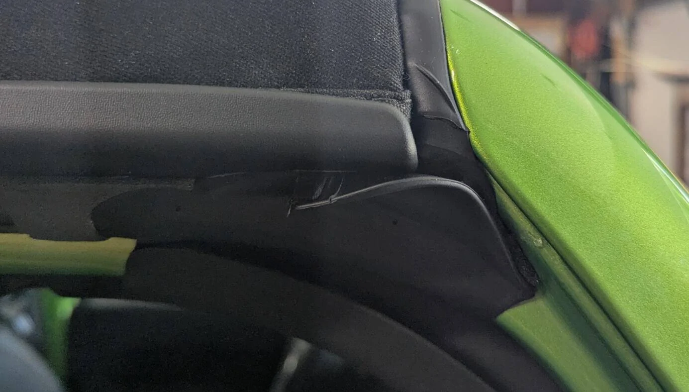

NO WAY IN HELL mine will ever fit that way! No way, and others have found the same in some cases.
Mine - Also look at theirs and see how high the whole front edge sits - mine just sits way too low even across the front at the top of the windshield. Compare theirs sitting proud of the windshield frame - mine sits down in, lower.

From what I can tell - Jeep has changed the seals/gaskets/mucket 2 times in the last 5 years. My 2020 was very different, then along comes a change in 2022 for rain dripping on you resolution, and my 25 looks different than my wife's 2023 does - so, maybe another change??
But the sunrider has not changed.
On the other hand - if MINE fit like the one pictured and what others have shown theirs to fit, I'd not have any issue with it.
The fact that the door gap disappears and that part of the seal is cut on mine - well, that's a sunrider fitment issue.
The door gap alone is a bold, in your face, indication there's a problem with it. That gap should be even and the sunrider should fit there like the freedom panels do.
Mine does not.
Since there's no adjustment - you set it on top of the Jeep's roll cage rails, insert the bolts, it's done. There's nothing to adjust.
Taking the bolts out, lifting and setting it down again does nothing because it's going to sit right back down on that Jeep framework!
