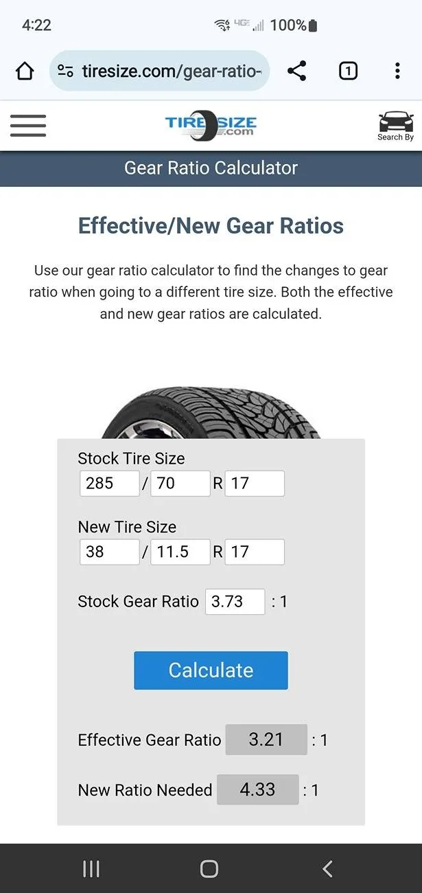

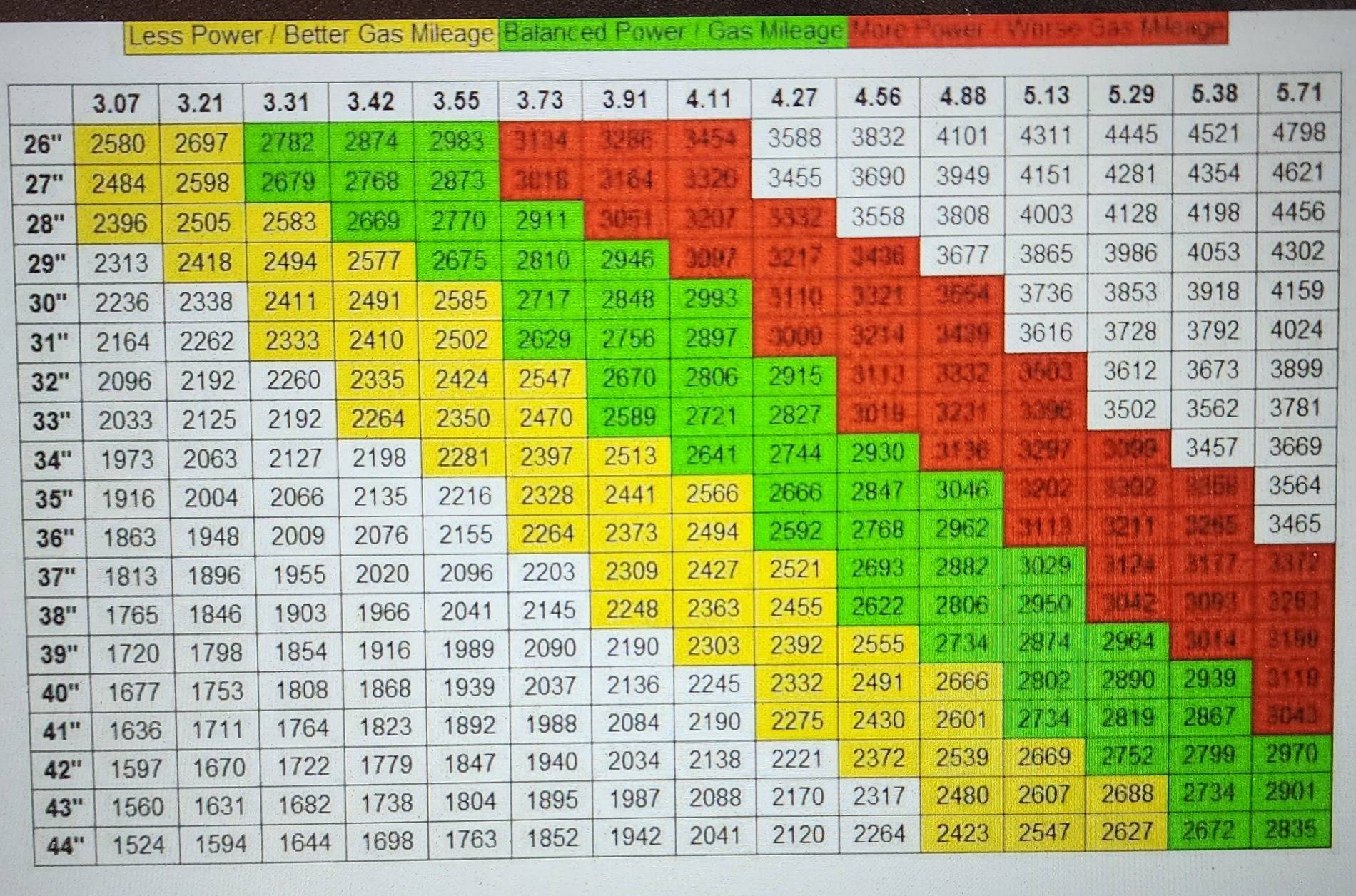

BTW, the current "effective ratio" is 3.30 and manageable but less than ideal under the conditions I drive in , the change from 3.73 to 4.10 returns to just under the oem power curve spec.
Just did a long session with ChatGPT / Open AI , after inputting all the oem and changed parameters , the resulting opinion is that it will be so close to oem spec the slight difference will be unnoticeable.

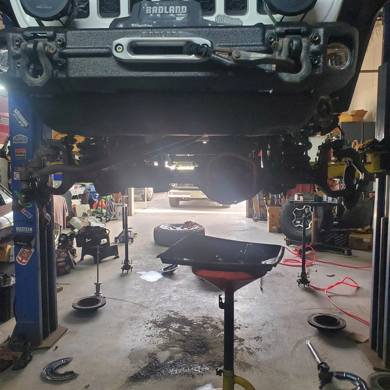

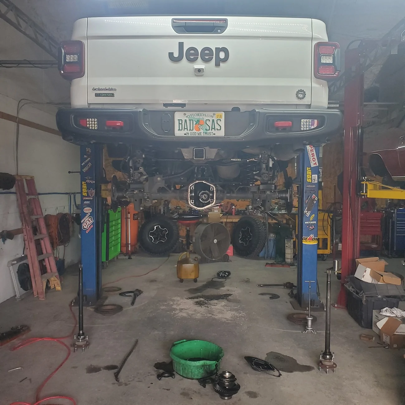

Had to wait for way too long and pay way too much to get the work done here locally but it was still cheaper than driving 1,200+ miles to Exodus 4x4.
Fortunately we have the Blessings of extra vehicles and enough disposable income.
It was a painful wallet suck but still not as bad as paying the tab at the fuel dock for free* fresh fish...
The performance shop here does a lot of differential setups but they had a hell of a time with the super tight clearances of the Advantek.
V-Link / J-Scan done and on my 2nd phase of the break-in
Can tell it's right back to oem drivability in the rpm / transmission shift points
