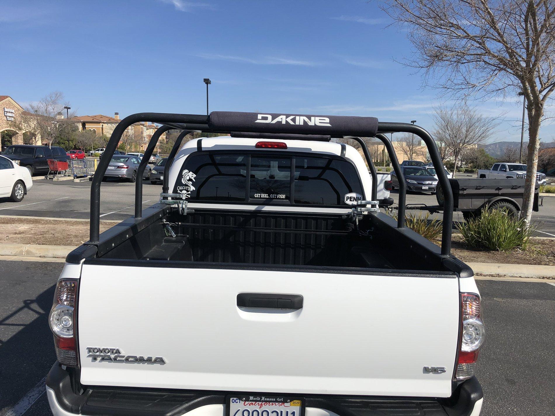

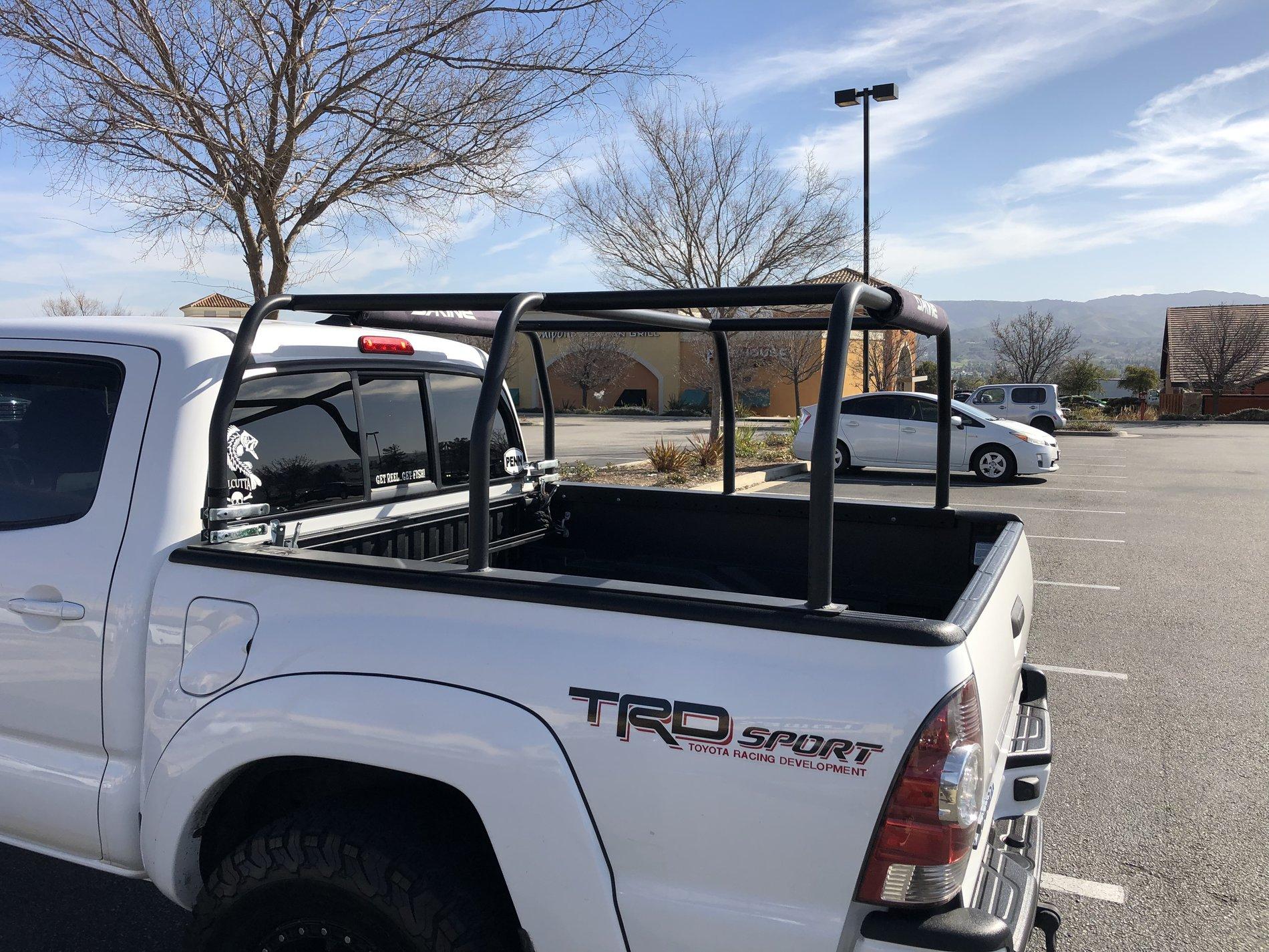

Just measured 2019 Tacoma bed. The measurements are very similar both in width and length. Given the numerous rack options available for Tacoma at a much lower price point than gladiator comparables I’m surprised that no one has tried fitting Tacoma racks on our truck. Tacoma’s bed width is about 63.5 inches with similar 3-3.5inch sidewall thickness and the short bed measures about 63 inches in length as well

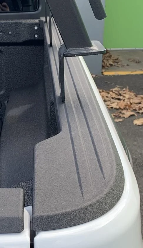

Close, but no dice on the RCI Tacoma rack. This is with the other side of the rack pushed firmly into the other bedside so that little bit the trail rails stick out will push it even further. Needs probably 3/4" to an inch to make it work for the width but then it also appears the Gladiator rails mount higher than the Tacoma relative to the top of the bedside - you'd need to grind out the holes to make it work on some racks.
