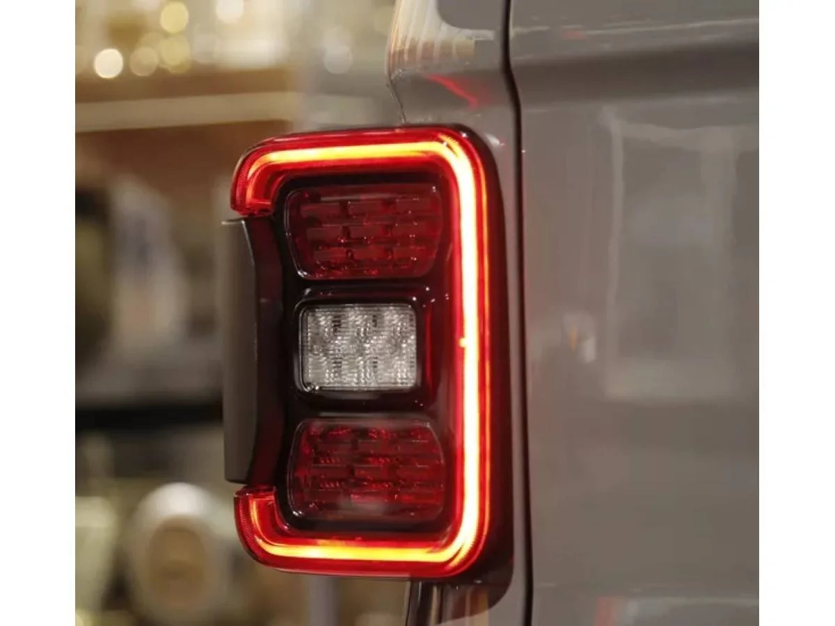

Jeep Gladiator Tail lights not working 68336583af-68336582af
This is how mine looks.

Reading this again, if the main brake LEDs are coming on dim when the trailers are connected, but go out when disconnected, then you’ve got a back feed issue with the trailer harness/connector.

Well now I feel like a fool. Yes that outer ring is all that lights on my tail light. Etrailer in ST Louis did the motorhome brakes and lights no charge, just tow master parts paid for. Tow master has a diode wiring kit and it is hooked up as per the Manuel. Connected to motorhome all the leds lite on headlights or brighter for brake blinkers. I just assumed the Jeep alone should have been the same. Well this was a wasted troubleshooting day.
