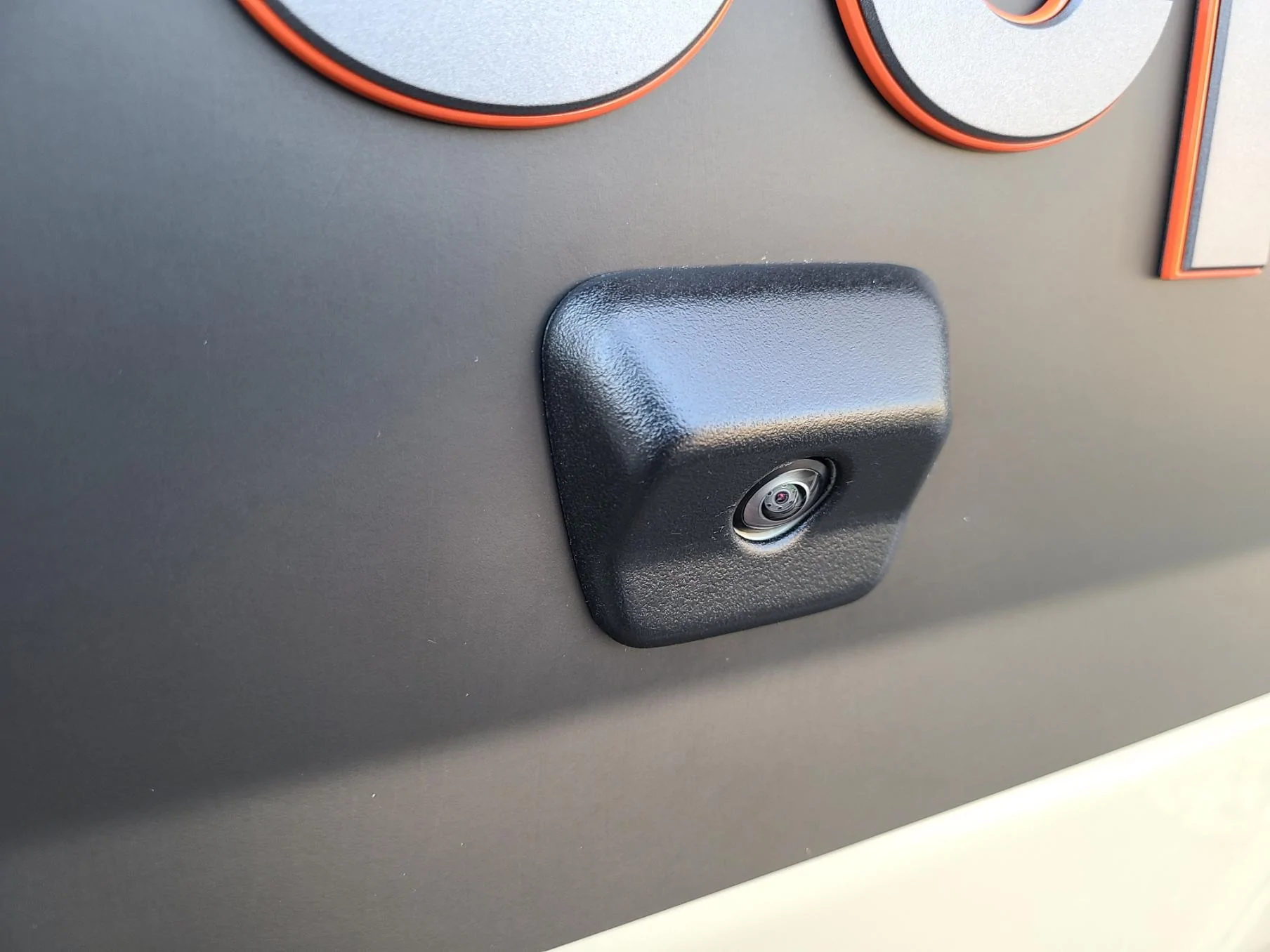

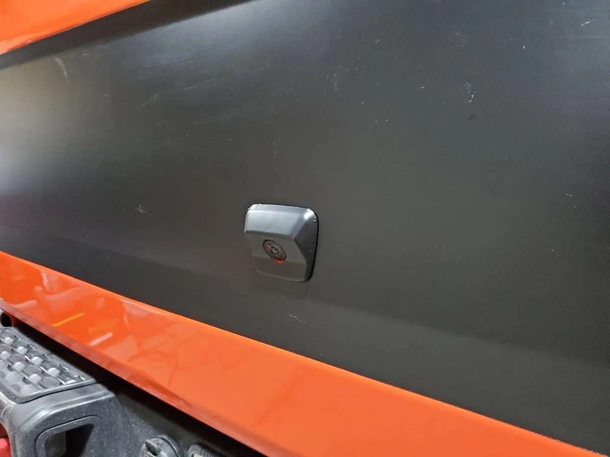

I wrapped my bezel with leftover vinyl, not the easiest. I was hoping to be able to separate the camera from the bezel and paint it, but it appears the camera body is some sort of rivet holding it to the bezel. I didn't want to push my luck at risk of breaking something and not being able to get it back together. Another option I looked at was ordering a new camera in black, way too expensive of an option IMO.
Looks pretty crappy up close, but not bad from far. Much better than an orange bezel over the blackout.

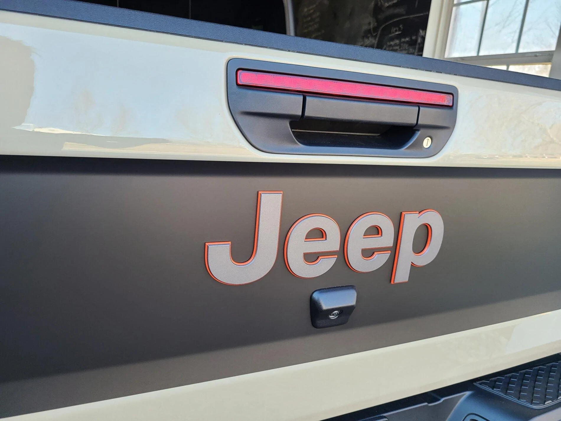

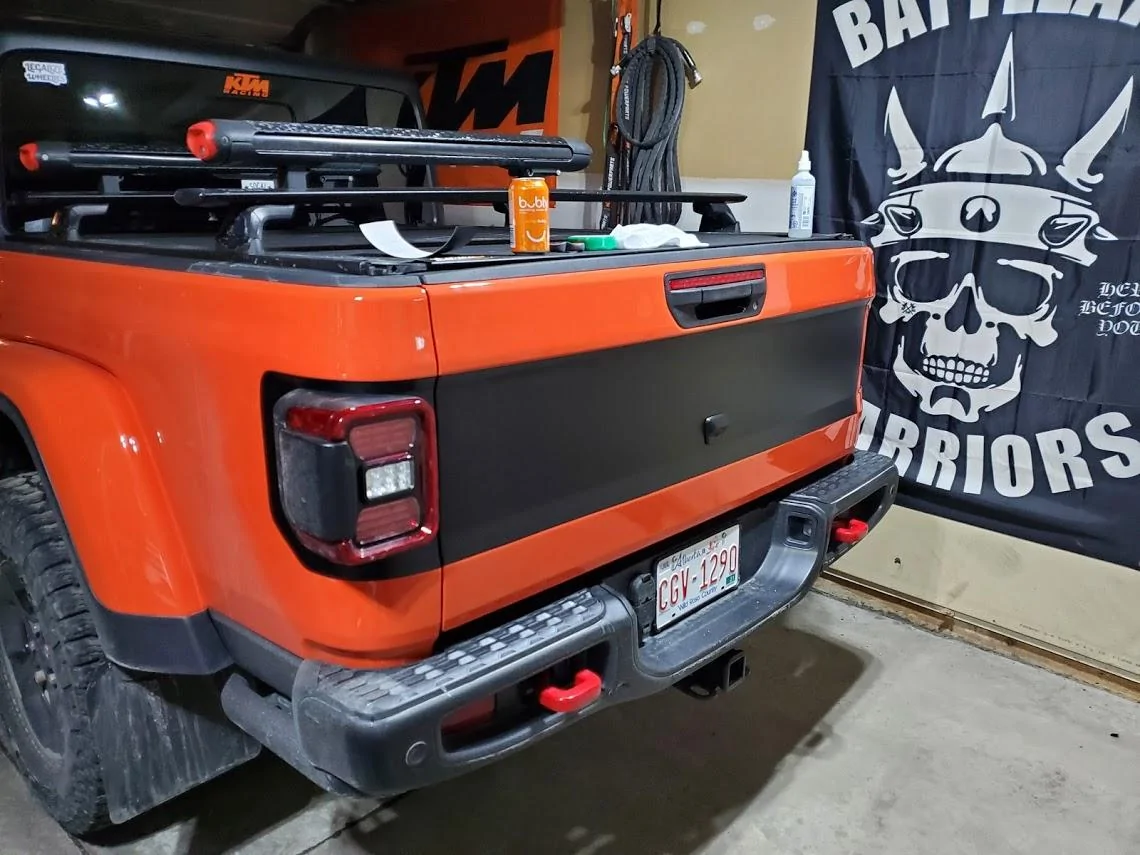

Wrapped the tailgate and put it back together. Absolutely happy with the result!
$20 for the camera bezel; hit it with 4 coats of plastic dip. Not a perfect match but I think it looks great and a lot easier than trying to wrap the camera. Will have to wait to see how well it holds up but so far so good!
