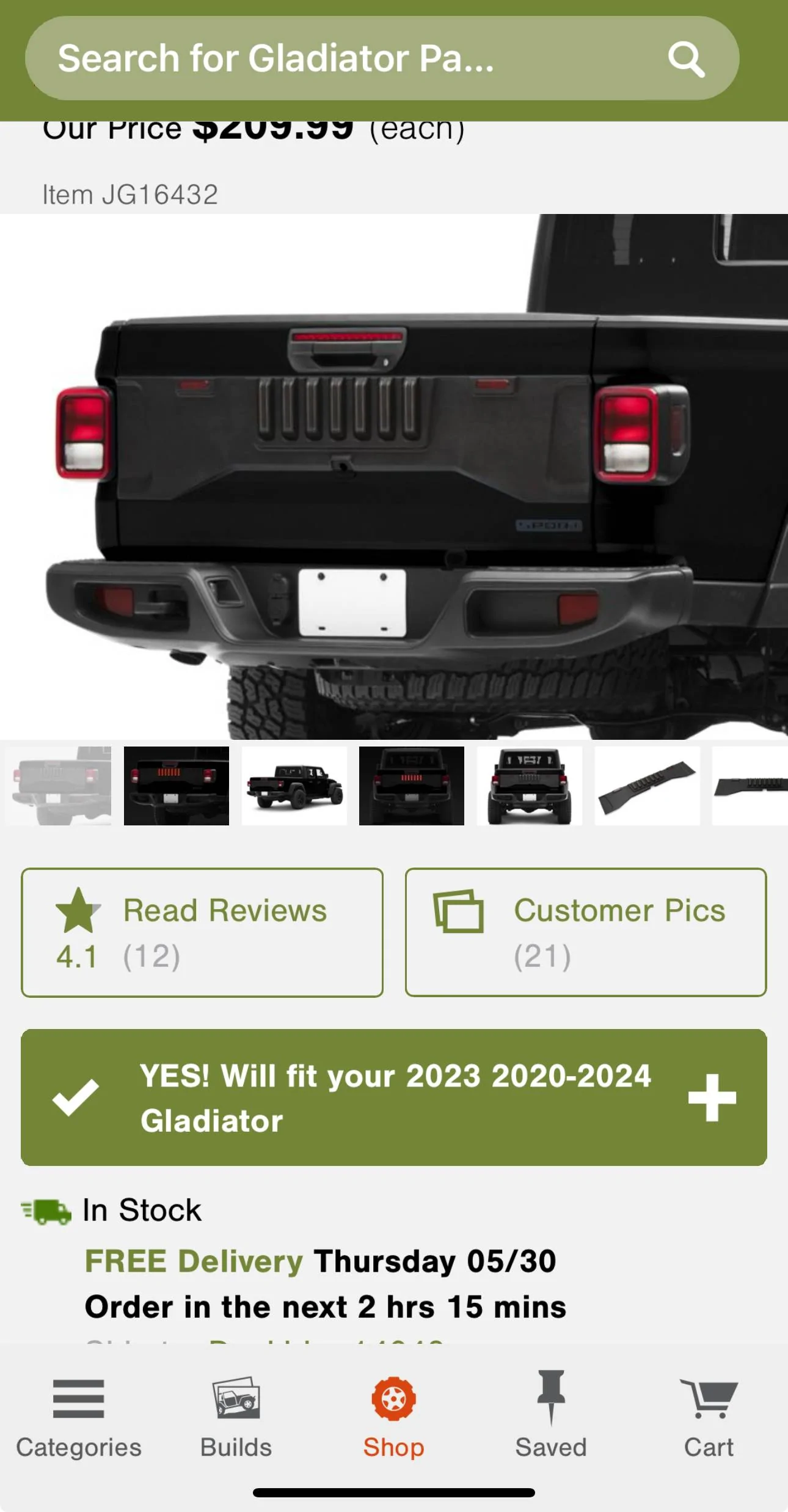

Need some advice on the brake light wiring above the tailgate handle.
I finally got the lighted tailgate cover from xt.
Jeep Gladiator Tailgate wiring? IMG_9666
I don’t want it to light with brakes, just be on when the lights are on.
Ive seen a few diagrams, not sure which wires are just power and marker lights vs brake lights.
I just want to use this akind of marker light. I don’t need it to illuminate when brakes are pressed.
