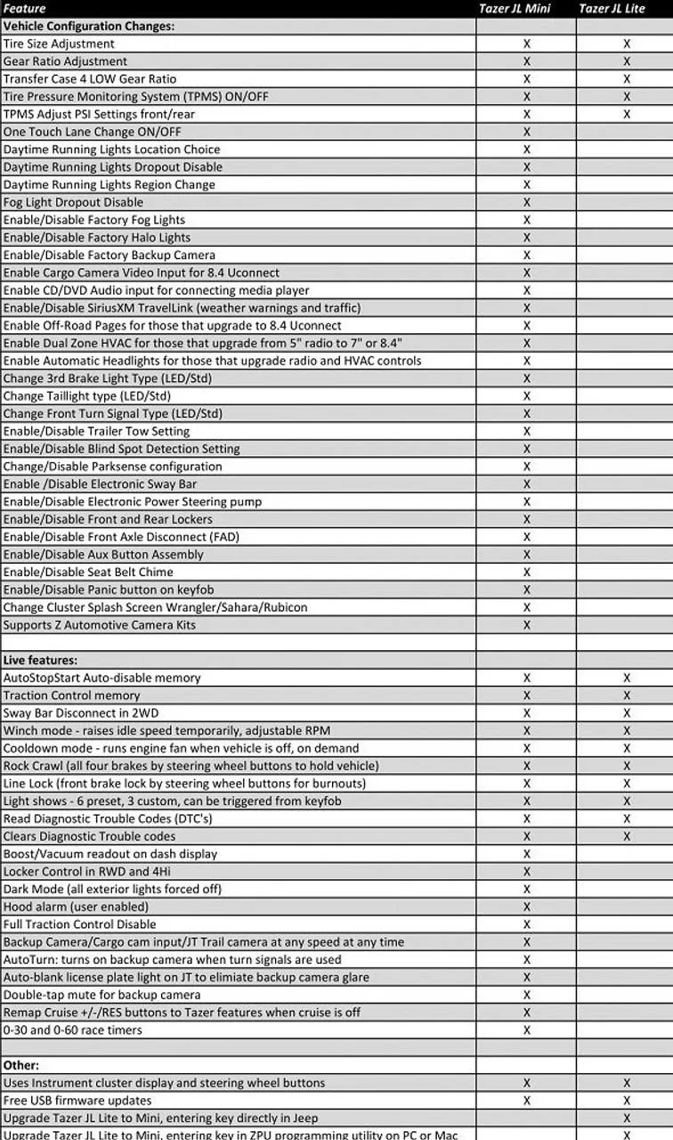

Just bought and installed this...iupdated to latest firmware and married to gladiator... im missing the options for radio and lighting ( possibly more idk those are what I was looking for) not sure what to do.. ihave gone through the menu in the run postion with and without engine on and still don't see them..I see winch, dark mode and a few others with ut on and the codes and clear codes with engine off

Did you end up with a Tazer Lite? Try doing the firmware update again. You may have to contact ZAutomotive Support and see if it's defective.

Yup... I looked at list of features on lite and that's what they sent me.. frustrating when I paid for mini

I believe the difference is just an access code, so should be a simple fix.

All fixed..text number for support and got my code for full features!!!
