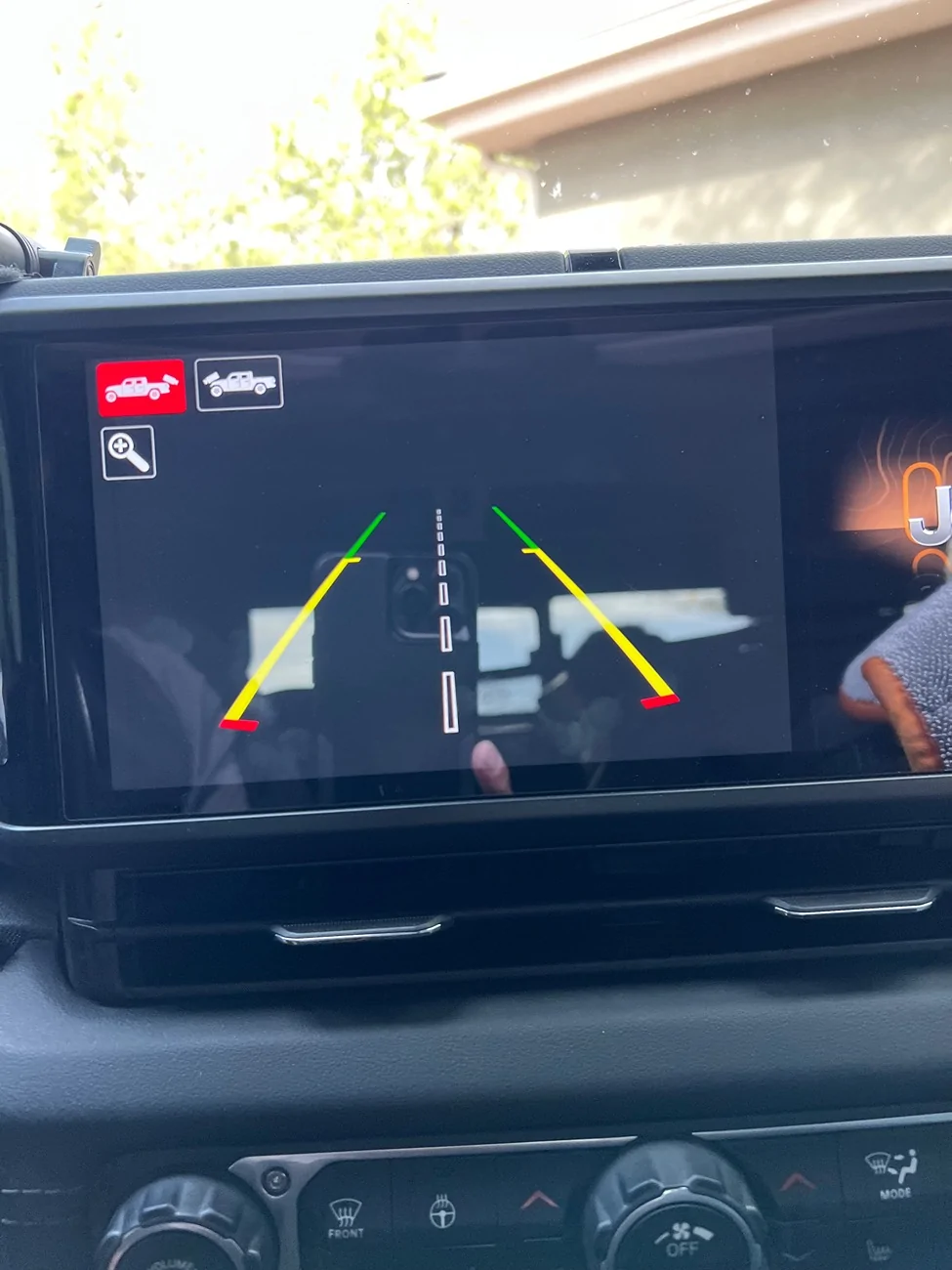

So I have been having issues with my backup camera for as long as I have had the Tazer. It would have a black screen with the steering lines. I would guess it was 20% of the time. I originally blamed on Jeep because well it's a Jeep. I've had the 3 Honk Kill revert back multiple times. Then on Thursday I took it in for fire recall inspection. They plug in their tool into OBD port when I arrived. 9 hours later they call and say Jeep checked ok. Whatever it shouldn't have taken more than 5 minutes. Anyway, I put it in reverse and camera is black. Then every time for 20 or 30 restarts it went black which had never happened. Then I get out and 3 Honk Kill is not working. I reboot it and 3 Honk Kill is working again. Guess what? So is the backup camera. It has worked every time since. So in my tiny brain, it has to be the Tazer. I need something that can fix my tpms and tire size. 3 Hink Kill is cool, but I rarely need it. Auto start/stop would be nice, but I can just press the button if needed. It will become a habit. I don't use any of the other features. Maybe a ProCal from AEV? Others?

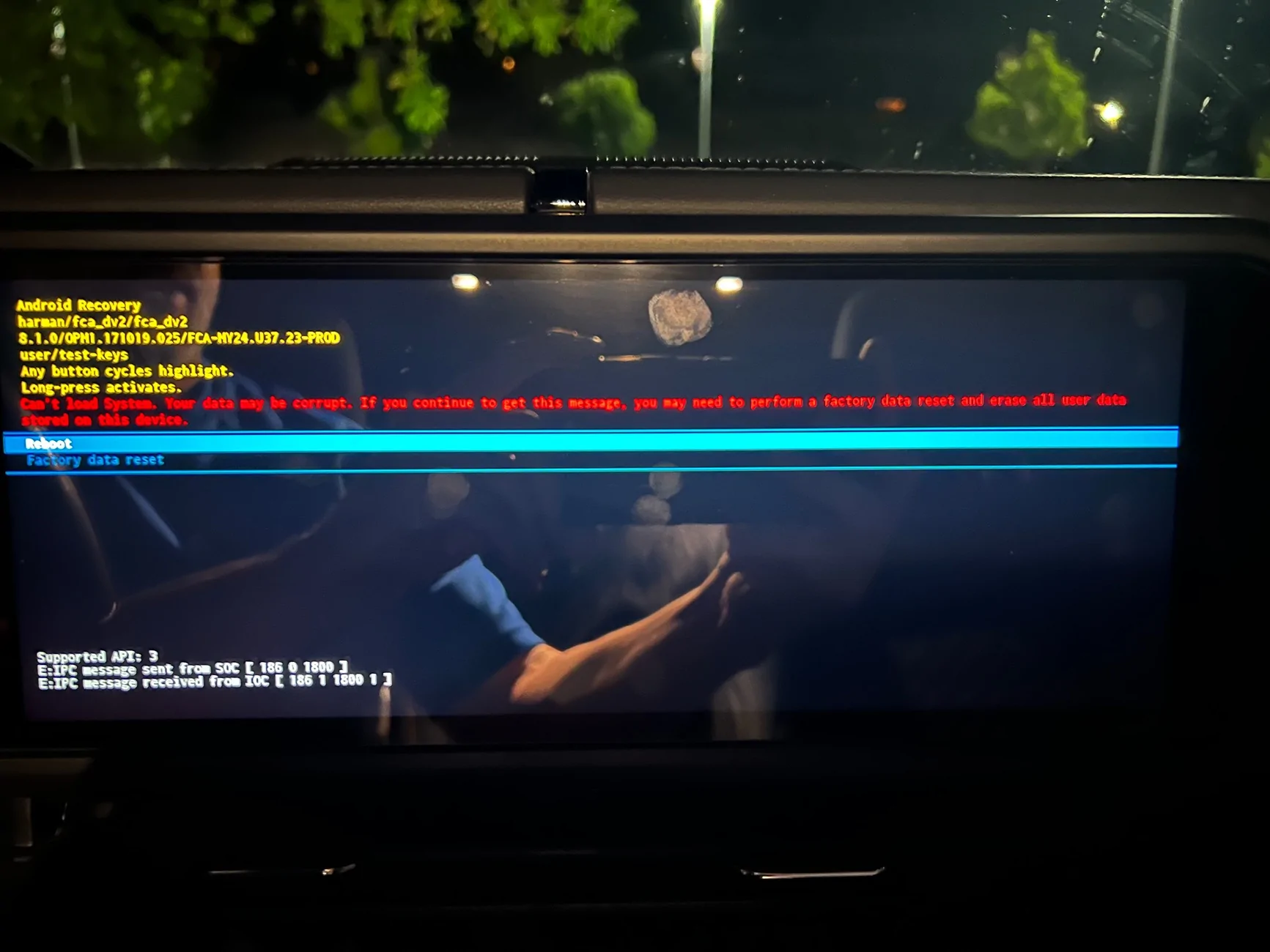

Hopped into it tonight and this is what popped up. So I unmarried the Tazer and rebooted the radio. All is good now. Tomorrow I will remove the Tazer completely.
