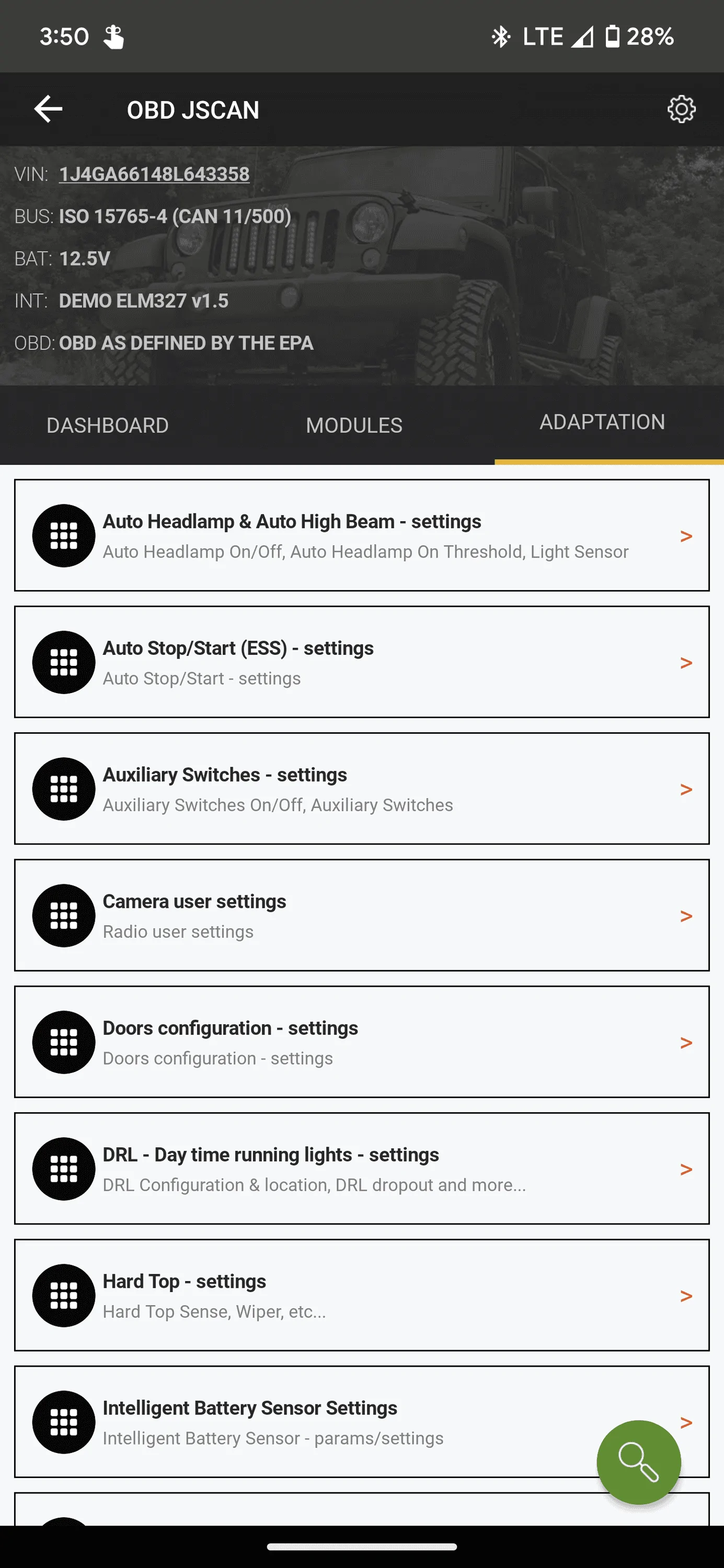

Currently would any of these choices support the 2023-year models (Mojave's)? I have looked around but have found no definite answer.
Please keep me honest with this, from what I am gathering both JSCAN and or AlfaOBD do not require reverting back to stock features/options when going to the dealership (service dept.).
Is this a correct comment?
40,483
53,970
I can't speak for AlfaOBD yet - last I tried (back in March 2023) they had not updated for the 2022 model year yet! Some things worked fine, but some did not.
JSCAN has kept up pretty well. anything I have wanted to do with my 2022, I have been able to look at or do.

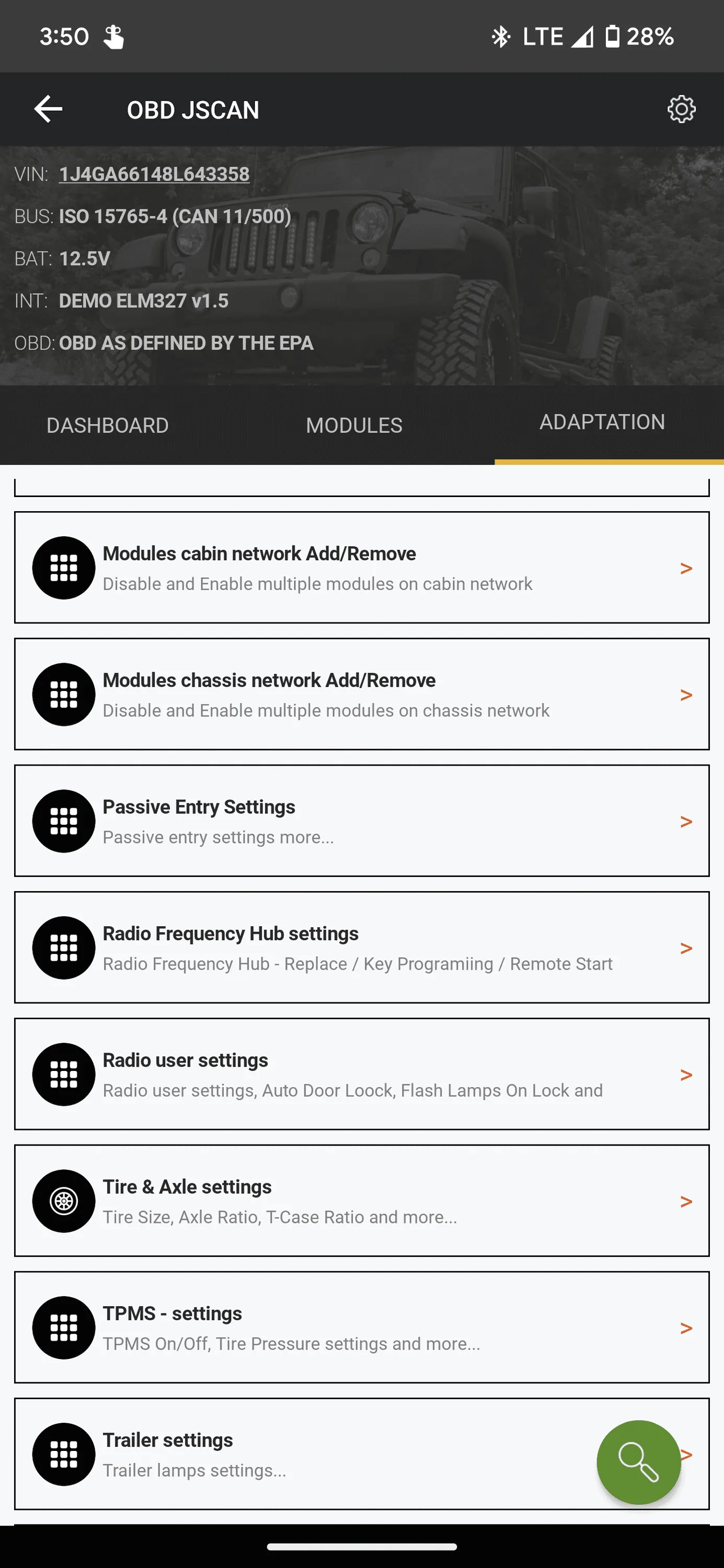

Software like JSCAN or AlfaOBD make changes to the choices in the systems. Tire size is a choice, LED or Halogen lights is a choice, gear ratio is a choice. So once you use that software to make the change, it's saved in that module and you can take your phone away, disconnect the bypass cable and the choices - the changes, are still in that module.
Tazer does things live - it's why it can do things software can't do because it's part of the truck once you install it. And any of those live functions thus disappear when you remove tazer.
If you make a change using JSCAN or AlfaOBD, the dealer never knows you were ever in there. They have no idea. If you change tire size, it's saved in the BCM and there's no trace of any change. The only negative is that if a module such as PCM or BCM or other needs to be flashed by the dealer for some update or a fix, then changes you made could be lost. So you reconnect your bypass cable, launch the app (JSCAN or AlfaOBD) and put the change back in. No big deal at all.
I log any change I make so if something gets lost due to a dealer flash to update any of my systems for a recall or fix, I can put it all back.
Software leaves no traces of a change. No one but you knows.
But those changes can be written over by a dealer flash. Rare, but could happen. and only happens if you need a module flashed for some reason. Again, it's not at all common so don't fret that part. Simply write down any changes you make, just in case.
