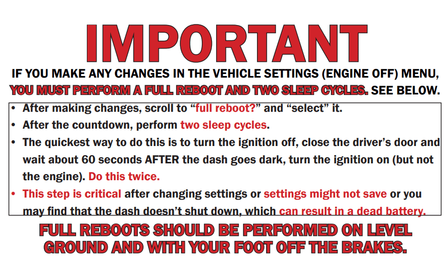

2 things.
First, what firmware version? There was a bug in 11.2.9 related to tire size.
Second, after making the change, are you doing the full reboot and 2 sleep cycles?
Jeep Gladiator Tazer question 1631122624615

2 things.
I am using the older firmware because I read guys were having problems with the brakes looking up or brake light something? I did the full reboot but wasn’t aware of the 2 sleep cycle. For tire size, it’s measured tire size correct?
The problem was a "feature" that was originally turned on by default, so people didn't know it was active. That's been fixed supposedly in the last few versions.
Yes, it should be measured tire size, but without the 2 sleep cycles the setting changes may not take effect.

Definitely don't go by the tire manufacturers measurements. Actually measure the tire. My 34's I just got are more like 33.5's measured which is what I input in my tazer recently although I haven't checked to see if my mileage is off though.
But its set. I did the reboot and stuff not sure about sleep cycles. Kind of seems redundant doing sleep cycles, you;d think a simple reboot would do the trick.
