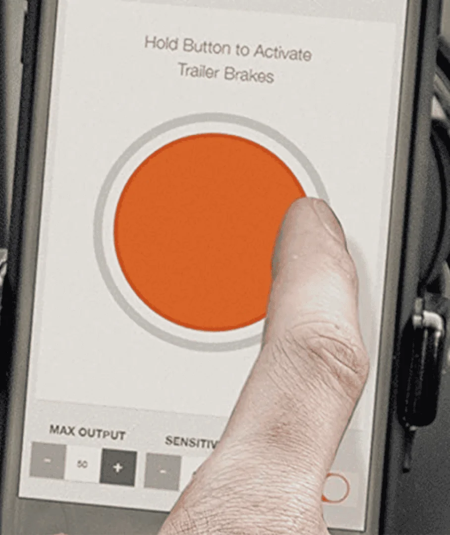

The Curt Echo has the ability to adjust trailer braking on the fly.
It's how I dialed in the trailer to JT brake ratio and once I found what I liked best, I saved it.
The adjustments are at the bottom of the screen.
You can adjust the max output as well as the Sensitivity which is partially obscured by this persons finger.
Jeep Gladiator Tazer question 1685189991515

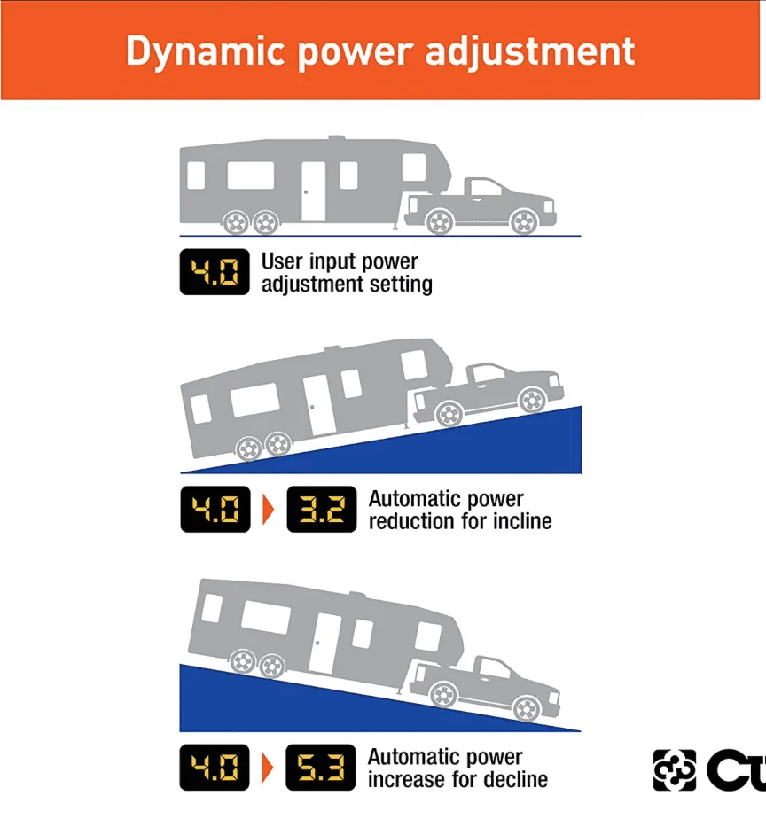

On top of that, the Curt Echo will do some adjustments automatically for you, depending on road conditions
Jeep Gladiator Tazer question 1685190106745

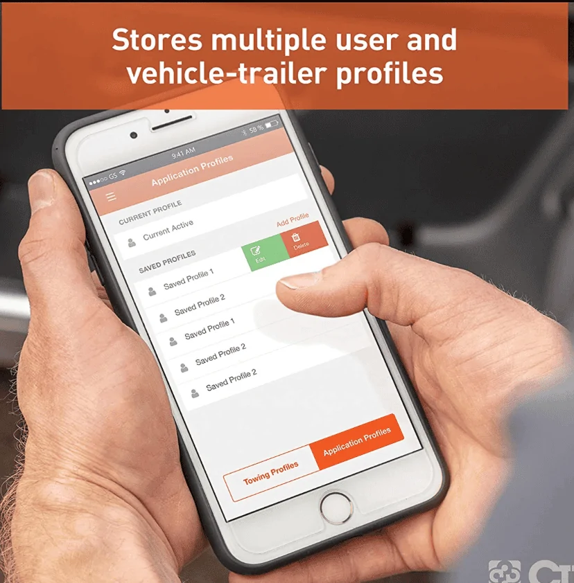

This leads to an advantage of the Curt Echo. If you have multiple vehicles and/or multiple things you tow, you can save profiles for each after you configure the settings.
Jeep Gladiator Tazer question 1685190172431

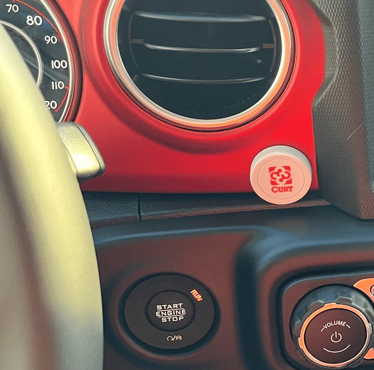

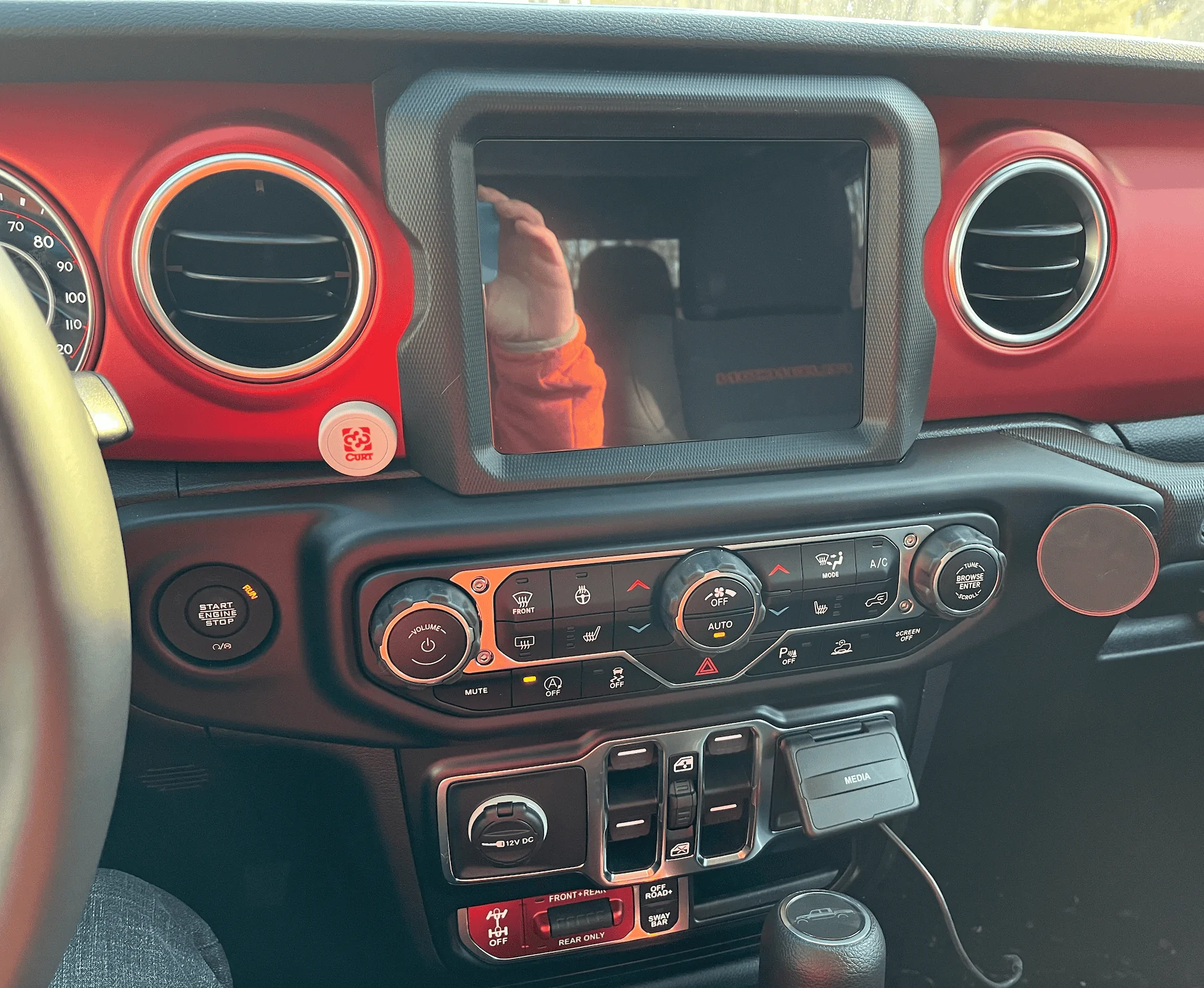

Here is where I have both of mine mounted.
Note: My Manual Override button is closer to my hand than the 12V plug.
Jeep Gladiator Tazer question 1685189610710

So can I, and it's closer to my hand than your set up. Once again visual below.
Jeep Gladiator Tazer question 1685203220952
