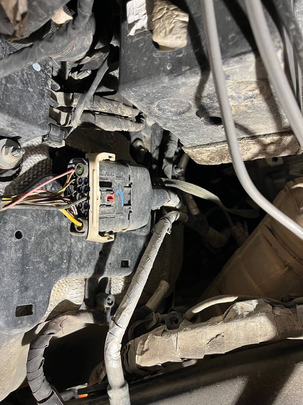

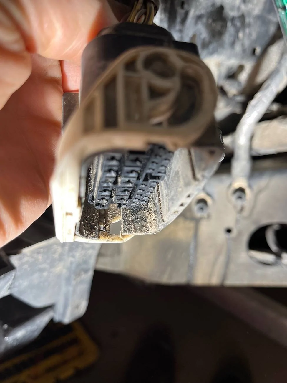

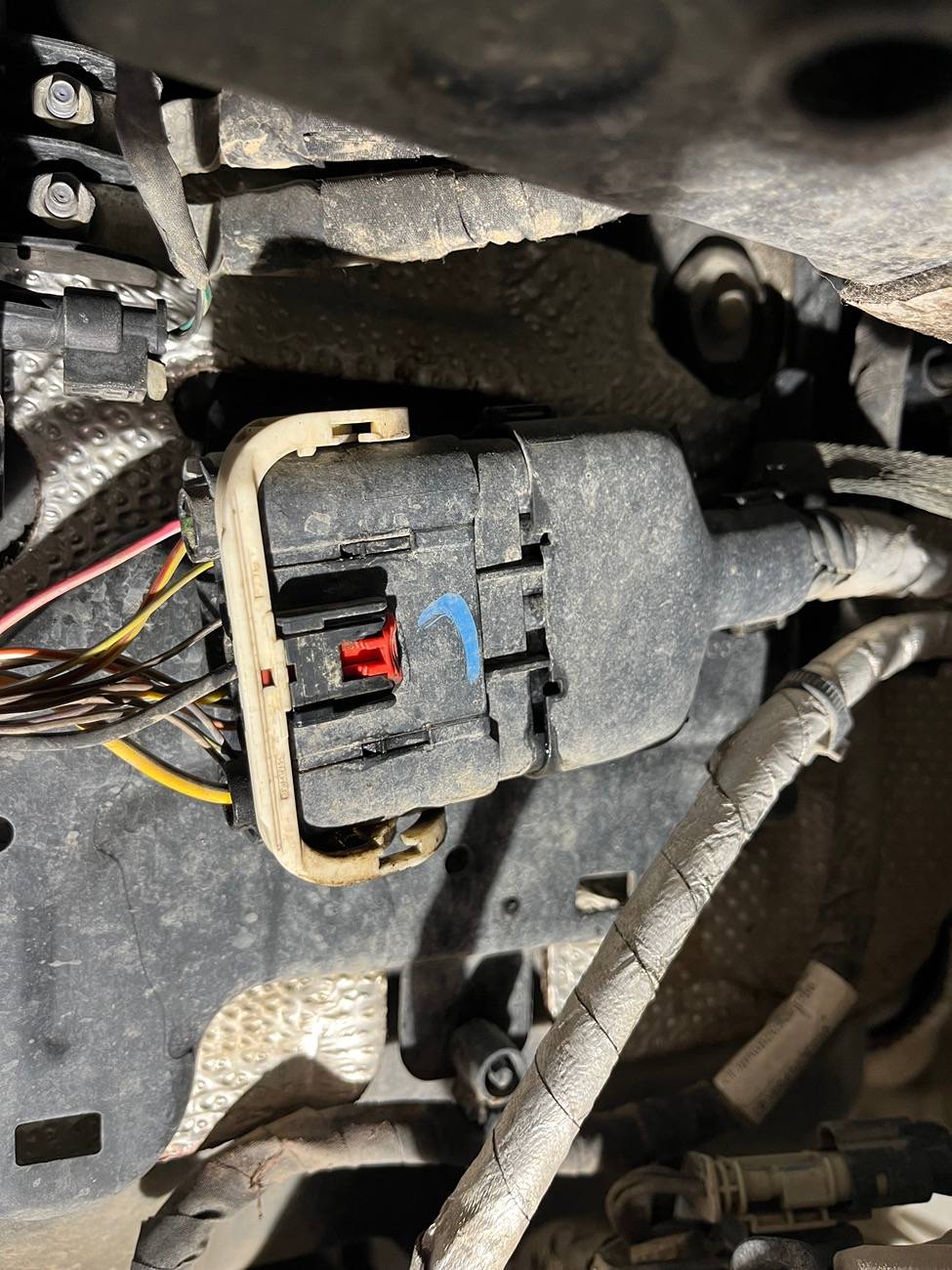

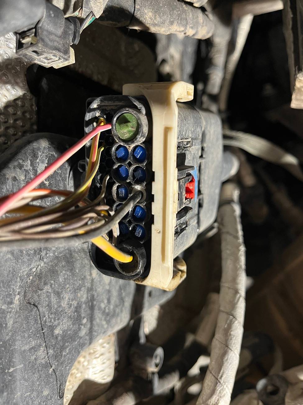

I had read on Facebook, a tech described corrosion can enter this connector (same type of connector like the one we undo when taking off our front doors) and when water/mud breaches the seal, it creates a whole host of dash lights, warnings, transmission and shifting issues, perhaps failed power steering pump etc that immobilizes the truck and takes it out of commission. Then….we all think the battery’s are dead etc.
Today, I thought why wait for an issue from this connector, just get at it, open it up, clean it and spray an electrical connector protector on the pins and apply dielectric grease on the pins.
The connector is just behind the passenger wheel well, next to the aux battery and if you do any muddy fording, it’ll go under water.

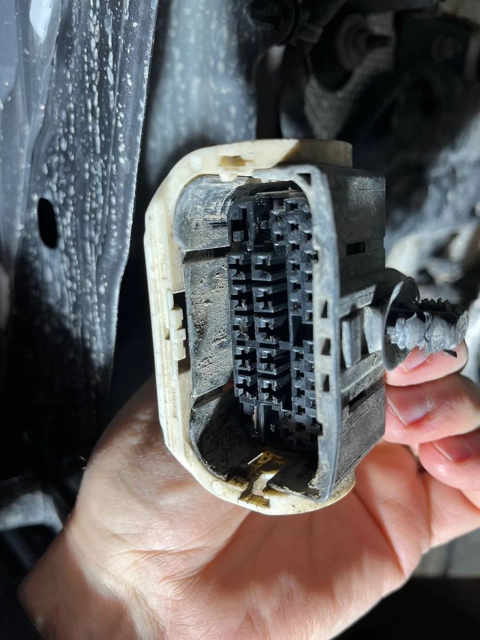

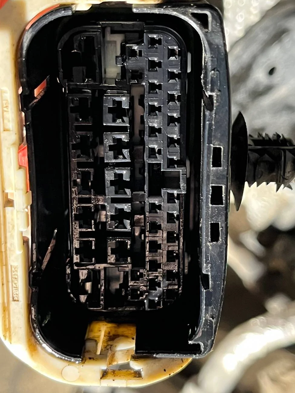

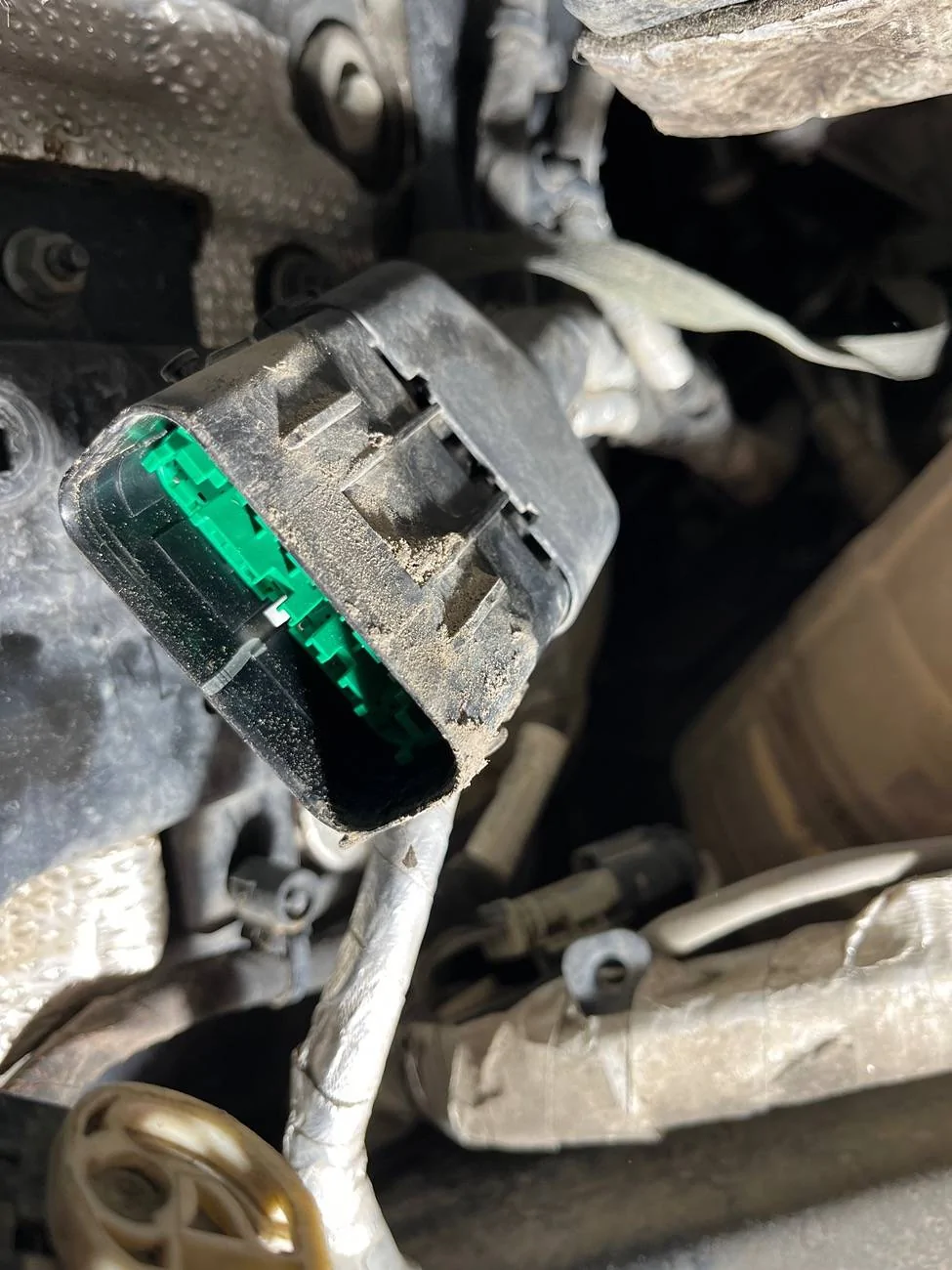

I also found the seal in my connector had been breached but no issues had come of it….yet. I fixed the seal and put it back in place, cleaned it all up and put it all back together. So glad I did.
There’s other plugs there too like an oxygen sensor.

It should be but as I saw with the green seal at the back, there was a small portion of it that was distorted and I had to use a long thin pick tool to try and get it back in it’s track that it’s supposed to sit in. I did a pretty good job of it but there was still a slight distortion to it. I ended up also putting a very small amount of silicone grease just on the edge of the matting connector in hopes it would assist in creating a barrier.

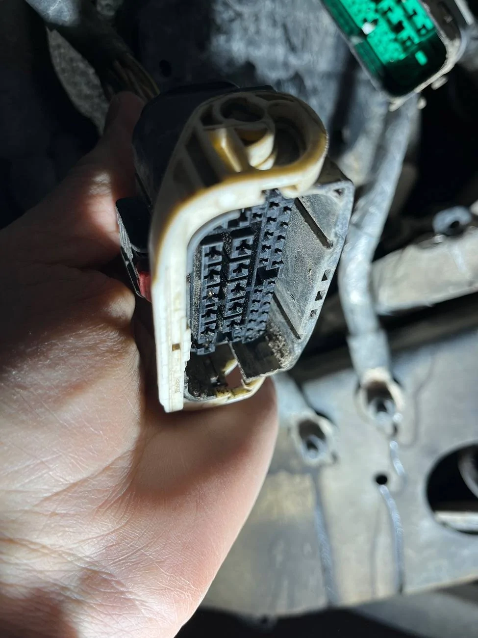

Water ingress can happen on any connector exposed to road spray or submersion. The photos with dirt inside the inner edge of module isn’t an issue. There is a silicon seal on receptacle side of module that interfaces with pin side of module. As long as no moisture is present on the the pins and receptacle face it’s fine. The sill seals around wire entering the shell now those are a different story, having back end of that sealed would have been preferable especially considering location. Wires can have water ingress through sill seal and no way to know until it shorts. Corrosion is established and then it’s pin to pin shorts in that 100K ohm or less range and shit gets weird, worse case scenario a core corrosion occurs and wire fails off terminal. Either way only fix is new harness or repin existing harness. My advice is cover it, make a shield. Use tool box liner, cut a piece of radiator hose(like a taco), something. The goal is create a shield to keep direct saturation off of it. That cam lock, cover that in tape just to keep dirt from imbedding itself into the release.

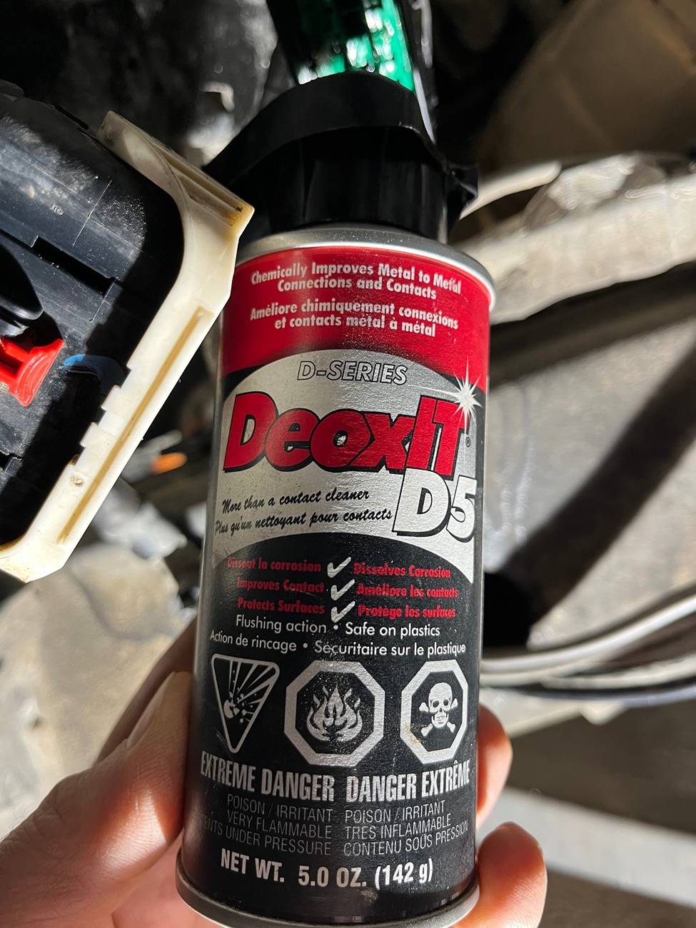

I needed to pick up more of the DeoxIT and I drove over to pick more up and I saw they have a new product I haven’t seen and this stuff is for electrical connectors that are susceptible to “…severe environments (humid, salts, pollutants, etc)”. So any connections outside the vehicle like the TCM etc, can be treated with this.
Jeep Gladiator TCM Connector - Preventative Maintenance IMG_3515
