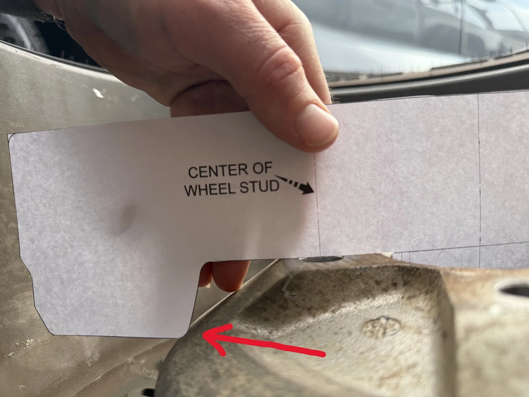

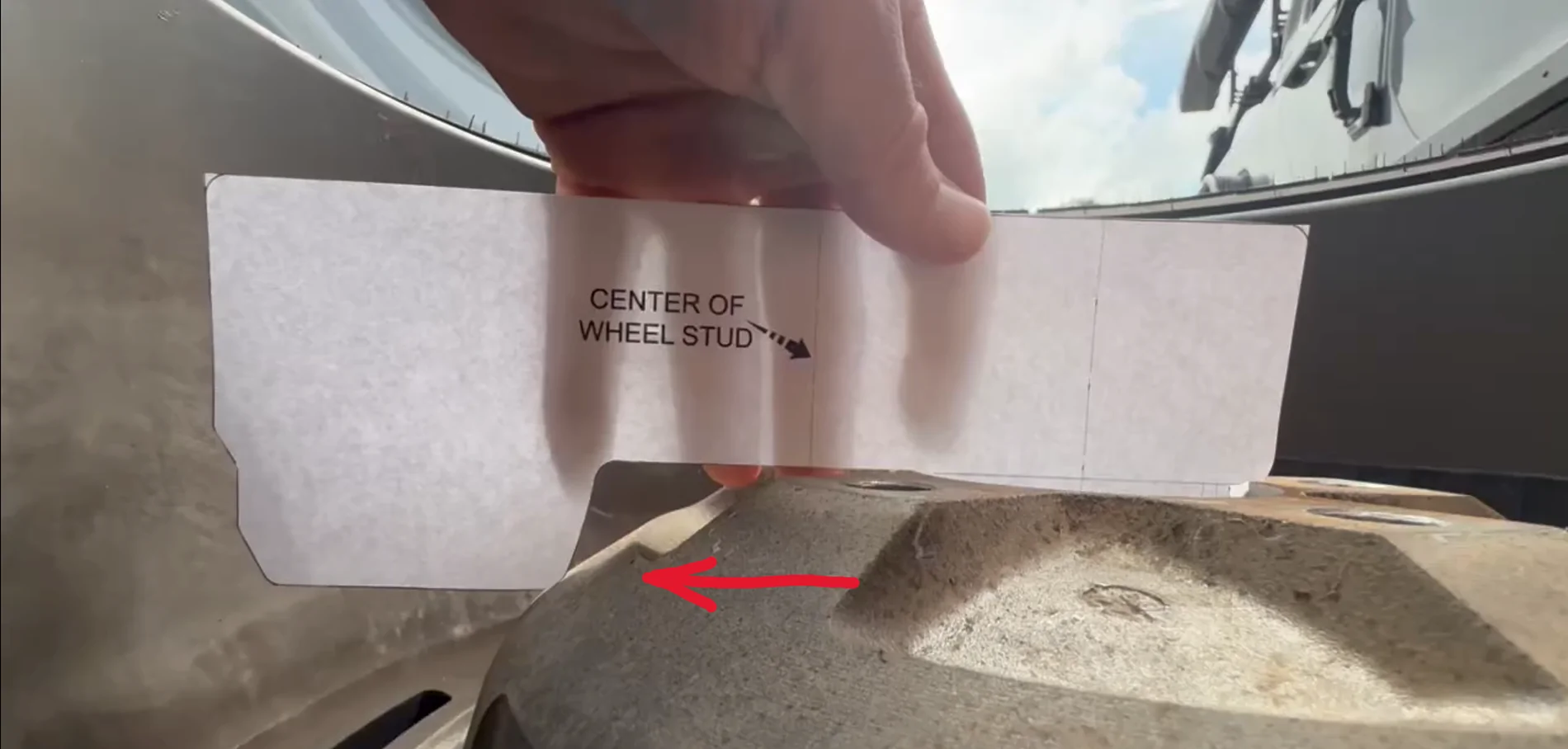

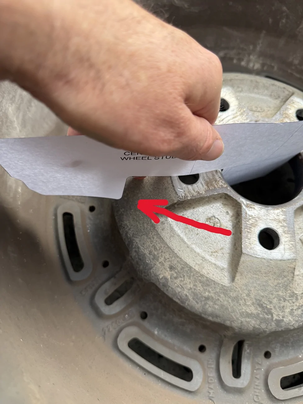

Thank you for your advice. I have tested everything with the TeraFlex template printed true to size. It was hitting the wheel slightly. Although this was minimal, I confirmed with TeraFlex that there is no room for play with the template and my wheels will not work. Here are some photos for others to reference of what will not work. For those of you who have installed these brakes can you please tell me what has worked for you. Thank you.

The inside diameter of the inner wheel is often too small to accommodate the oversized calipers! The extra backspacing in for turning at full lock and not hitting the frame with larger tires and is not affecting the brakes.
