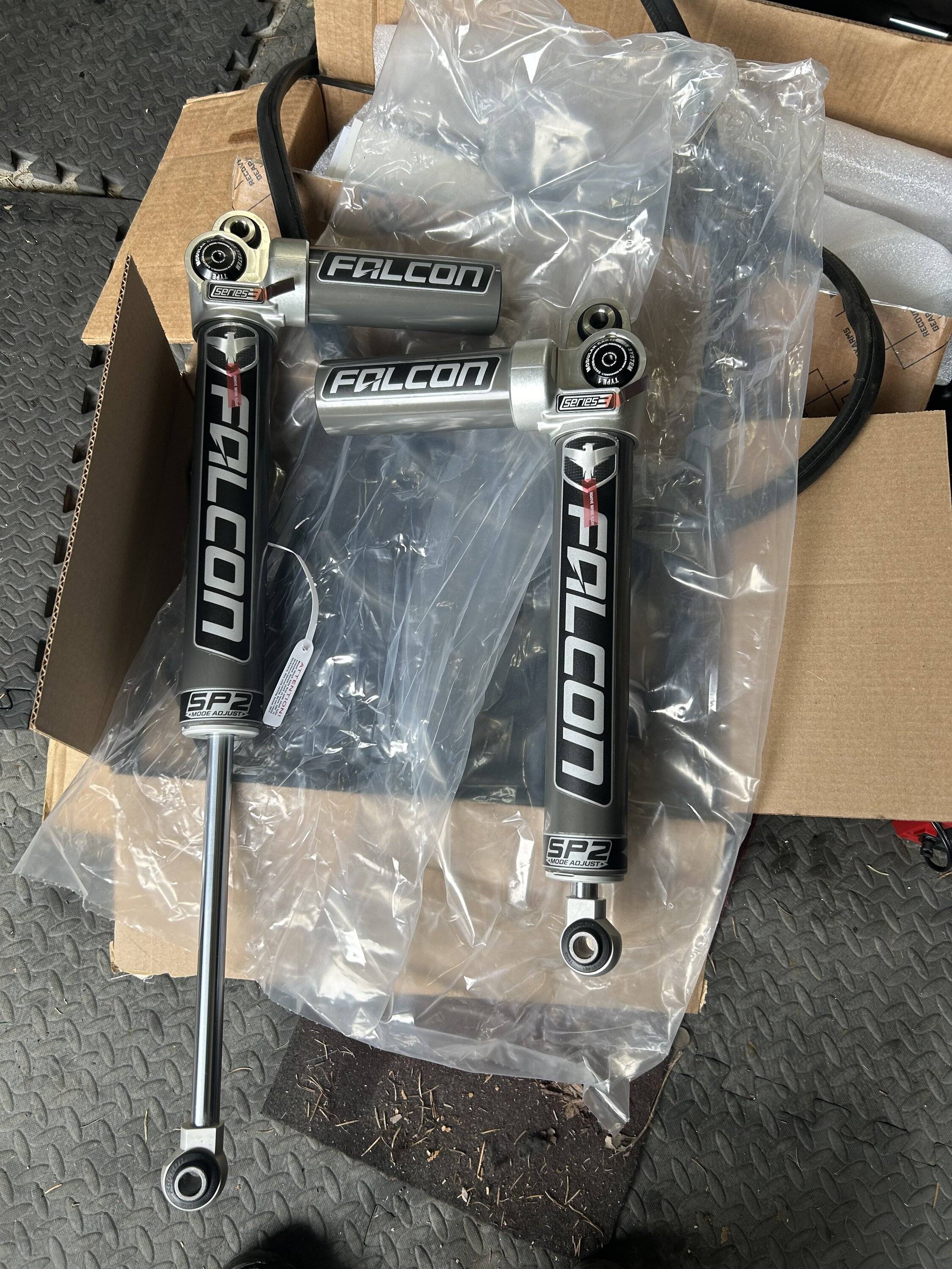

Received my brand new 3.1 shocks after installing my 3.5” teraflex coil lift on my 22’ Mojave. Ordered the bushings as well for the Mojave. First issue was two Mojave bushing kits arrived with only a single upper bushing. I was assured that was incorrect and sent another kit. Few days later another kit, Once again another single upper bushing. My shocks showed up a couple weeks later (still no lower bushings yet) and I was able install the rears without issue. Fronts I replaced the upper bushings and was checking the shocks. Passenger right has no gas charge. Super soft to push down and zero rebound. Contrary to the driver side which is stiffer and rebounded immediately. Teraflex was great in getting back to me and sending out another shock asap. My question is anyone had issues like this with Teraflex recently? Had Teraflex since my JK over 10 years ago. Never an issue until recently. See attached.

Yeah Im connecting with some local shops tomorrow after speaking with my neighbour. He stated most of the mountain bike suspension rebuilders here in Whistler can nitro charge shocks easily to 100psi.

Had the shock nitro charged to 100psi, its slightly better but not by much and rebounds very slowly. Unfortunately need to put it on and Teraflex is still sending a replacement.

TF customer has been 5 stars across the board. Gentleman by the name of Canyon has been on top of everything snd responding to emails quickly. New shock is slated to be built and shipped out asap.
