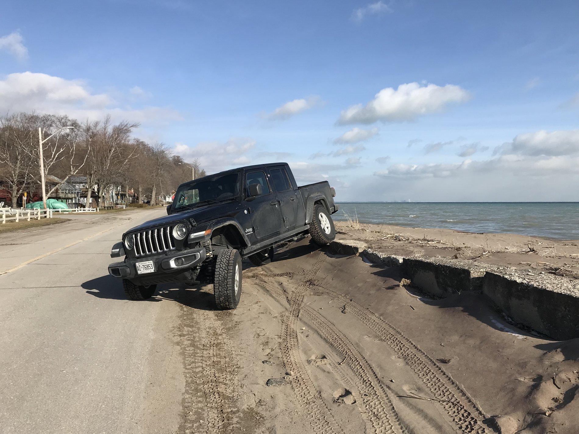

If you can find the right length extensions probably worth a try! RK states a maximum of 28.5 for the brakelines up front. My JKS 3.5 inch lift came with 26.5 inch fronts. The stock fronts are around 23.75 inches. I have no issues with over extension up front. There was still some downtravel left in the pic, not sure how much.
Be sure to consider compressed room/length also.
Jeep Gladiator terra flex 24DCF21C-54C0-45EC-A8A7-D4C86CCC4D9B
