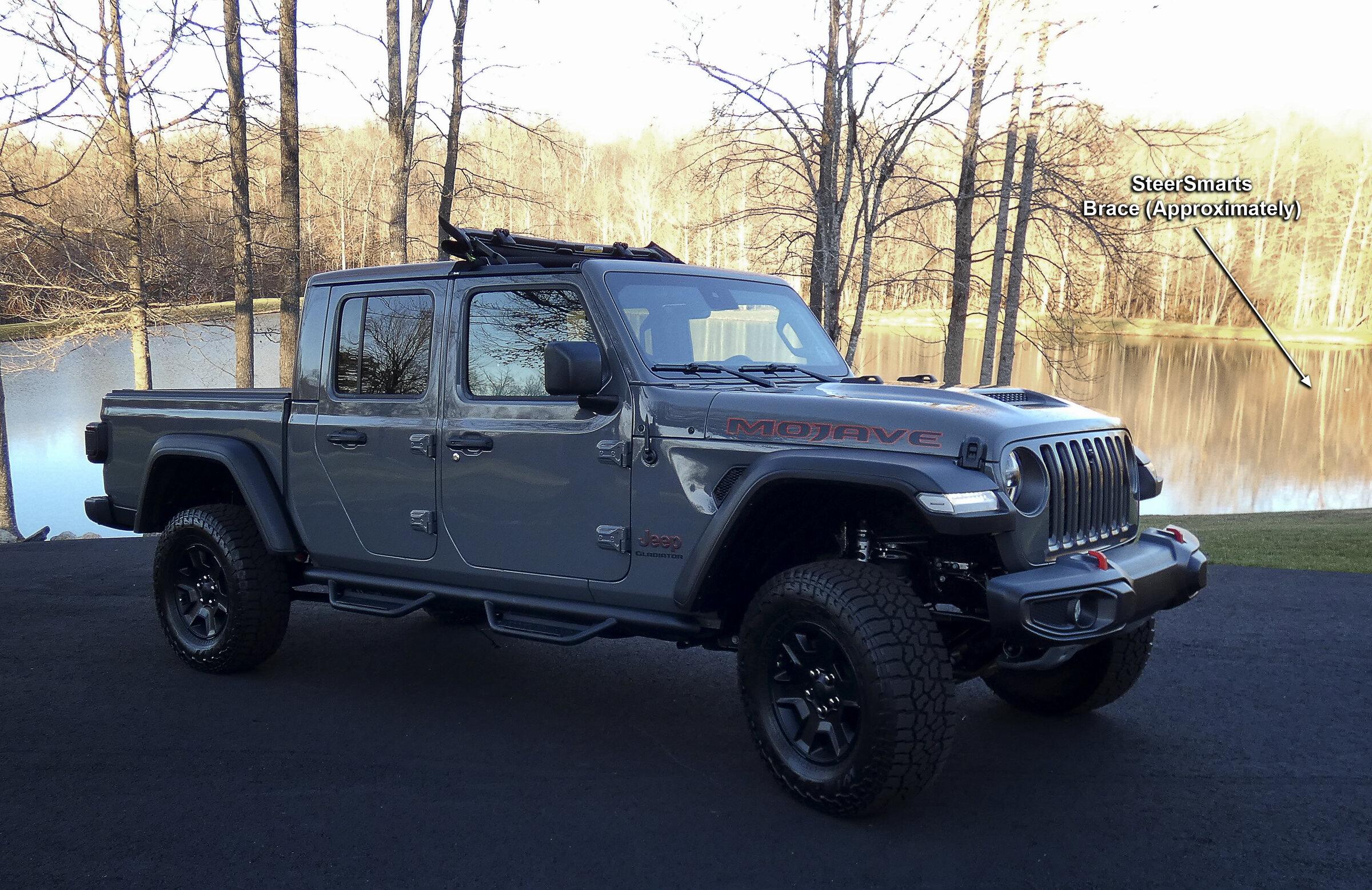

Is that your new steering stabilizer on the front? ?
Lunentucker
Lunentucker
Apr 24, 2022
248
5,897
15,476
2021 Jeep Gladiator Mojave
People Work?
(@Lunentucker)HAha NOOO. Last winter.
