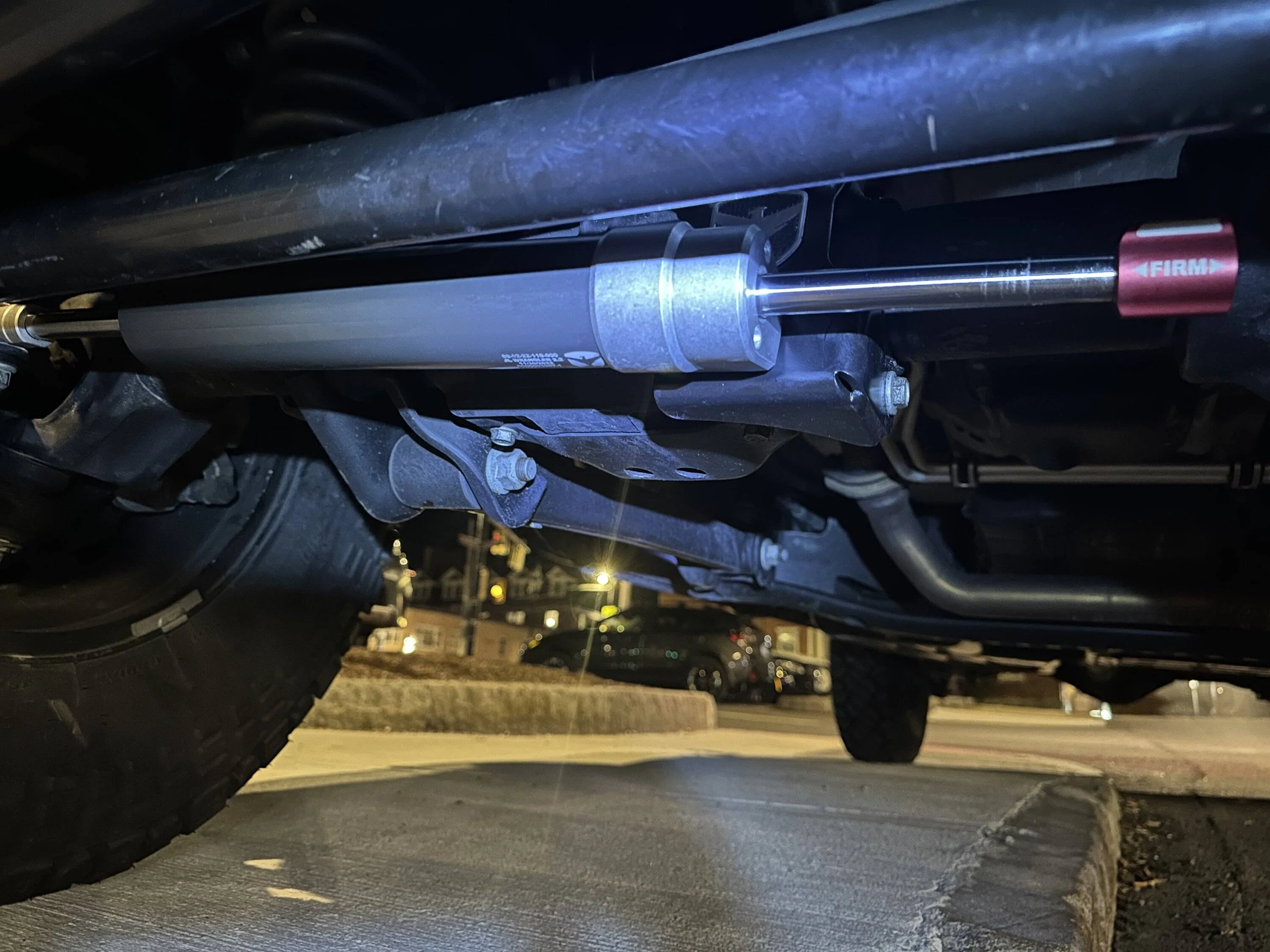

No. They're ready to go out of the box. Turn it to soft and press hard. It's way stiffer than the factory stabilizer.
I believe the way the brackets are set up, this is what the final looks like, unfortunately I couldn’t get the falcon decal sticker to face away from front of truck..
After install…
I think it’s ass upside down
in other words whatever setting is facing towards the rear is the setting I am actually on
After install…
Several have been installed 180 degrees off. You should be able to see each setting from the front of the vehicle.

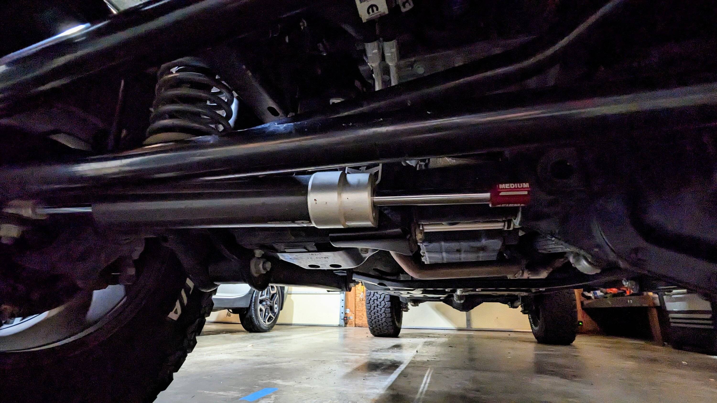

After install…
Just took this pic of mine. I think you got it right.

If you can flip the adjuster and read, soft, medium, and firm from the front it's mounted correctly.
