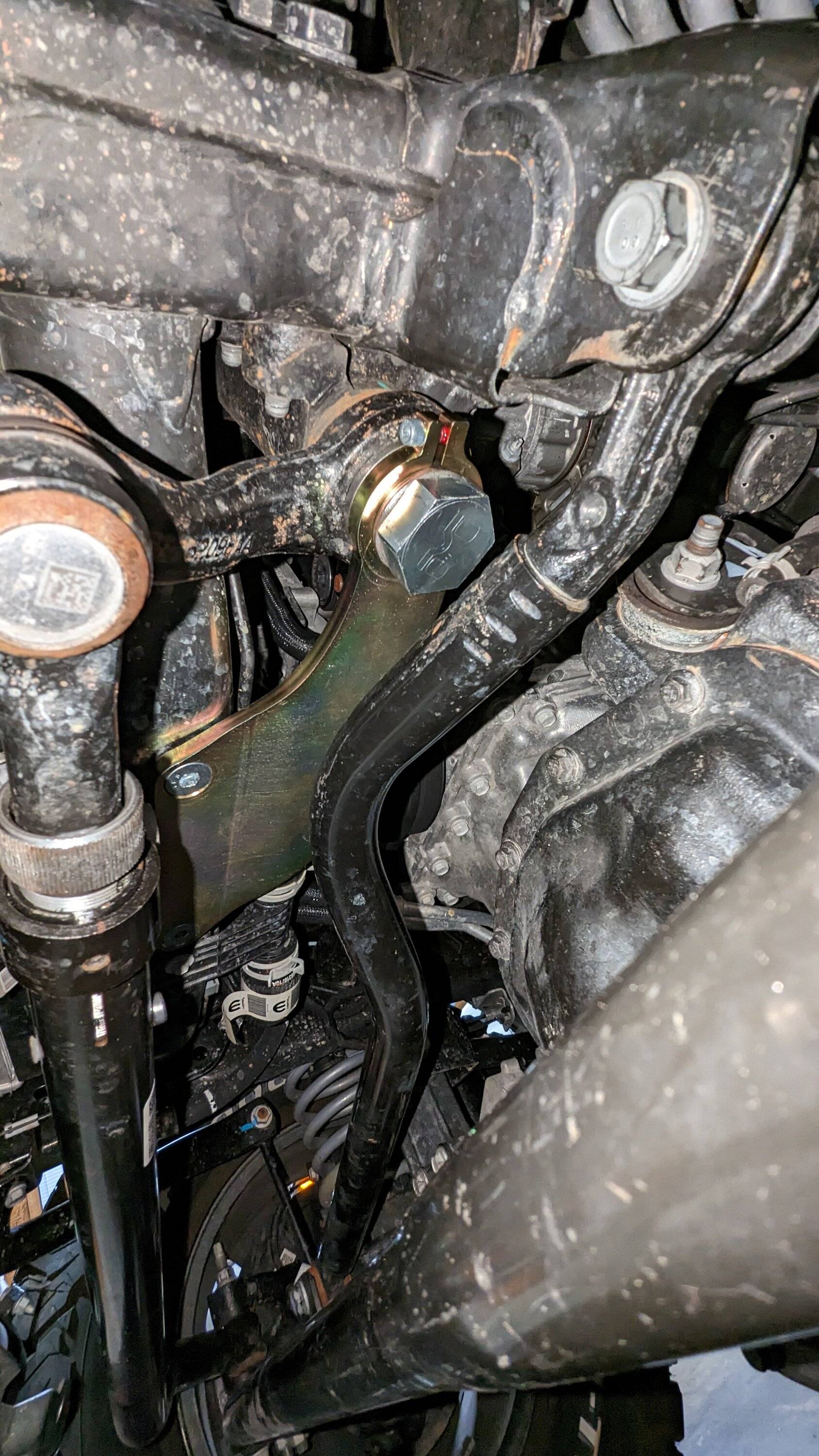

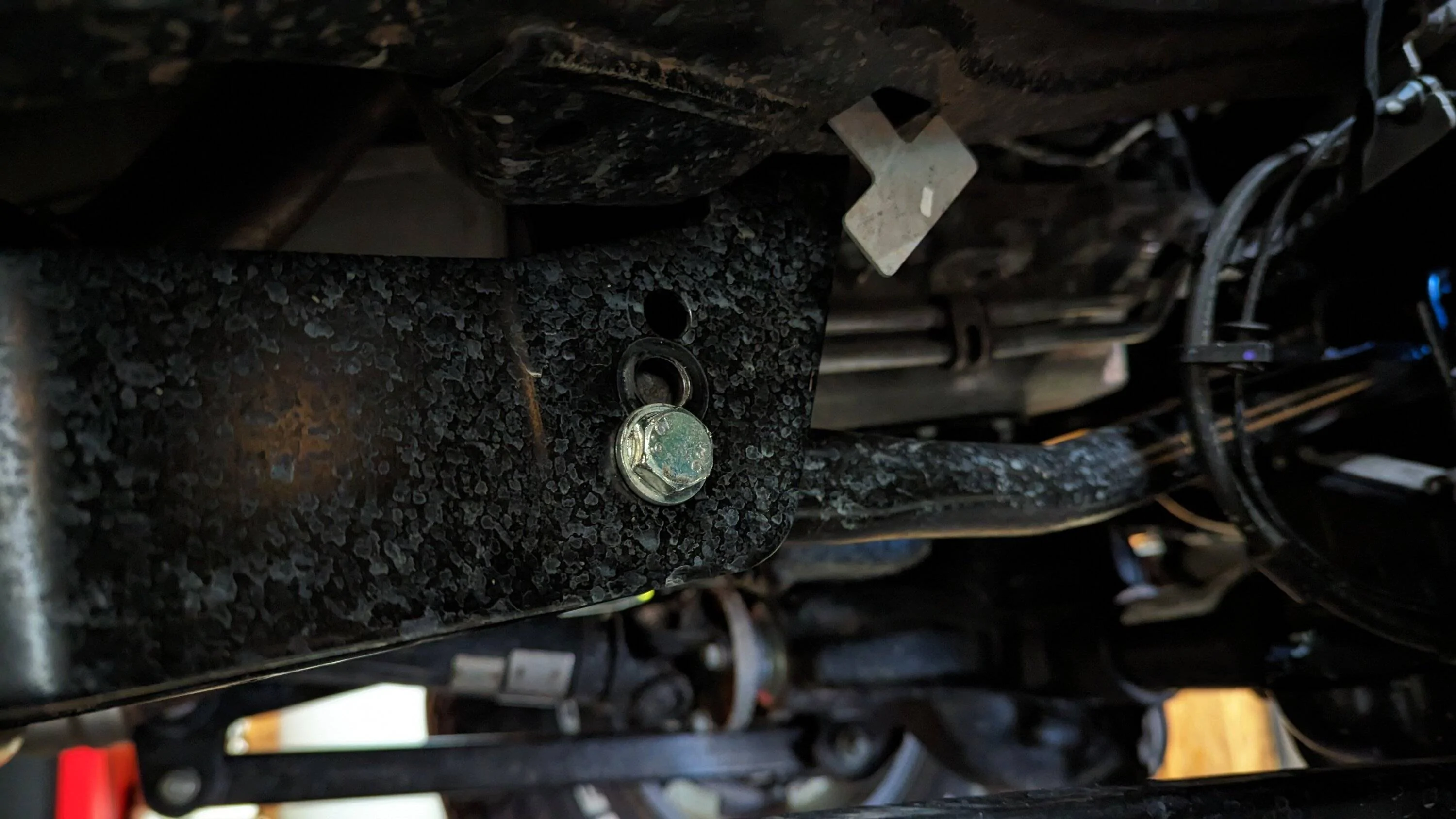

One last update, just in case anyone stumbles upon this thread through an online search.
Yesterday I installed the Metalcloak Sector Shaft Brace, and while it certainly made everything feel much more tight, it was almost too tight, and the wheel didn't want to return to center quite as well as before.
So today I made the final move and dropped to the last hole down in the Rancho Geometry Correction Brackets.
Now I just drove this vehicle about 600 miles earlier this week, and I thought it was fine on all kinds of roads and at all speeds, but....
WOW!
I am now convinced more than ever that the Mojave is caster handicapped from the factory.
The third hole down on the brackets have this thing driving amazingly!
I haven't measured caster, but I am guessing it's somewhere around +7.
Had it running 90 today on the rural two lane that runs by the house, and I could control it with one finger!
After turning, the wheel wants to return to straight beautifully.
Final answer:
Take the slop out of the steering gearbox
Install a good aftermarket stabilizer
Install Metalcloak Sector Shaft Brace
Install Rancho or similar Geometry Correction Brackets and go one holes past what they recommend for your lift.

I think if I had an otherwise factory Mojave with no lift I would install the Mopar long control arms, the Metalcloak brace, and check the steering gearbox free play.
I'm pretty sure my truck drives better than any new one now.

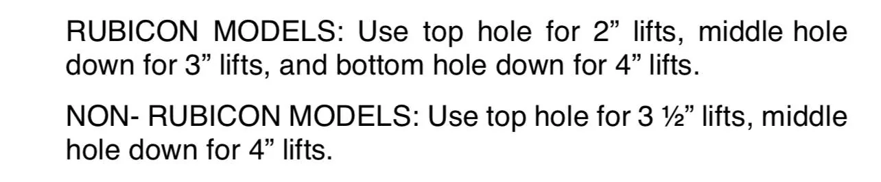

I haven't measured caster, but I am guessing it's somewhere around +6.2.Had it running 90 today on the rural two lane that runs by the house, and I could control it with one finger!
I’m in the center hole at 7.3 on a 3” lift
I think your caster may be more than you think.
