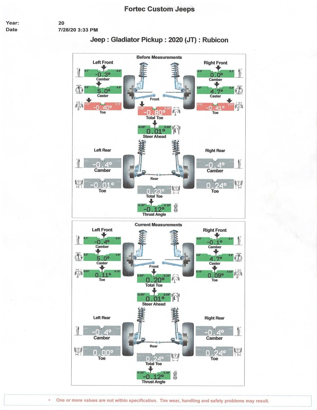

Interesting how you got 6 degrees with the Mopar LCAs. I installed mine and only got 5 and 4.7 degrees. Still ways better than it was before apparently it was at 3 degrees. This upgrade and an alignment that fixed my toe in and a steering stabilizer significantly helped improve my wonder/tracking in the highway.

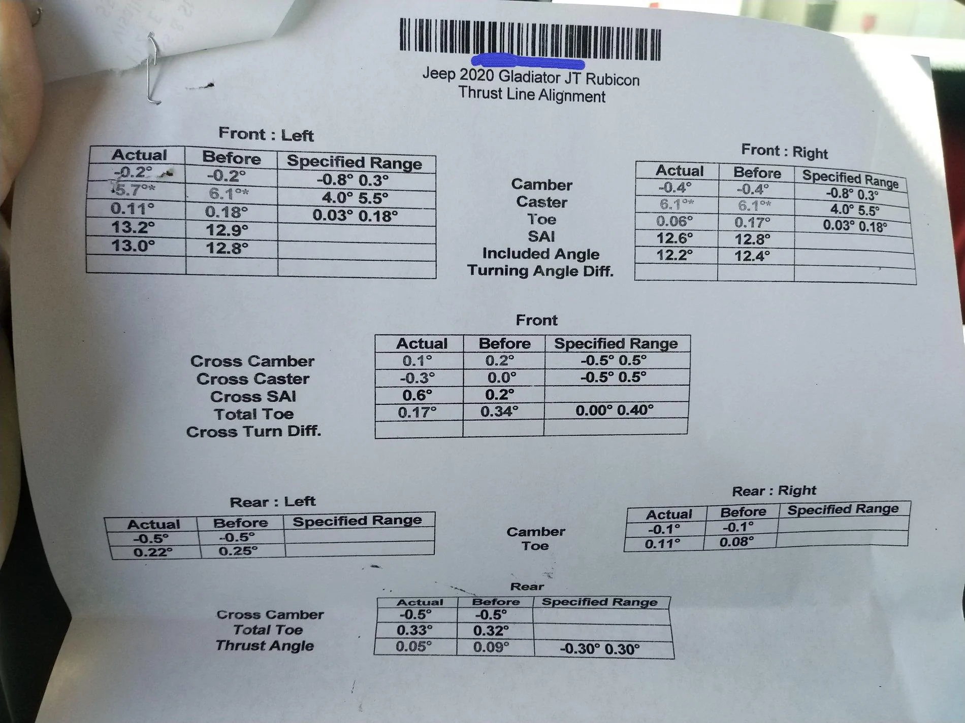

Final report. I didn't get a report with the original LCA's, they didn't charge me for a thorough evaluation and test drive.
Jeep Gladiator Solutions for the freeway wander - will track bar/steering stabilizer help? IMG_20200807_114704
Kind of curious how they tweaked the caster with fixed arms.
Here's mine. Yeah I didn't get the first alignment before they replaced the LCAs either. Damn my before Toe was way off :facepalm:
You have to change the control arm length to change caster and then you can only change both sides by the same amount. In other words, you can't have a difference of -.3 before and then 0 later. The solid axle prevents you changing caster on one side and not the other. The only way you could do that is if you could turn the tube on one side and not the other.
Camber is also set - can't be changed. On IFS, you set that by moving either the upper or lower control arm in or outward (moving one of the ball joints outward or inward) to tip the top of the wheel in or out. There is no such adjustment on these and the camber is set in stone unless somehow you could turn a ball joint like an eccentric.

Which is why I'm curious the driver's side caster changed from 6.1. to 5.7.
I wouldn’t be too worried. With power steering and a solid axle, 6 degrees is significantly better than 3 degrees. Even if your steering box is loose, it won’t be as noticeable with that much caster and the tracking will feel solid with little wandering.

The idea for using the VERY inexpensive LCA's came from a link on this forum to the LJ forum - the wonderful world of shared information! The very inexpensive LCA's came from a forum sponsor, @AllMoparParts.com which is yet another benefit of this forum. Without the help of the community, I would have been mildly dissatisfied and my sweetie would have been needlessly anxious.
If the caster was excessive enough to be an issue, Larry would have said so - and based on his questions, he realized it was a bargain solution to a widespread problem. I hope other JL/JT folks get a whisper in their ear on how to fix it.
My association with this suspension shop goes back to my grandfather, who had several pickups with Hellwig overload springs. This shop is the retail outlet for Hellwig.
Unsurprisingly, my 4x4 shop uses them for alignments for all their projects. Benefits of a physical community, as opposed to the virtual community here (both are GREAT!).
Again, Larry drove it my JTR a week after I bought it in for wandery steering,. No charge for measuring and test driving it later, he told me to live with it because it was marginal for caster, with excessive toe-in, come back in 10K miles. Everyone laughed when I said if the dealer told me that I would have called bullshit. Instead, I had the data points I needed to resolve the issue.
I don't have the sheet for my old Ranger, but after installing cut and turned I-beams, I had enough caster left to go up from a 4" lift to a 6", which I never did. Having a shop willing to work with that much of a hack job was priceless, they'll have my business forever.
Thats a great idea using the Mopar lift arms with no lift to get that extra bit of caster.

Not too much, just outside the self-serving factory spec. If it was an issue, I would have been informed of it. I'm also glad to not be wearing my spendy tires in a weird way due to inefficient toe-in.
I've had "plenty of caster" setups before, I don't mind a bit more effort in the steering. A truck is not a track car, as long as it's a ways off of a dragster for straight ahead I'm good.
"Way too much" can cause caster wobble or a vibration in the steering wheel or road harshness, shock on bumps. But i doubt you are close to that. It should increase stability and the truck wanting to return to straight after a turn. I'd not worry where yours is at
