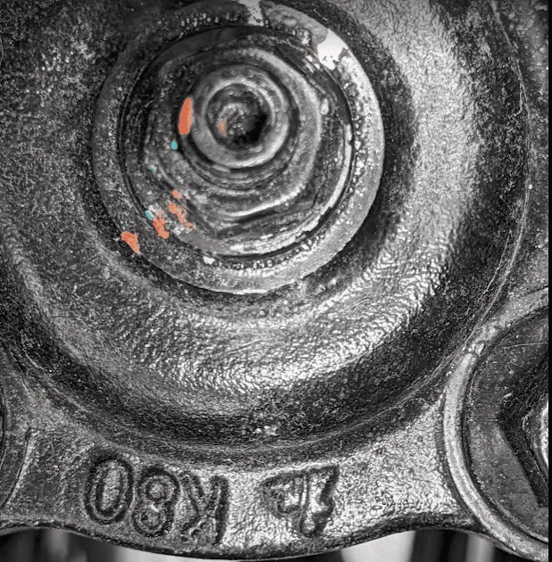

Thanks for all the info. The dealer recently replaced my steering stabilizer with a new one which had a stiffer feel, but the wander was still there a bit. I tightened the box about a 1/16 (didn't feel a difference), then another 1/16 of a turn and now it just feels 'stiffer' but still needs the same amount of correction to the wander.
May have to go back to the dealer & see if they have any other ideas or drive another Jeep and just see if it's me, lol.

Stopped down to the dealer last week and had a tech ride with me. They are going to replace the steering box later this month. He did an interesting test where he grabbed the steering shaft before it hits the box and turned it back and forth. the steering wheel turned probably 2" each way before the gears engaged. He was also familiar with adjusting the box and since I had already done it they were good with the box replacement.

Steering box replaced, it's better, but not 100%. Dealer will get back to me on next steps - they may adjust the box screw, and/or have me take out another brand new one (willys) and compare.
