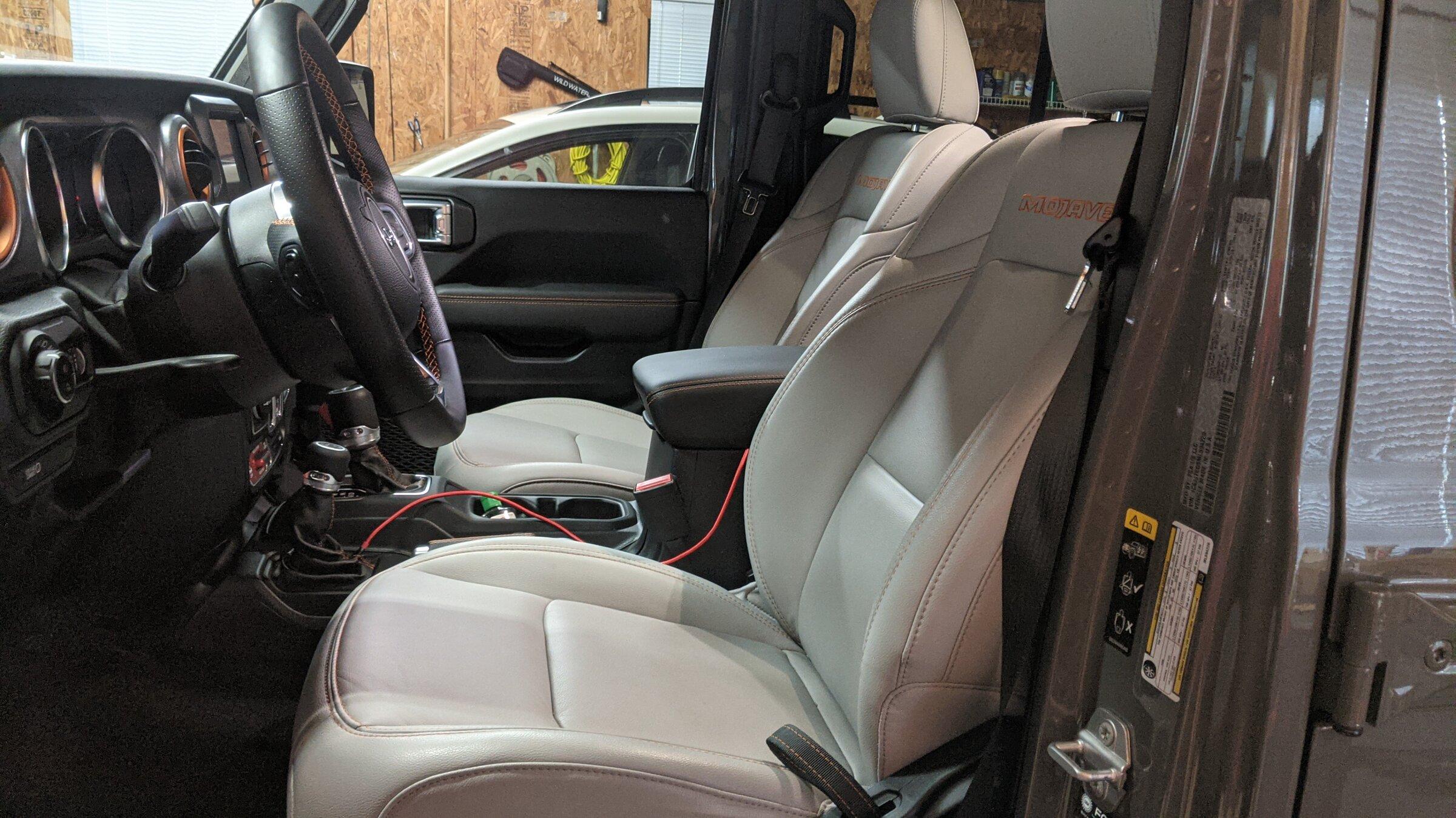

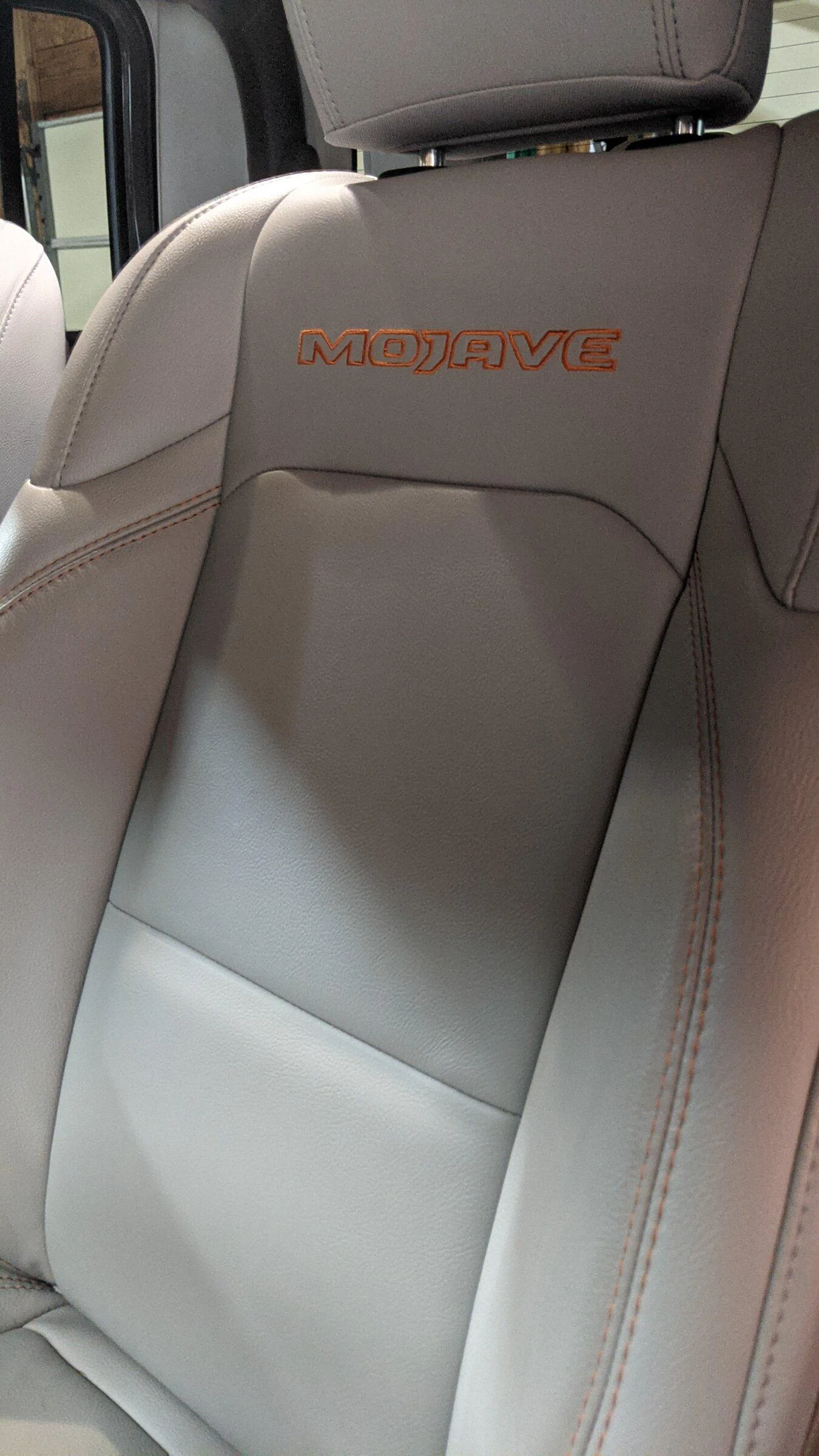

OP - Can I get a pic of the "White leather" you mentioned in the original description?

Looks very unique! I never knew white was an option. Thanks!
Yea they call is Steel Grey on the ordering sheets, but it's a super light gray that is almost white. I could never with 2 huskies in the backseat lol I would regret it instantly, but it looks great.
I think it looks great, too......... but with all of my shop work, jumping into my truck at the spur of the moment with dirty jeans and arms, and that sort of thing, it just wouldn't look that great for very long. But that doesn't mean I can't still admire it in the trucks of others.
I test drove a Snazzleberry Rubicon with these seats. While they looked very nice they were already getting in blue stains or discoloration from folks sliding in and out in jeans. I can’t see them staying nice for long but they were sharp.
