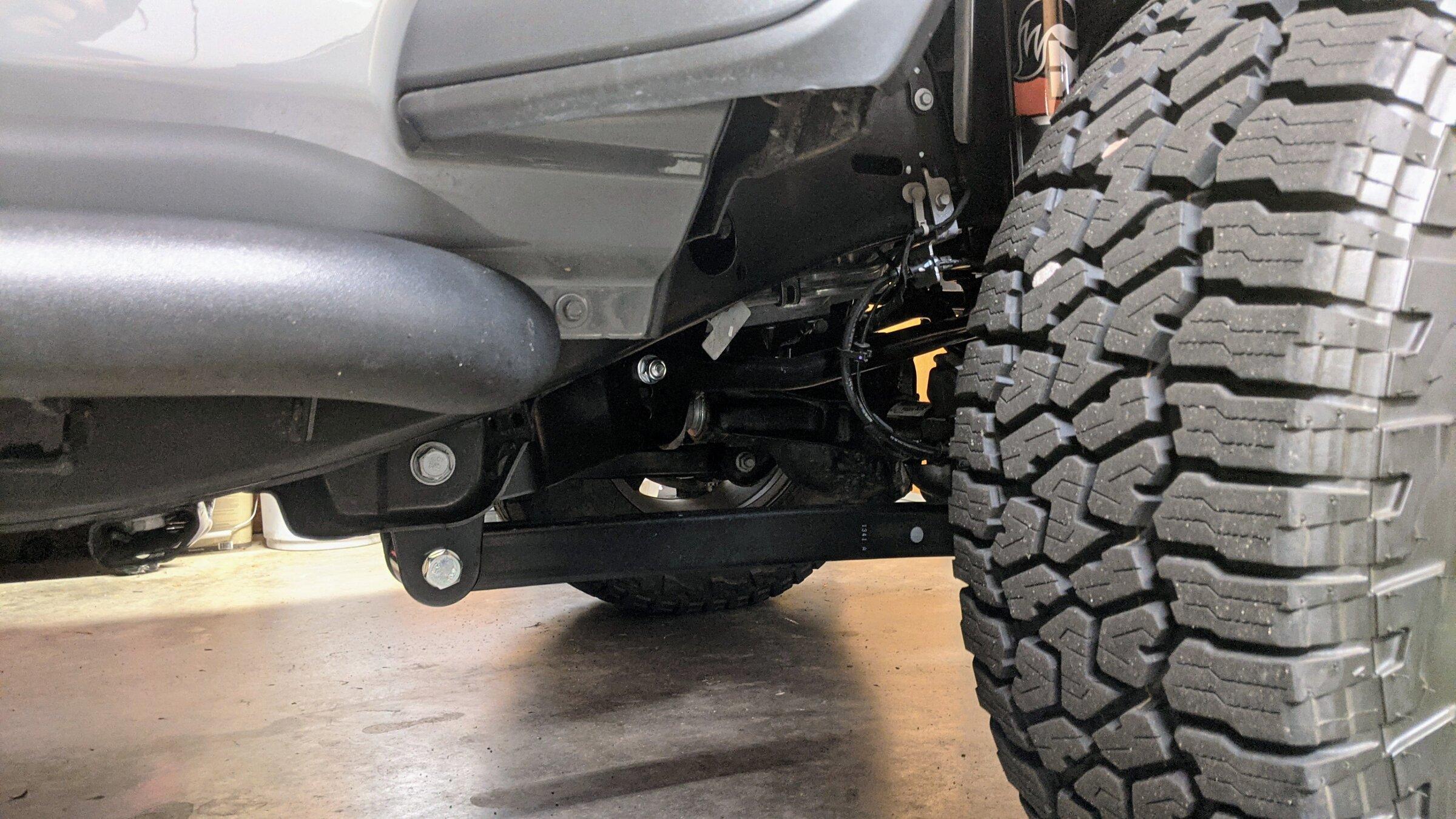

Finally getting a chance to get back and close this story.
I ordered the Rancho brackets and installed them.
I should've taken a picture of when I had one side done, but you know how it is when you're doing things. You just want to get the job finished.
At any rate, the brackets got my control arms back in proper angles and the truck not only handles like a dream, but I can also feel a lot less of the road in the seat of my pants and in the steering wheel. $200 well spent!
I am leaving the adjustment on the gearbox where it is, removing virtually all dead play in the feel at the steering wheel and giving me a wander and drift free driving experience.
So to recap -
Issue - Steering Wander and Bump Steer
Cure(s) -
  • Falcon adjustable stabilizer ~50% improvement / cost $427 ($36 after points :) )
  • Remove dead play in steering with gearbox set screw adjustment (around 1 or 2 clock positions) ~85% improvement / cost $0
  • Geometry correction brackets ~50% improvement on handling / 70% improvement on ride quality / cost $210 for brackets + $85 for tools at Harbor Freight + some sore muscles and one bruise

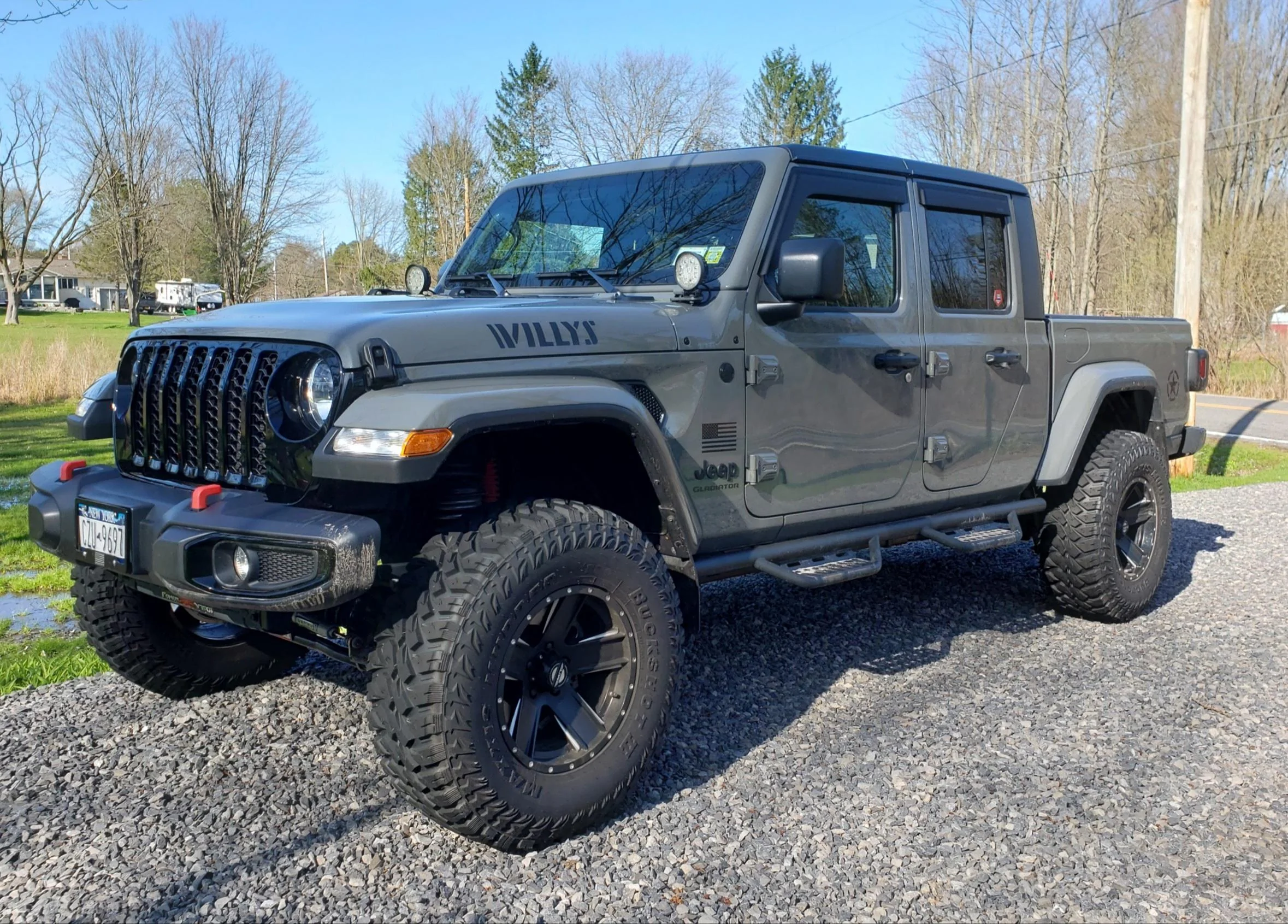

This a response to HOLES question about 35's w/a RC 3.5 spring lift. That's what I'm runnin & am pretty happy w/it. It's tall enough for me, doesn't look like everyone else on the road. I've yet to put on my front lower control arm brackets, but hopefully soon. Been waiting for some dry sunny warm days here. The cheaper V3 shocks aren't bad till it's single/minus digits outside. It sat level, the front springs are BIG, so I added 3/4 spacer in the rear. The rear springs are pretty soft, so I'll adding some bags out back to firm it up.
That looks nice. Appears to be 35” tires. They don’t swallow the entire rear wheel well.
I’ve got a set of the mopar side steps on the way. Actually expect them today or tomorrow. I wanted something that bolts up to factory mounting locations, and I’m not concerned with rock rails. My wheeling is predominantly up north. Mostly mud or trees. No rocks or canyons to speak of. But, if we move west to Montana...there’s more rocky area there than Minnesota. I guess it all depends on where you go.
How do you like the ride and handling?
We’re not building race cars here. So I can deal with having to be more careful with regards to corners and handling. I just don’t want to manufacture a death wobble into my truck.
