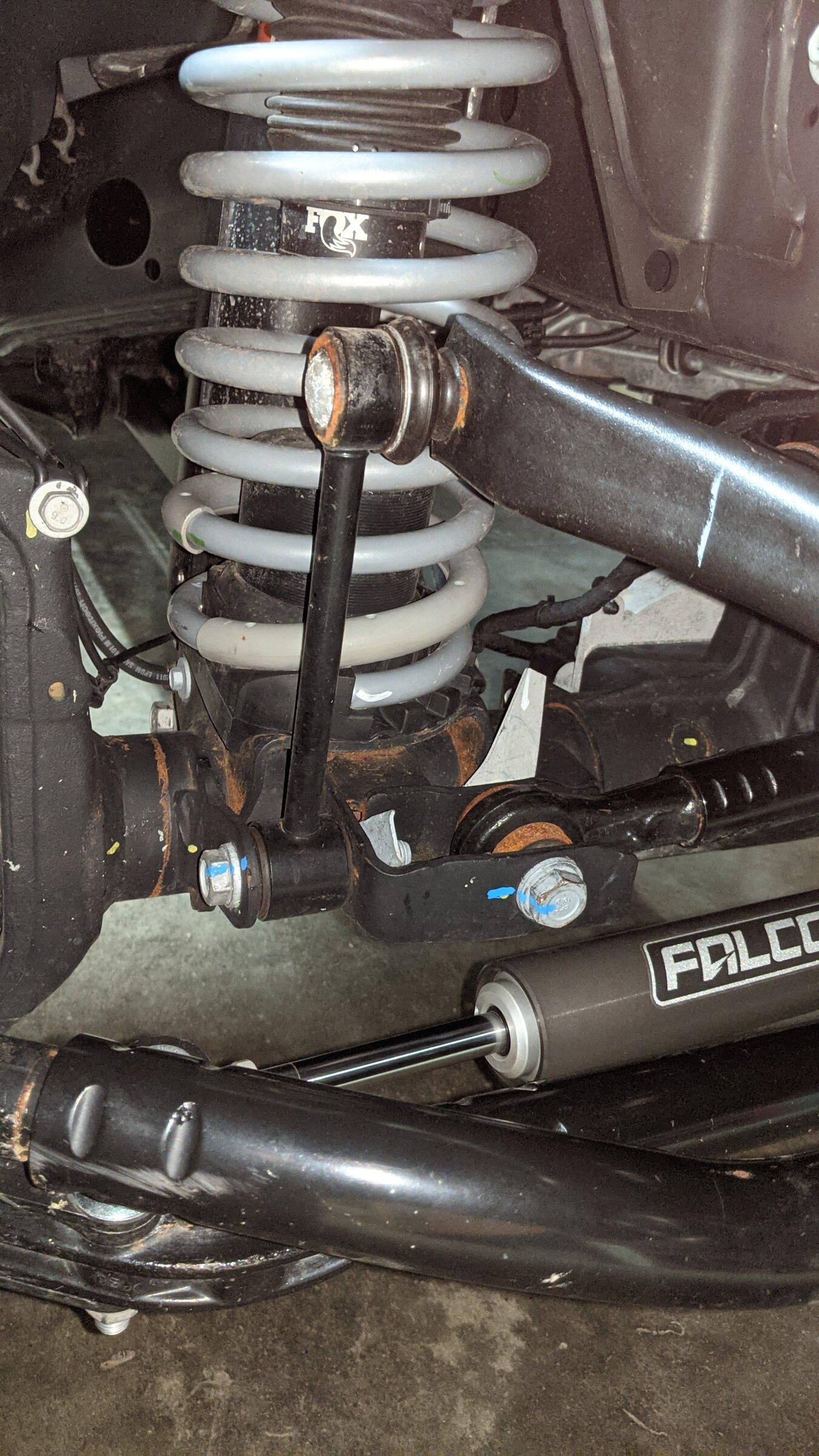

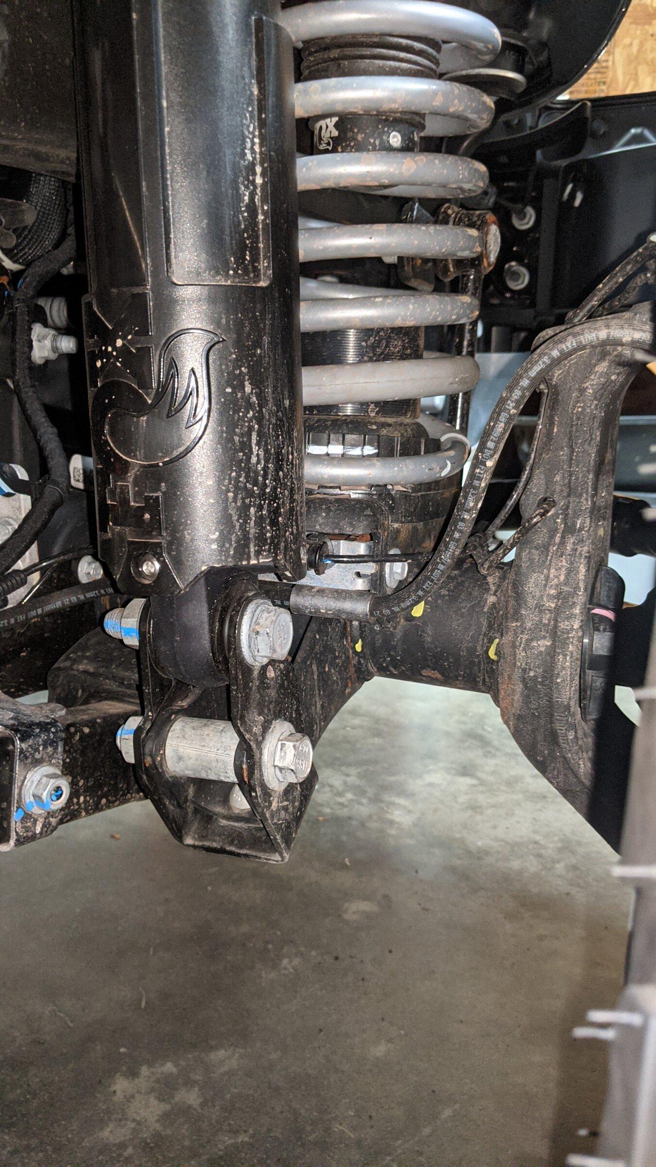

FWIW it looks like you’ve got a spacer on the top of your coil. I have a ‘21 Mojave as well, I put the 2” AEV spacer lift on mine, and it looks like yours has a spacer lift as well.
On the plus side, you’re probably all set to run 37s! But on the flip side, your alignment may not be set up for the stock wheel and tire combo anymore… AEV makes a geometry correction bracket. I have them installed on my Gladiator. Between the brackets and the alignment I got after the lift, it drives better now on 37s than it did stock!

With your clues I checked into the AEV spacers a bit closer.
Viewing this video, it looks like I have the shock brackets, bump stops, and say bar links, but not the driveline spacer.
This gives me some better clues. I'll have the alignment checked when I take it in for the engine light issue.
I'd like to find a reputable shop here in central VA to take it to and have all of the stuff reviewed and correct what needs correcting. I'll begin that search.
I like the lift ads it is, but I want to make sure it's done right and the driveline and steering are all setup the way they should be.

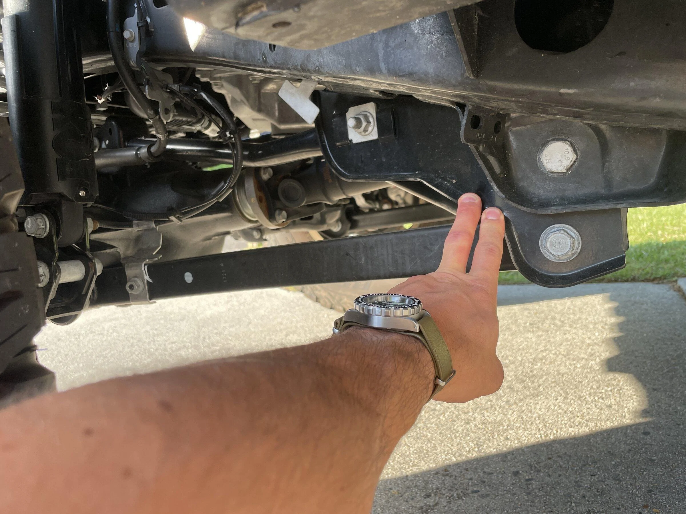

That’s the geometry correction bracket. Totally worth it IMO.
Yeah, I've been reading on it for the past hour or so.
The Rancho looks well built, welded one piece, and a little less money than the AEV at $199.
https://www.extremeterrain.com/ranc...brackets-for-2-to-450-inch-lift-rs62118b.html
This is likely why the damned thing had bump steer and wander to begin with.
Live and learn.
I guess it's a minor inconvenience given all of the extras and the lift, which is also of value when done right.
Did you install the spacers in the drive shaft hanger as well?
