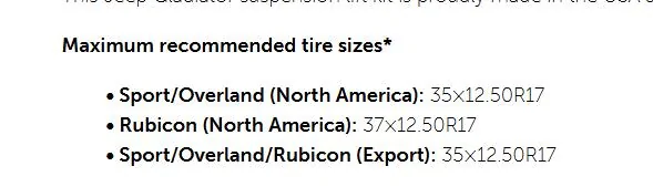

AEV does their builds tucked in. For my 35s, it was a +25 offset and 5.72 backspacing on an 8.5 wide 17 wheel. That's how they spec their wheels and I used those numbers on the Method 703 wheels I bought. Check out AEVs wheels and lifts and see what they recommend for 37s.
AEV https://www.aev-conversions.com/product/aev-salta-xr-wheel-jl-wrangler-jt-gladiator/
Rubicon max tire size works for you https://www.aev-conversions.com/product/jt-2-5-dualsport-rt-suspension/

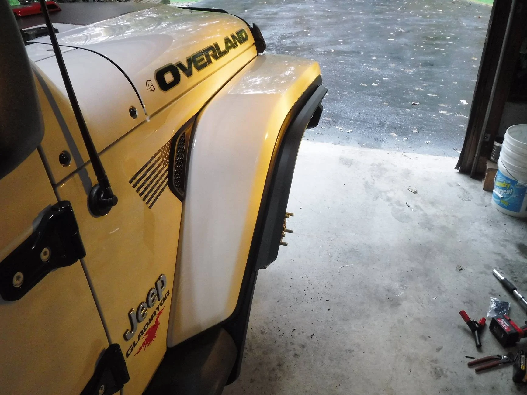

Look at how the JLUXR fenders attach. they come with a slight flat extension. If the extension come off then it can be installed on the JT.

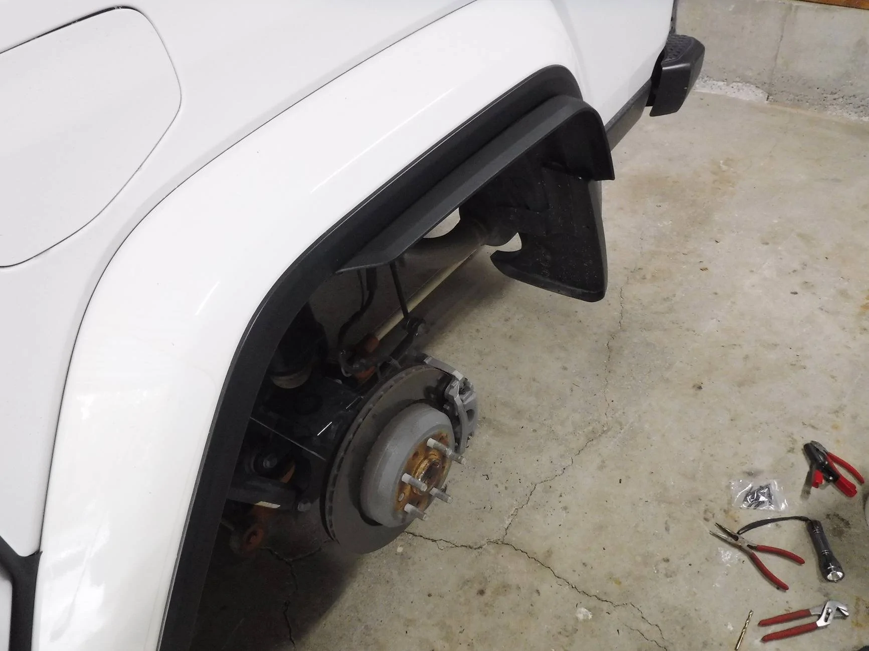

In case you haven’t bought your Wheels And Tires yet, I bought -12, 4+ backspace, fuel covert wheels, and factory 33’s. When I took it to the dealer for an unrelated visit, I asked if it would pass inspection, as is. The answer was “NO”, not in Pennsylvania. I had to seek out fender flare extensions, or figure out what to do with the wheels. At that time, Mopar didn’t offer any. I found a place in Australia, called “double black off-road”. Some people despise fender flare extensions. I’ve gotten plenty of compliments on my rig. Here’s the link in case you want to go with a wider stance.
https://doubleblackoffroad.com/en-u...-fender-extensions-for-jt-gladiator-dbor2aujt

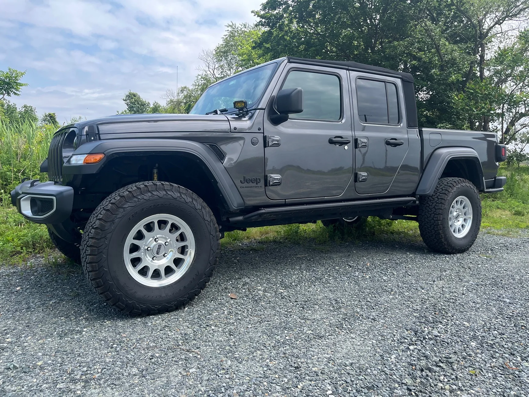

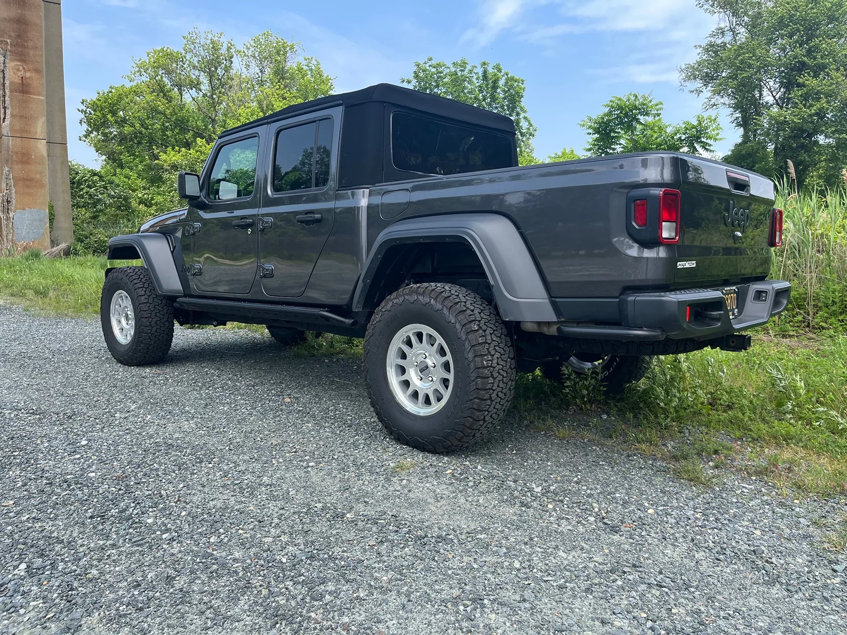

25 offset, 5.72 backspacing. 8.5 wide x 17 wheels. AEV wheels or use their specs (above). I used their specs and bought Method 703 cause I did not want black or gun metal wheels. I used thes in 35/12.5 BFG ATs.

after I bought my expensive, Australian, fender flare tensions, Mopar came out with the Wrangler, extreme recon trim level. They included the fender flare extensions due to the bigger/wider tires.
The fender flare extensions also keep the slop off the side of your rig. That was annoying, until I got the extensions.
