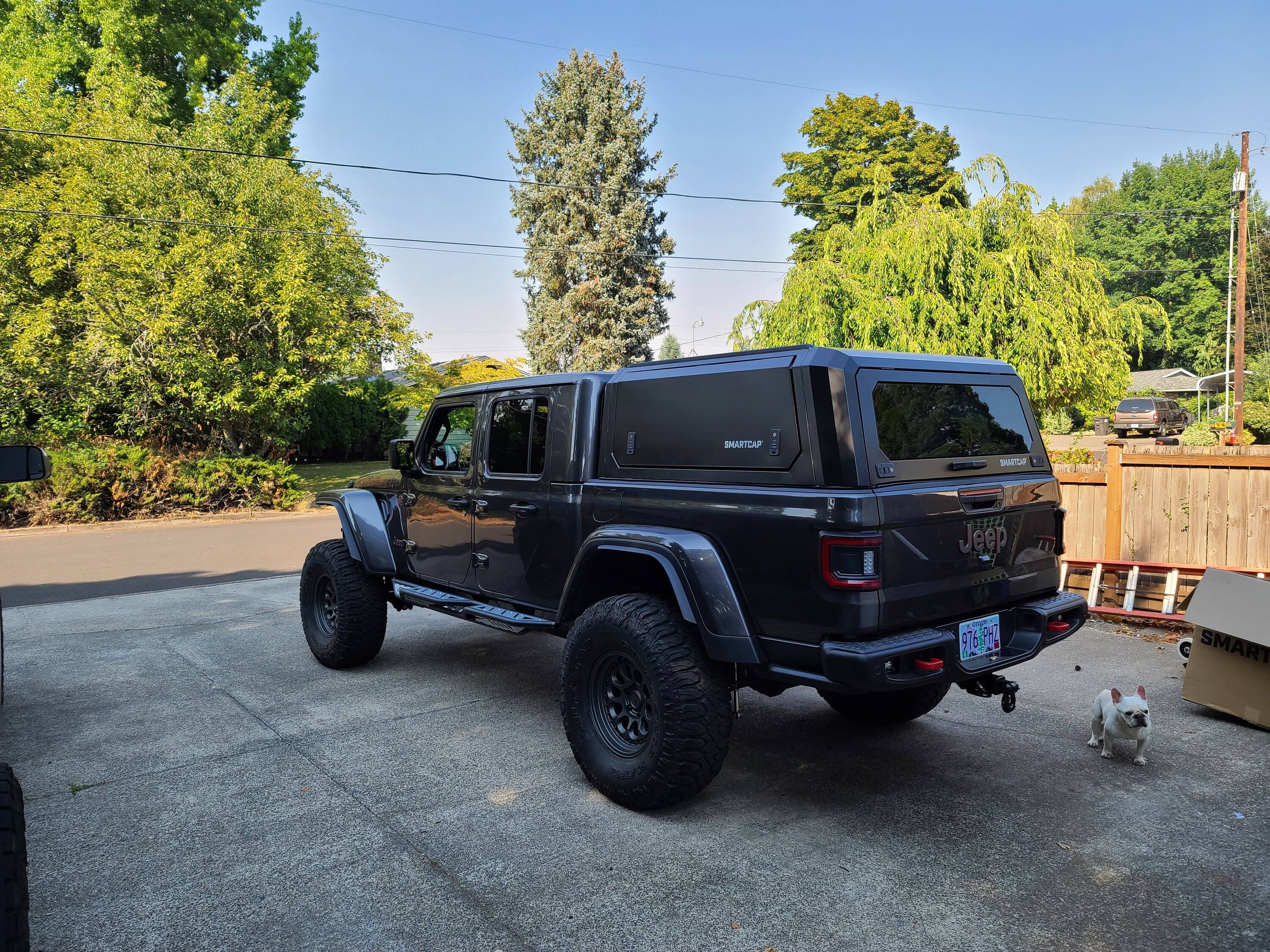

I have a set of Evo 4.5in HD springs i ordered just in case. I am waiting for a RSI adventure cap now, and i have a DECKED drawer system already installed. I wont be overlanding but i will have a lot of off road/outdoor gear always loaded. Just the canopy and decked system is 387lbs, i have a Rock Krawler 4.5in lift now and just with gear in the decked system lowered my rear 3/4in. I will keep this thread posted on what i find out.
Get your cap yet?
Dickster
Jul 9, 2023
725
1,392
Hillsboro, OR
2021 gladiator rubicon, 2022 Ram 3500 6.7L
Sheet metal
Get your cap yet?
I did in fact get it the cap and installed. It sat the truck down a touch more, with Rock Krawler 4.5in springs it wasn't bad. Those springs are super soft buy smooth as butter. Last weekend i Installed the Evo HD 4.5in springs and right out of the box they are 1in taller than the RK springs. They raised the back up 1 in and got the height back I lost. The ride is definitely stiffer than the RK springs but not horrible. They almost felt really springy on my first drive but after a good trip off road the seem to tone down and produce a nice ride. It's not a soft of a ride as the RK springs but IMO those were too soft for me even empty.

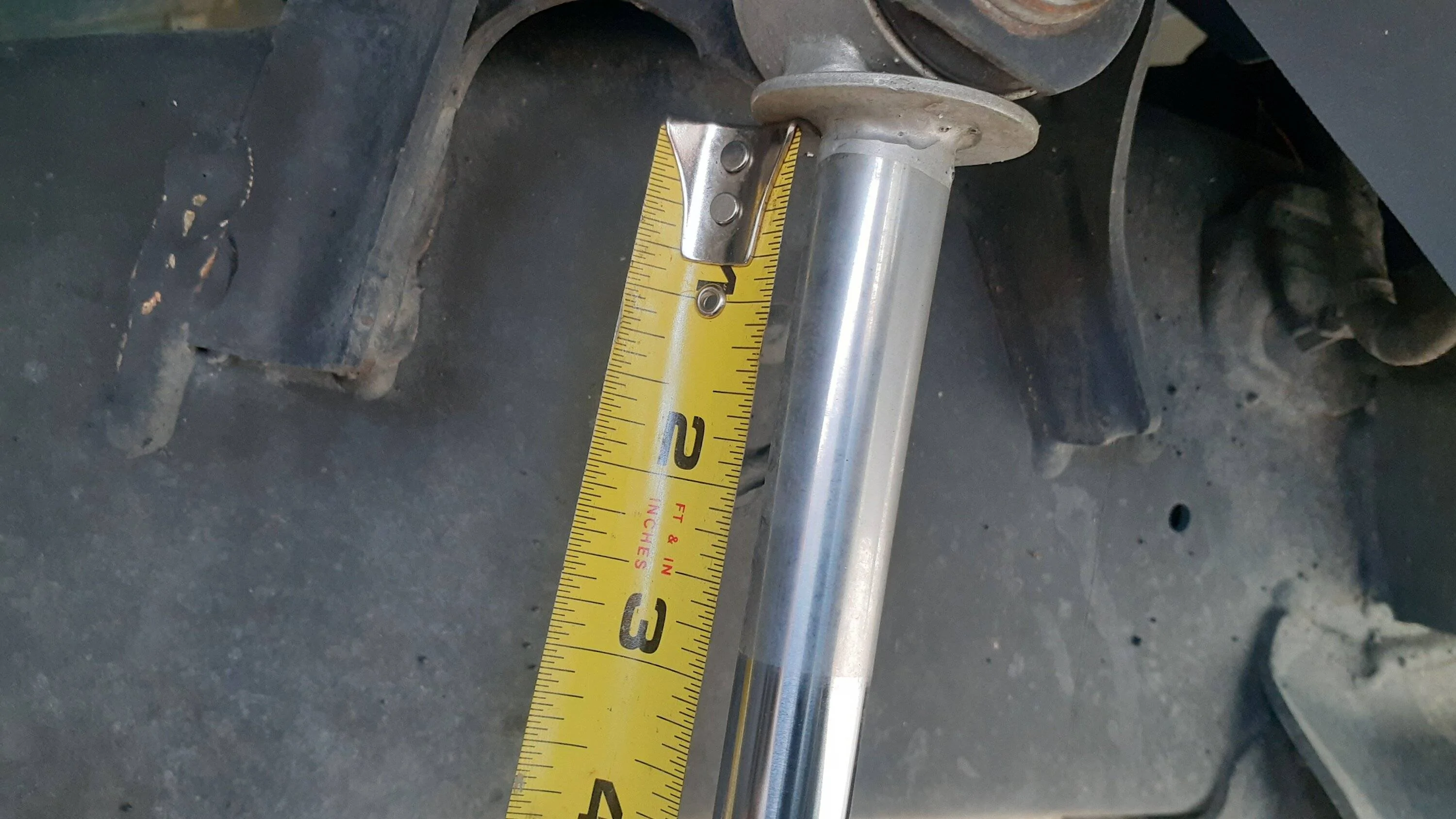

I feel like Goldilocks. Can't find the combo that's "just right."
Hitting decent bumps with 300lb in the bed, I still can't get the rear suspension to utilize the last 3-4" of uptravel.
Jeep Gladiator Those running Evo 4.5 or 6.5" coil springs: HD or Plush. Your experience? 20230908_083406
It may have to come down to custom springs seeing as no one that I've found is advertising single rate rear coils.
I don't think the front end could handle what it would take to get these to compress more than they have.
Evo 4.5 Plush are on their way for the fronts, but it feels like the front/ single rate, rear/ dual rate may be a backwards approach given the weight distribution of the diesel.
For what you say you want @Teqsand I don't think you could do any better than these 4.5" Evo HD rear coil springs. Plenty of spring and a very firm cushion at the bottom.

Testing it out on some jumbo speed bumps with a bed loaded with tools gives a good idea. My current shock setup is temporary and they are not as soft as the factory foxes, but they're not firm either. The Rough Countrys are a decent road shock. For the last 20k+ miles I've had Falcon adjustables and while springs provide a basis whether soft medium or firm, the shocks really determine the ride, especially if you have lighter springs and firmer shocks which is why I run gas springs up front. If I can get the springs through a max available range of travel, then I can tune the ride with the shocks. I had this down well with the other setup but I want more with this and it's basically starting from scratch.
IOW, if I had bottomed out pushing these shocks, there was plenty of room to dial that out with the adjustables and still have a maximum range of travel. Yes there's always a bump here or there that's a little extra and that's what the beefed up bump stops are for.
With the other system, I slowly, gently, and methodically worked my way up to learning its capabilities and limitations and was able to drive it at that level and within its limitations. It was very fun but I wanted a little more out of it and I know the platform is capable of giving it without being overstressed. We're not talking about jumping it or racing in the Baja 500, just running trails with a suspension system that takes the dips bumps turns and whoops so smoothly and controlled that inside it feels like you, the trail and truck are one and riding on a rail. It's a completely different game than crawling up mountains and if the day comes where I run into an IFS guy running out there (cough*Raptor*cough) I want to be ready for him.

There are no aftermarket springs at that lift height that will enable you to utilize the total shock travel. I've pulled my hair out over this which let me to custom springs. The spring with most travel for available aftermarket are Synergy 3in springs. They allow for enough compression to utilize the full up stroke of the shocks, but you'll never reach full ext without springs falling out
