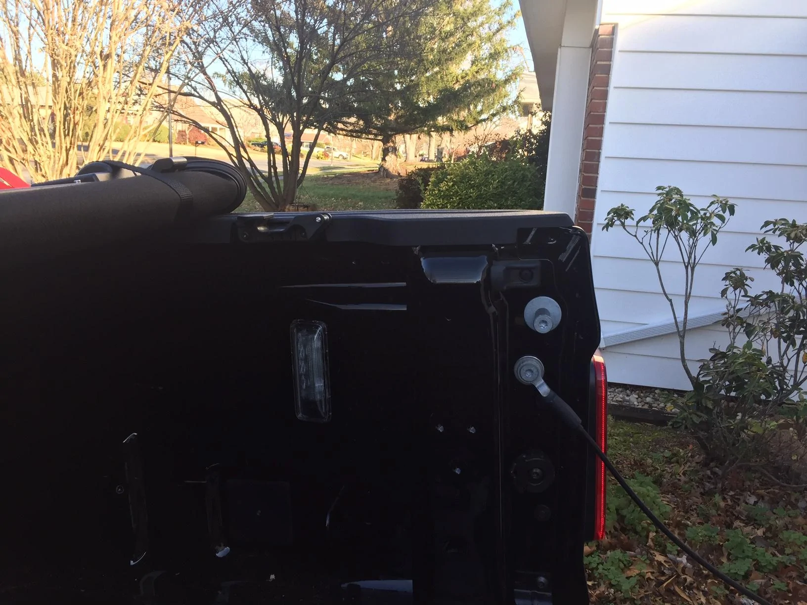

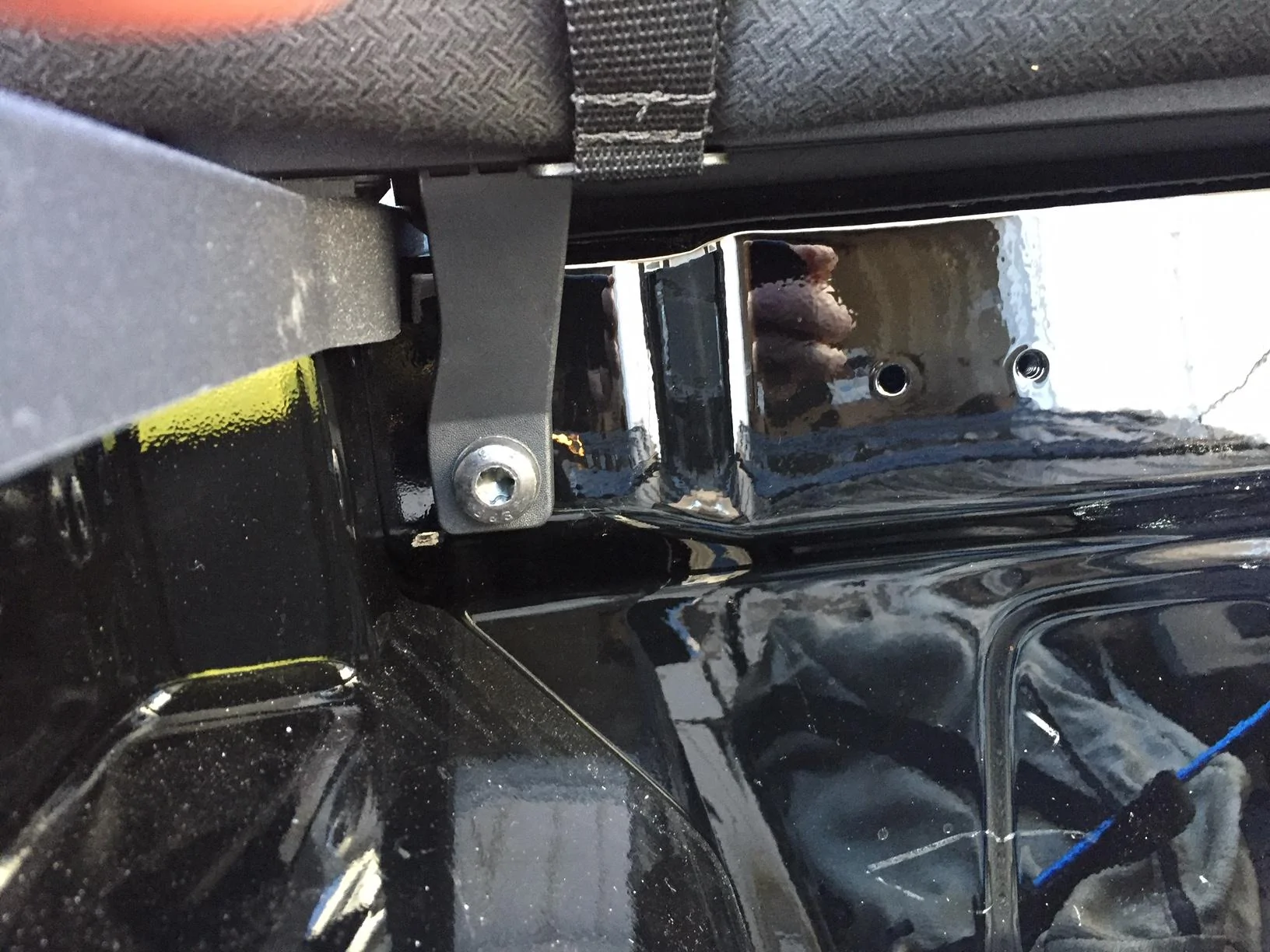

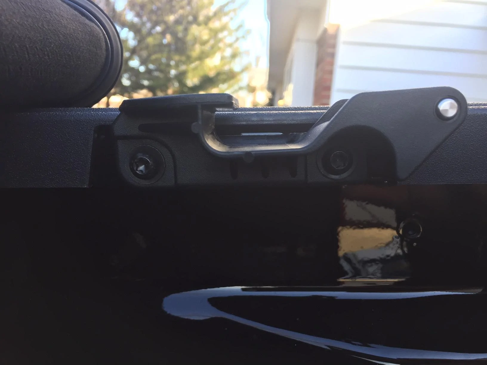

Do all Gladis (including those without the stock Roll-Up Tonneau Cover) have the threaded holes in the bed for the four brackets illustrated in the thee pics below? In other words, will the Roll-Up Tonneau Cover bolt on to a Gladi that did not come with the Cover without drilling threaded holes?

Any information is much appreciated.

Yes, all the factory threaded holes are on all the Gladiators, the rear latch holes are under a cutout cover inside the rail cap, you can see the score lines. The front holes and trail cargo rail mounting holes are also present. The dealer installed by Roll-Up Tonneau cover, no drilling required. Install takes about one hour.

Many thanks for the helpful response! I'm selling mine, as I am getting a full-height Softopper, and just wanted to make sure that a purchaser could use it without too many headaches. I assumed this because, as you can see in my pics, I have various threaded holes in different places in the bed that I am not using.
