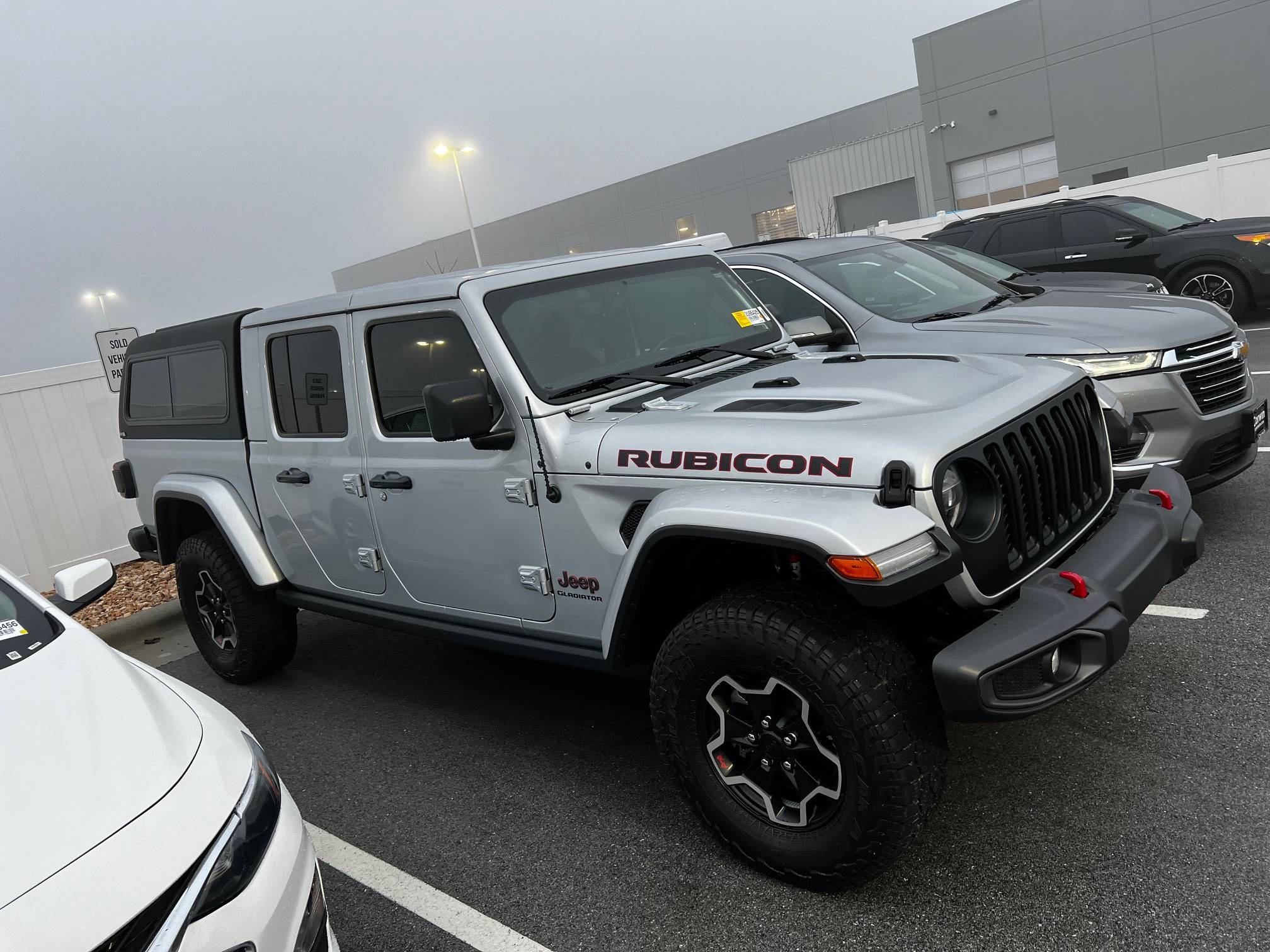

I'm coming to the Gladiator world from a '98 Cherokee that I've been wheeling for about 6 years. I am an adult with my own kids, but my father and I have done a ton of 4x4 trips to CO and Utah in my '98 Cherokee. As he is getting older, we decided to split the cost of a newer jeep so that we can keep making memories with more comfort and reliability. I'm pulling together my "build plan" so I figured I would ask you guys.
I am starting with a lift, tires, and bumper/winch.
Lifts - I am leaning towards the AEV dualsport lift with 2.5 in springs. Should I add track bars too? I'll be running moderately challenging trails in Moab and Colorado, doing overlanding style camping trips, and hauling a dirt bike on a rear hitch carrier. I want to be able to fully flex 37s. Any other lifts I should be considering?
Tires/Wheels - 37 inch BFG KO2s are my plan. I learned recently that they are "small" 37s but I really like the tires. I've also seen some milestars which seem to have mixed reviews.
Bumper - I am sensitive to aftermarket bumpers that fade / rust. I plan to keep this jeep for 10+ years. I am leaning towards OEM or ARB. Does anyone else have comparable quality? I'd love the AEV bumper but the gucci pricetag is tough to swallow. I'm looking for something simple and functional that retains the factory LEDs if possible.

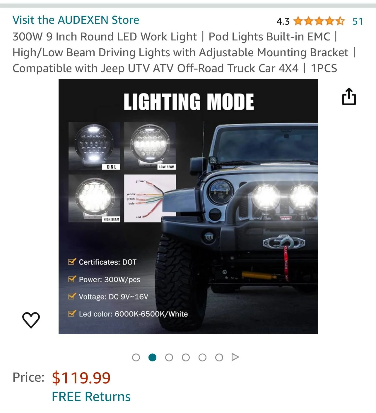

Lights - I'd like to add a few lights round lights. Does anyone have a recommendation on quality LEDs? I don't want to buy cheap Chinese ones, but some of the name brand seem pretty dang expensive.
Skids/Rock rails - How do the rock rails perform? With how long the truck is, I'm thinking they'll get some use.
OEM metal bumper can become a stubby.
OEM are excellent. Multiple layers and bedlined.
I am really watching facebook market place for an OEM take off, but I think I am leaning towards the OEM stubby with some sort of bracket for lights. Great to know on the rock rails.

Lights. As you have found out, prices are all over the place. Quality name brand lights are going to cost. There is a reason. A $35 cheap China knock off that you have to replace every year will still be cheaper after 10 years. IDK, it's hard to spend my money on lights that seldom get used.
Agreed on the tires. I am pretty much set on those. I've had them on the Cherokee forever and they have taken an absolute beating on rocks. I'm hoping that with some method wheels my whole package will be the same or lighter weight.
I don't think we need lights, but my dad wants two round ones on the bumper. It is half his jeep and we are splitting the mods, so I'm just trying to find the best solution for him.

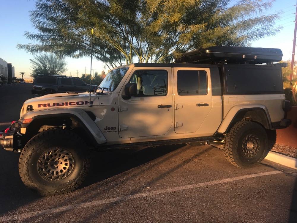

@texanincolorado I'll throw you a curve ball regarding lifts. When I bought my 2020 JTR, there weren't a lot of lift options out there. AEV and Clayton were the only two and neither had even started producing the taller or HD versions. So I had an "epiphany", I reasoned that this is a truck and there is a shop here in town that builds trophy trucks for desert racing and such; so I figured I'd go talk to them and see how they would do a Gladiator.
Now mind you, I currently own two JKUR's, one with an AEV Dualsport and one with a MOPAR lift and am familiar enough with them. But this shop suggested ICON, which I decided to put on my JTR. I have been extremely happy with it and think it rides better. In fact, I'm contemplating swapping the AEV on my 2016 JKUR over to an ICON.
Here's what I like about the ICON setup: it can be done in stages and there are 8 stages to choose from. If you want to start out small, moderate or full, there is a kit avaialable (8 of them). And if you started at say a stage 4 and later wanted to move up, you just add the parts that turn it into a stage 6 (for example).
I'll admit that they are proud of their products; I believe the Stage 6 which I am running is now around $4300. However, I think it's the best offroading suspension I have ever run in 40 years of wheeling and more than enough Jeeps to last a lifetime.
Anytime I see the lift question come up on this forum I see MetalCloak, MOPAR, Clayton, AEV, and all of the usual suspects but I think that is because those companies are so closely a part of the Jeep culture that offroad shops don't tend to deviate from them which means that those are the companies that people are familiar with. And before I get "the hate", they are all good companies with good products and I'm not trying to sleight them. I'm just saying that if I had reached outside of MY comfort zone 10 years ago, my current stable would all be wearing ICON suspensions.
Food for thought...Cheers!

Thank you for this suggestion. That is a strong endorsement. ICON is highly regarded in Ford world (my DD is an F-150) so I'll have to do some research. I definitely value the opinion of someone who has had multiple experiences with similar platforms and is actually wheeling their jeep. Everyone uses these jeeps differently and I've had a hard time sorting through reviews to understand what is best for my use case.
And for what it's worth, here's a shot when I picked it up:
Jeep Gladiator Tips on a new build (2022 JTR) 01_LiftedGladiator
2.5" lift on Toyo R/T 37's. I did have the shop work with Deaver Spring to make custom rear springs to handle the weight of my overlanding build. But you can see the 37's have plenty of room with those Rubicon highline fenders. I have yet to run up into the fender wells.

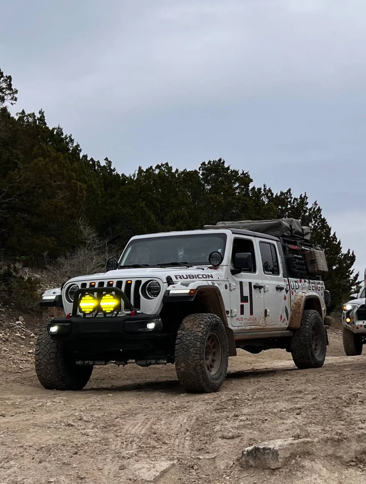

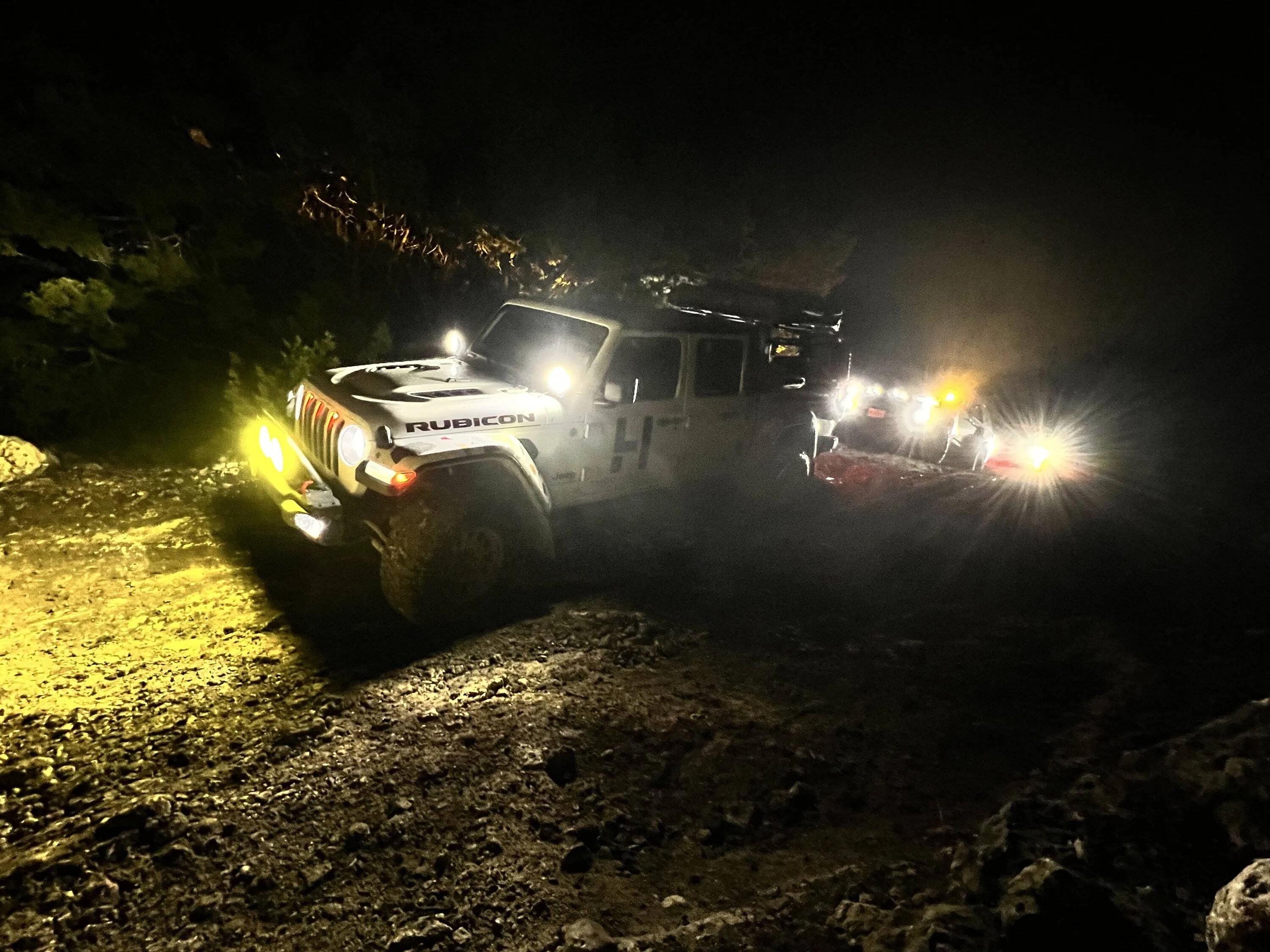

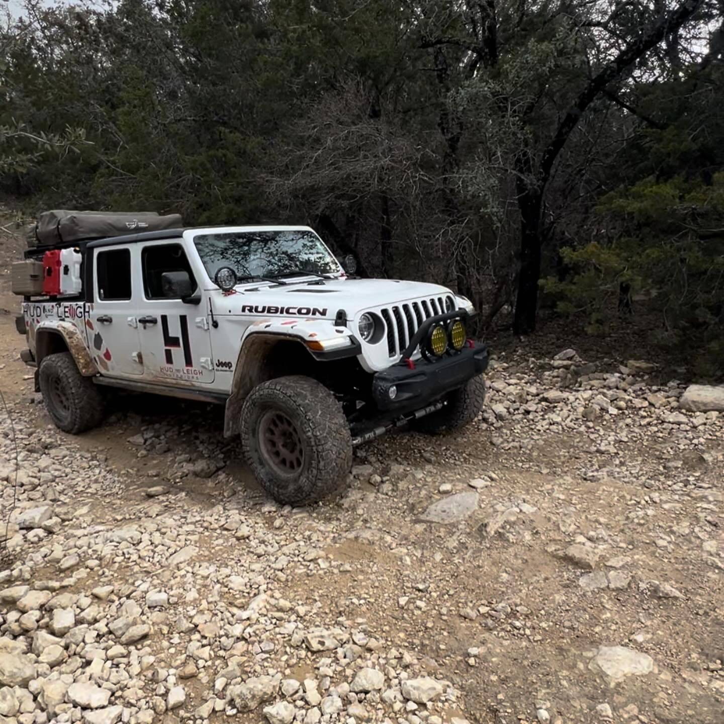

Wish I had a better photo showing the beam pattern on the lights but you’ll see that I put a film over them 1) to protect them from rocks on the trails 2) cause we were on dusty trails before getting to our destination. All that being said I’m with you on the lights and not needing them that much so I bought some on Amazon… I know you said no cheap brand but I wasn’t about to drop the money on Baja designs at the moment and find it hard to spend that kind of money on something that I so seldomly use. These lights have served me well for a little over a year and have had no issue. I didn’t feel like having the drl so I just wired the “high beam” into the provided aux switches in the JTR. Needless to say, im happy with the purchase of these. The few times me and the guys go out and are still driving into the night they put me up front.
