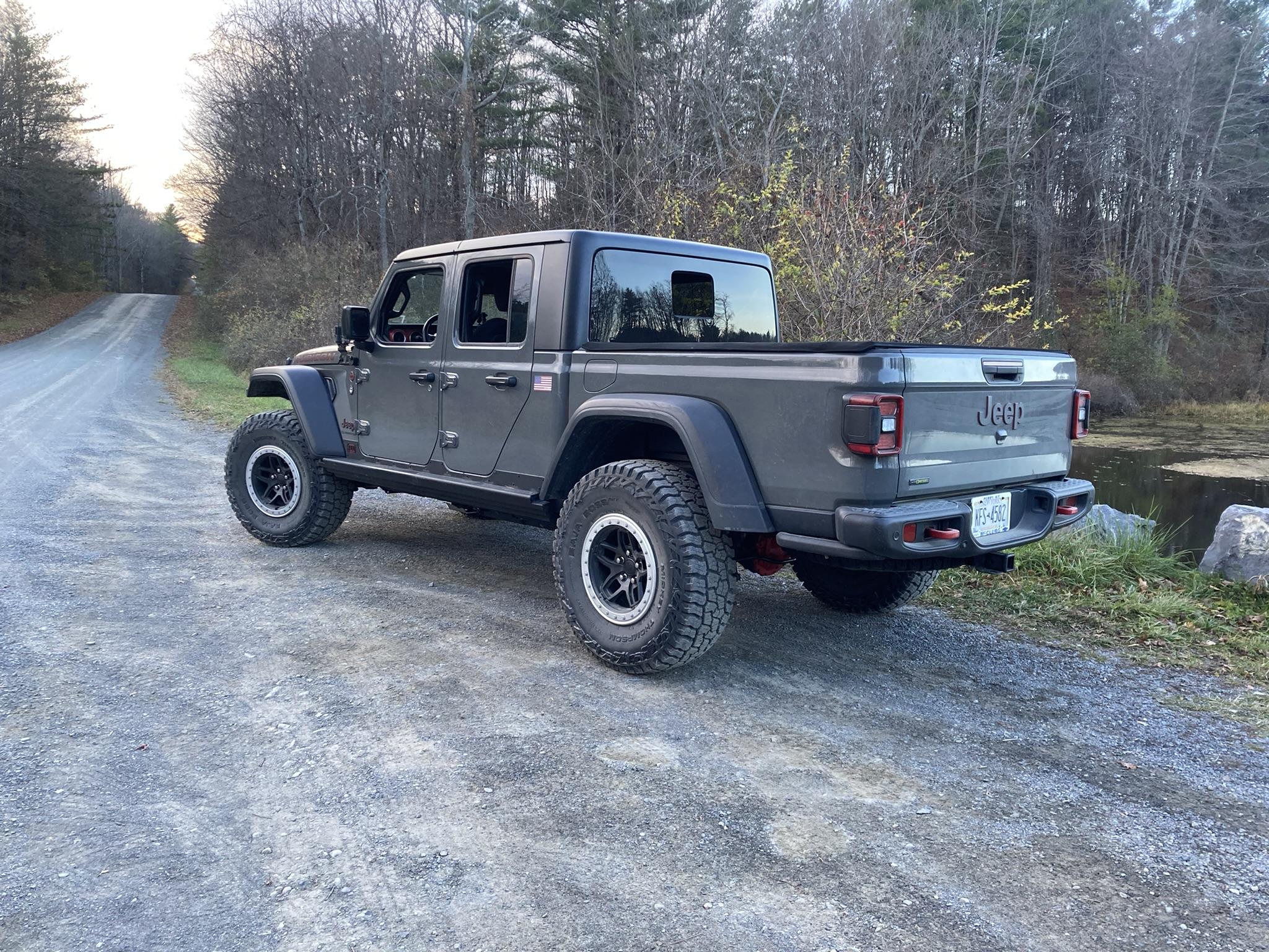

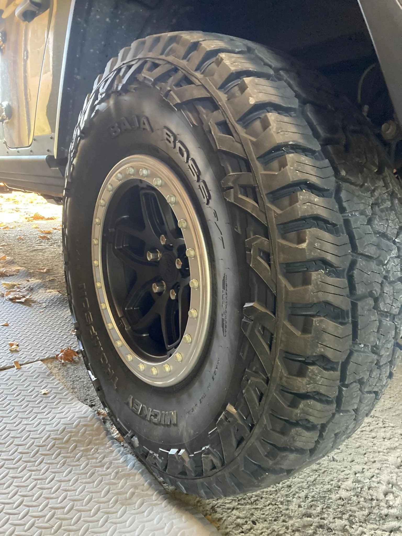

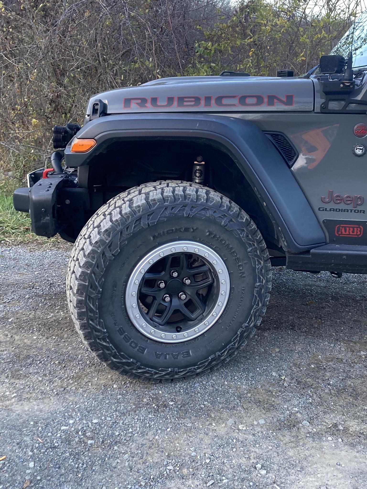

Thanks for those, and very nice! Looks good, i wanted to see those wheels, the MT's are bitchin...
John in the Woods
John in the Woods
Jul 20, 2020
32
681
1,415
Finger Lakes
2021 Gladiator Rubicon Diesel
Thanks. I love the tires and the wheels. In hindsight, I wish I would have ordered the dark gray protection rings. The rings are great, but the silver ones pop a little too much for my taste. I'll probably paint them at some point.
