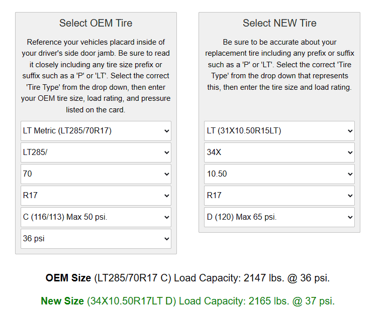

37 is high.
Why not use a GPS or speedometer app on your phone?
I used GPS and drove several miles, then compared the truck odometer to the GPS trip tracker and got it spot-on.
Heck, even the stock 33s on a Rubicon are only 36 psi, I'd not run a larger tire with more PSI.
