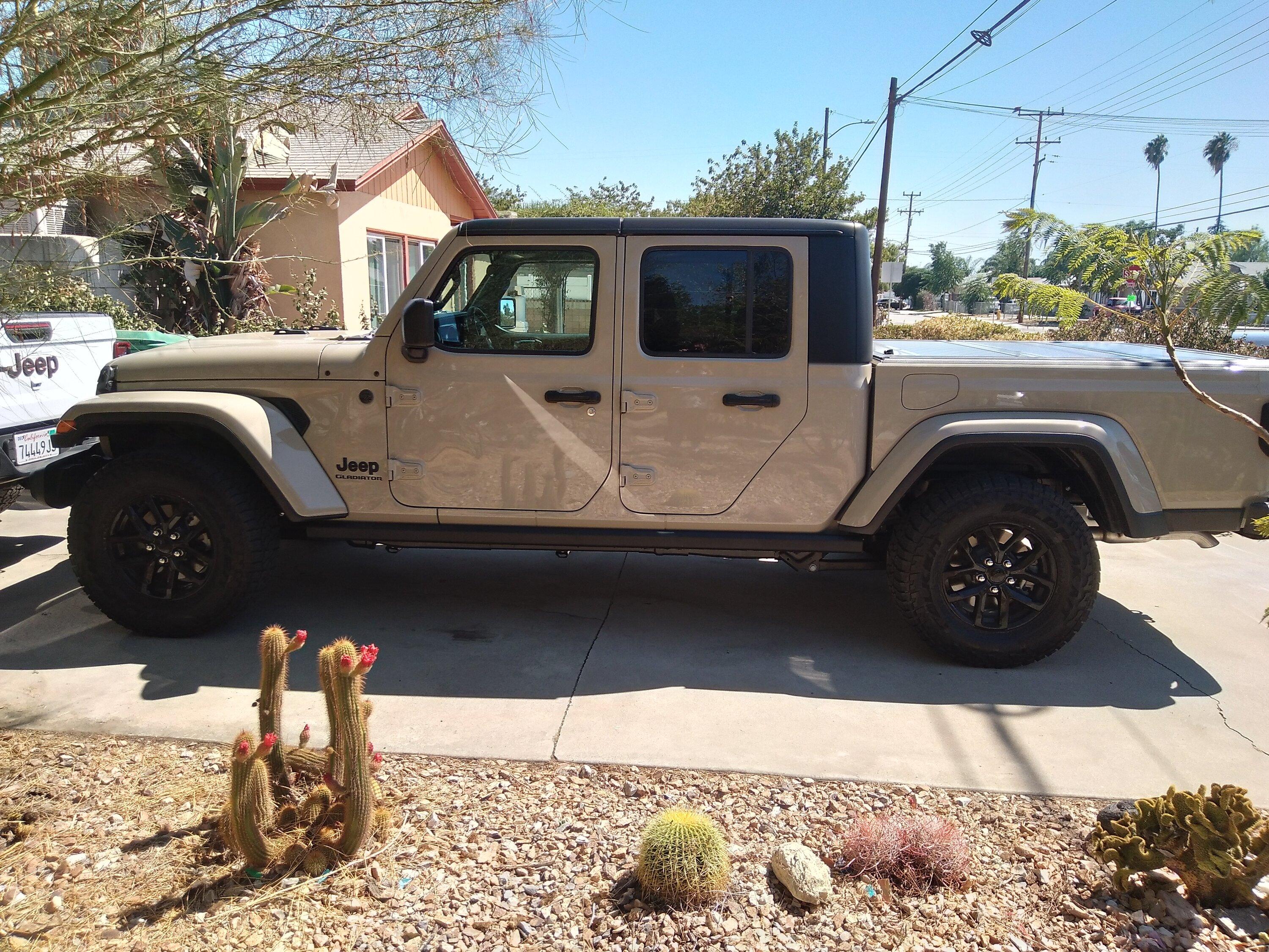

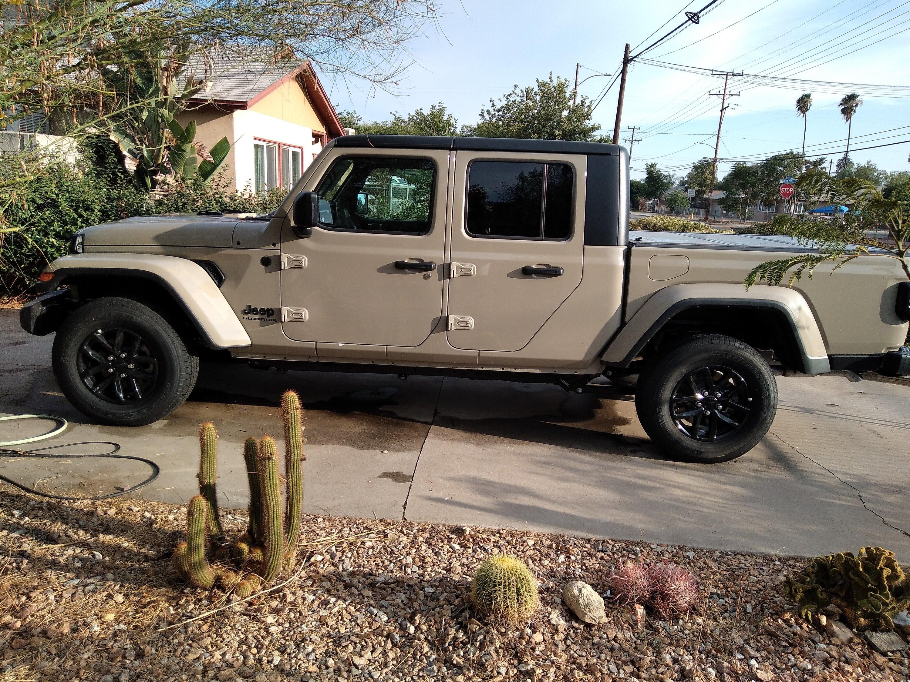

So today i switched from the 32 inch stock duelers on my Sport S to Falken 33 inch mojave take offs. The speedo seems accurate, i went to my dealer which was a joke. A child had to ask another guy if i should flash the PCM for the new tires and he said they dont have the tool to do that. That is strange because they are reporgramming the Mojave PCM because of a recall Tuesday. Then when i asked if the change will effect my shift points the guy says maybe i should go get it regeared... i said when i switch to 35s or 37s i will regear it and who can i email at jeep to get a price for a regear to 4.88s. He tells me they dont do that because its not factory specs... Long story short ill take my free oil changes but probably wont be getting work dont there. Still wondering if the tire change will really change much on how the Sport shifts. So far it seems to drive fine just a small loss in pep but i think thats due to the larger footprint on my wider tires. The pizza cutters actually peeled out a little.
