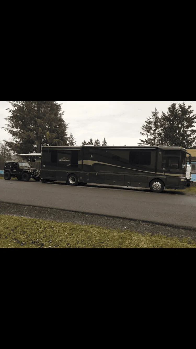

I tow mine. No battery disconnect, but I do have the Genesis dual battery system. Maximus 3 tow loops with a Blue Ox tow bar.
I'v toad my TJ behind mine. How does the JT feel?
Jeep Gladiator Toad MH &TJ

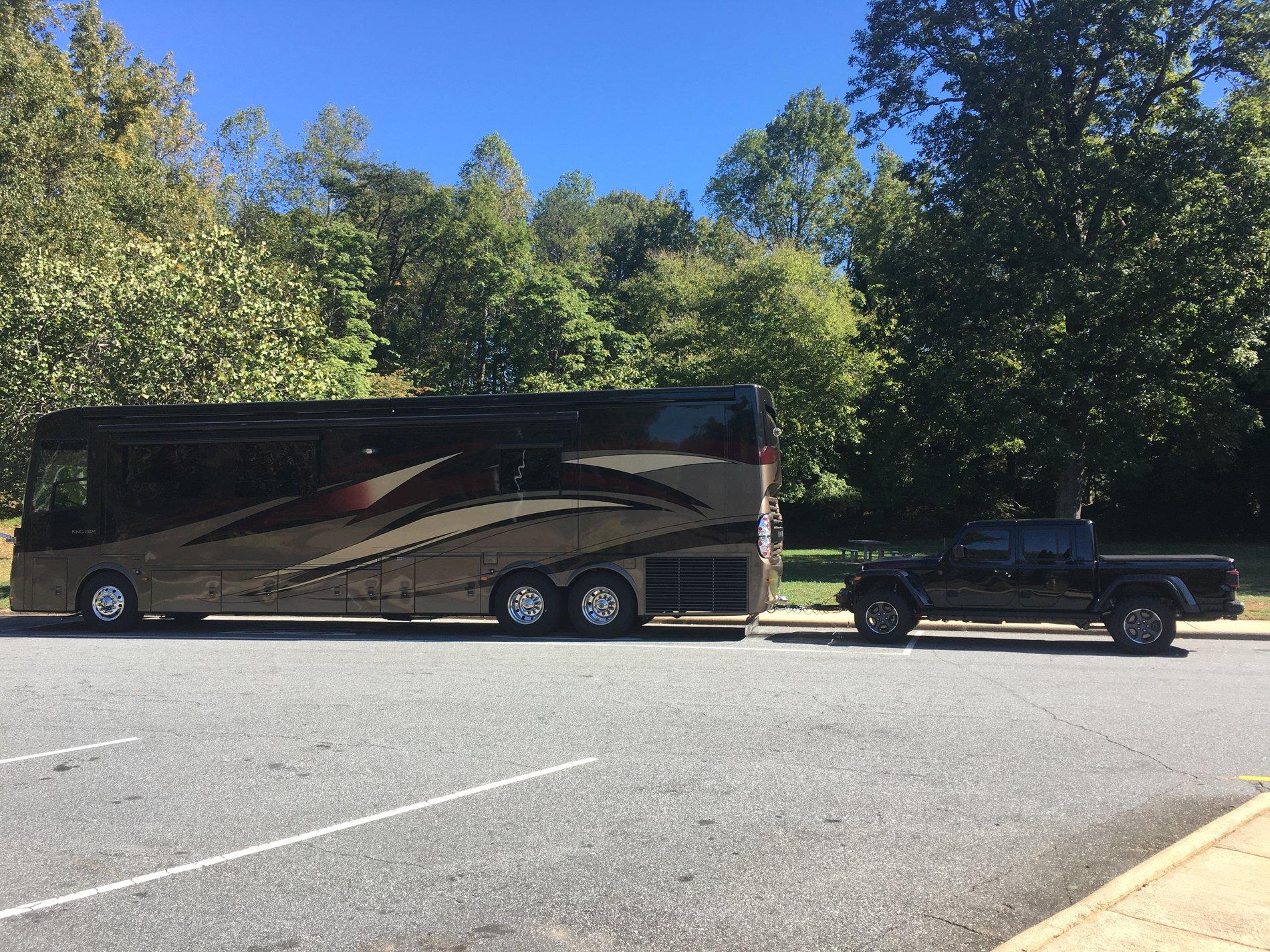

I used to pull my TJ Rubicon without knowing it was there, but with the JTR's extra weight and length, we don't know it's back there either, but we are 54k lbs, so I doubt we will feel anything anyways.
Gotta love being the fat boy sometimes...

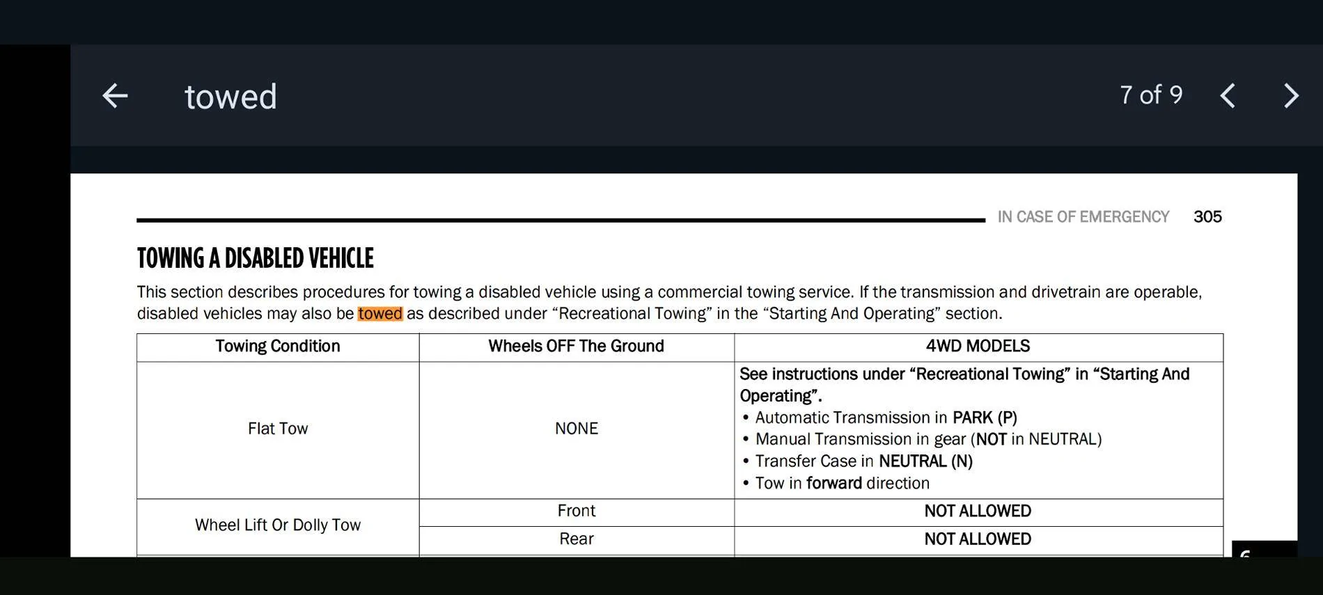

We flat tow a 2020 Gladiator (Overland) behind a 2021 Dutch Star. We disconnect the negative battery cable and each time we flat tow the "auto start/stop" feature is disabled. Each time we took the Gladiator to our local Jeep Dealer to reset the fault. They don't know why the book says to disconnect and we are working through a process with them to try and ID why the "auto/start feature" is being disabled. It would be nice if Jeep could figure it out.
