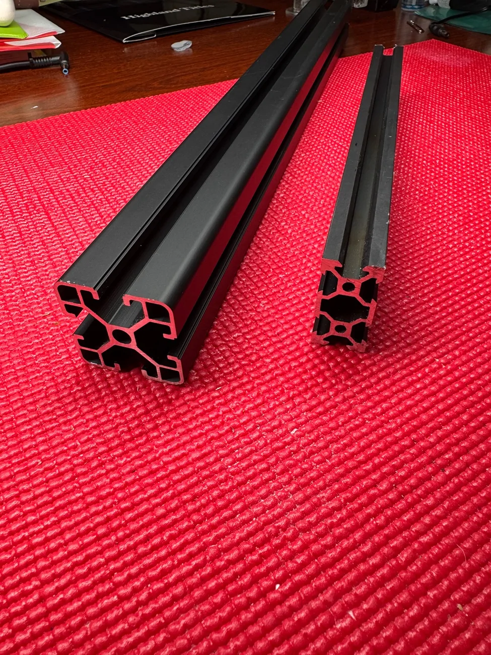

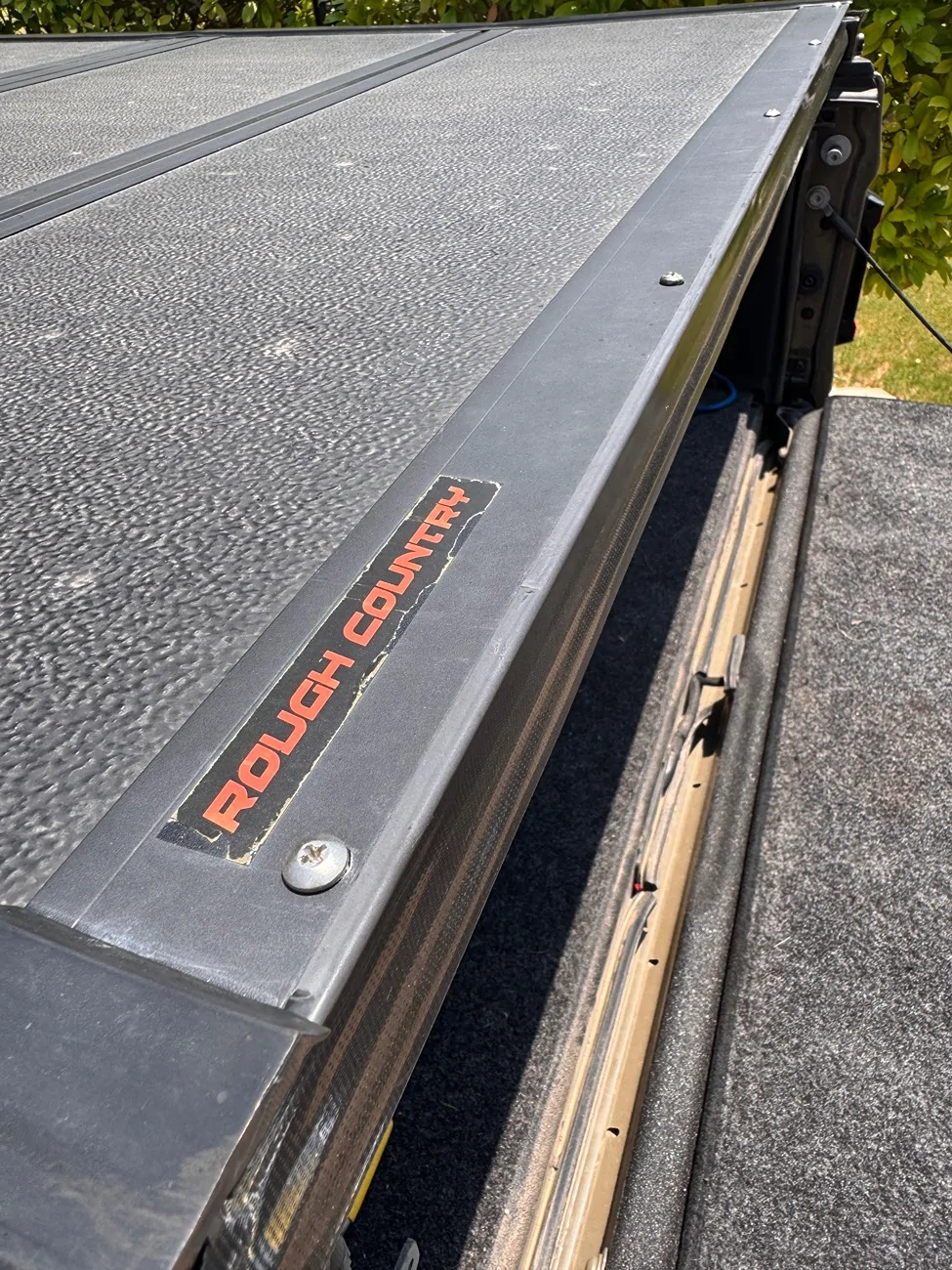

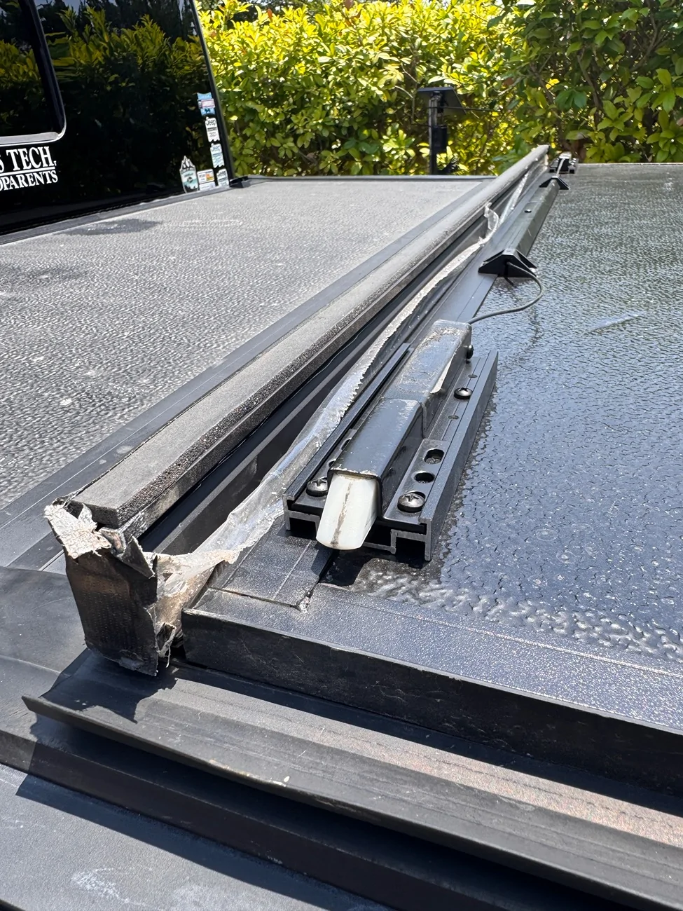

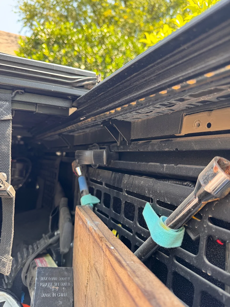

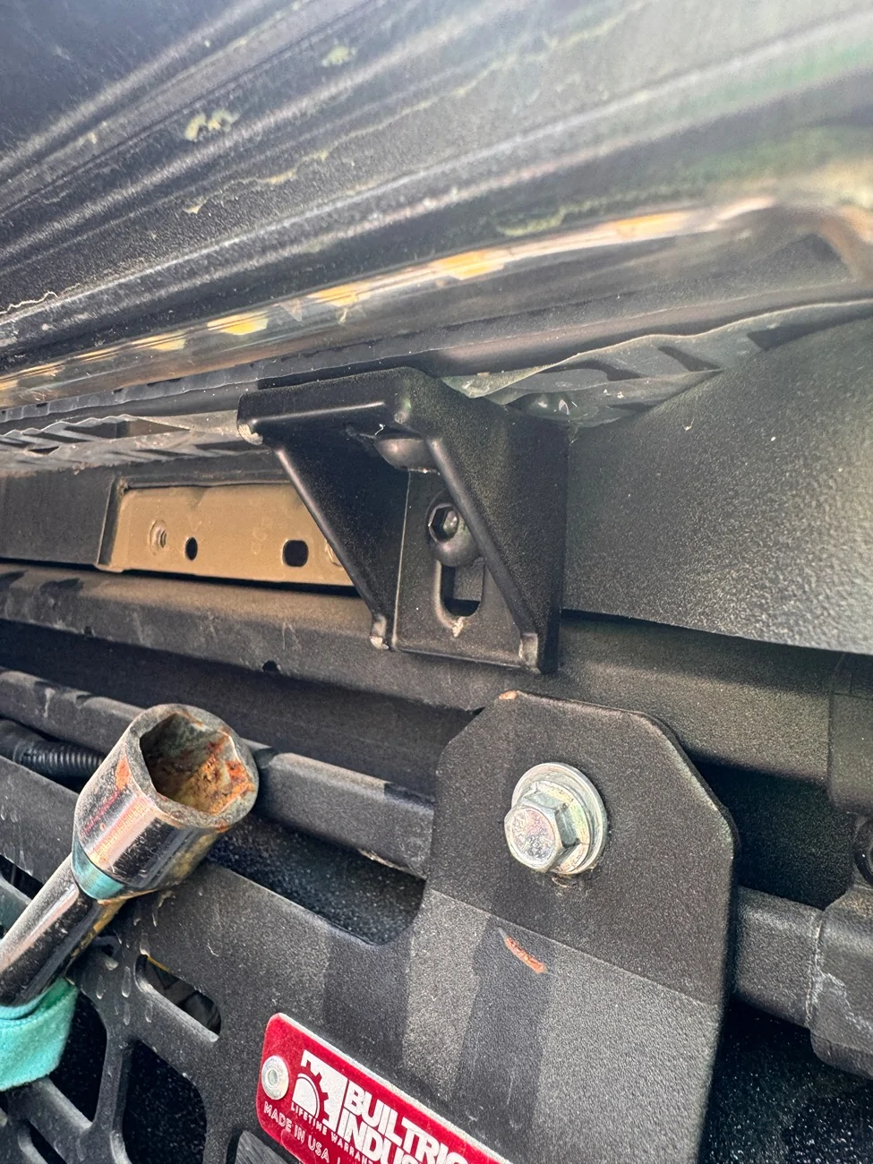

Hey, no problem! I appreciate your input and sharing your project. I had thought of doing the extrusion approach several years ago, but I couldn't figure out how to do the tailgate end. So I didn't do anything. Then two months ago, I thought about just adding a piece of rubber block or flap to the tonneau cover to fill in the gap. I would have just glued the rubber block to the cover end, but I couldn't find anything that worked. Then I decided to just use a 2"x1" extrusion on the end with a piece of rubber foam to create the seal on the tailgate. I did drill some holes thru the tonneau cover end flap but I can always fill those with sealant If I change it back. I did have to drill holes thru the bed rails themselves to mount the extrusion. That worried me, but I can also fill them with plastic plugs if I remove it. I added some pictures of the extrusion and the mounting method. Thanks again for your input.

Thanks to Exceed Fabrication post, I realize I unintentionally included some built in attachment capability on the outside of the extrusions running from from to back. I could add some mounting points anywhere along the rails for brackets or tie down points. I could see even add some raised rails to run across the cover to create a frame for bikes or a tent. Thanks Exceed!
You're welcome! Yes, the aluminum profile's built-in T-slots allow for countless mounting points!
