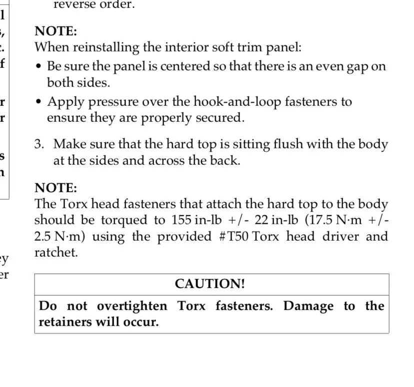

What's the torque spec for the 8 torx bolts that hold the top/roof on the JT?
I can't believe it's "tighten until it quits moving" when this top is not even a metal of any sort - it's more like plastic or fiberglass or resin.
When you have gaskets and seals involved, if you tighten down too much you distort things - you squish out the gasket and warp mounting points.
Not tight enough and then you have other issues - leaks, rattles, moving/shifting/wearing parts.
Jeep in Ohio must have had some spec they told employees to apply to those - any ideas?

Looks like the owner’s manual says about 13 ft-lb. Seems to be just over hand tight.

I have the PDF copy of the manual and looked but OBVIOUSLY, I missed that entry. Didn't feel like digging out the print version that came with the truck as I figured if I didn't find it in the PDF - then the print version, a rev older, wouldn't be better. Guess that was wrong, too!
OK, thanks - I'll get out my inch/lb wrench. Out to the shop to get my torque wrench, back to the garage to finish putting it back together.

I know when I removed them I thought - these are pretty tight...... and putting them back, it's pretty tight, but then they give a huge +/- 22 inch/lbs.

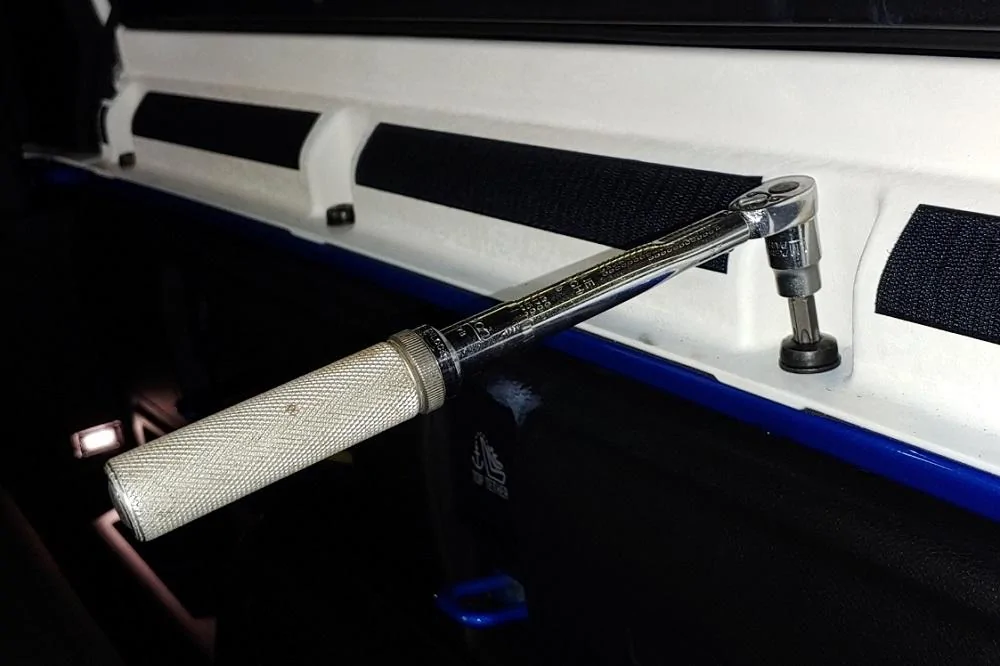

Lest anyone think I was joking, I did pull out my Snap-On inch/pound torque wrench ;-)
It's a necessity when doing transmission and certain other work. I think it's time for calibration, though, or else my hands need re-calibrating. I used to be able to tighten certain things and others would check me with a torque wrench and I was usually pretty darned close. These days, not so much.
