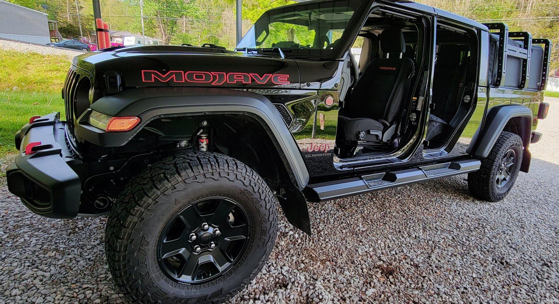

Which rock sliders are you replacing the stock rails with?
I put on LoD rock slider steps but I didn't realize that I didn't need to take these bolts loose until it was too late.:facepalm:
So now I'd prefer to just tighten the few turns it has left and never touch it again. But it's really difficult to tighten or loosen. I'm not a pussy either. The nut/wing whatever I think is fine but I think the threads are just trashed.
I don't want to ruin your day but it looks like you have them on the wrong sides. The bigger step opening should be on the fronts to match the larger door opening...see the LOD pics for this. Not sure if this is contributing to your problem
Lol
I think you are right. Luckily I think I can swap them easy tomorrow. Stubby ratchet wrench for the win.
:facepalm::CWL:

I finally got that front one tight today. I kept putting it off for fear I'd just get mad and break it. It got really tight then loosened way up, I figured I broke whatever was inside. It went from can barely turn it to being able to use one finger. Then it just snugged up like normal and I'll never touch the dammed thing again.
