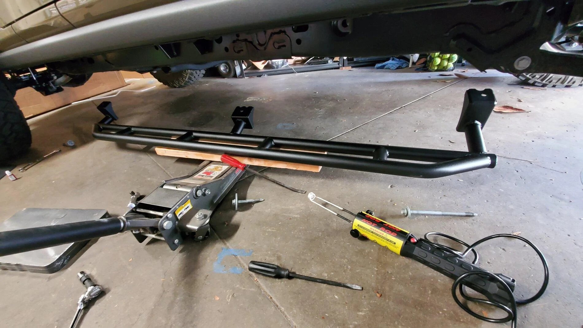

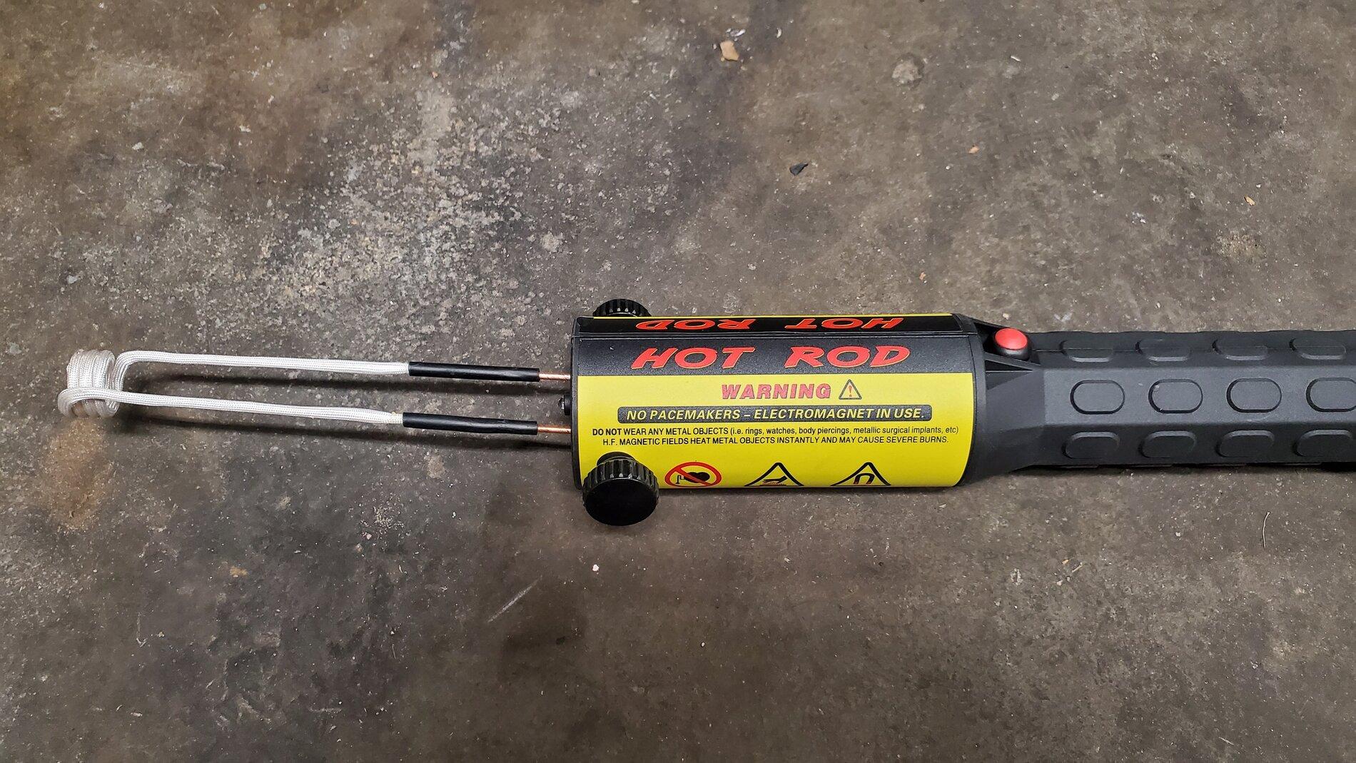

I removed all my body mount bolts with a long handled ratchet, no impact tool. Greased the threads on the new grade 12.9 allen bolts I installed with the Rock Hard sliders. The point is this--if the tech is careful and does not use an earthquake impact gun, etc. he will not just break them off. The induction heater is a good idea too, but I did not use one. If the installer saw missing bolts, he would have told you before starting, so he would not have been blamed later. Since he did not, it is a very big indicator that he broke them and is trying to slide out of blame. IFAIK no one else has ever reported that their Jeep was missing any of the body mount bolts. A number of owners reported breaking a bolt if too much violence was used in removing it.
Induction heater for the win. This exactly how I installed mines.
