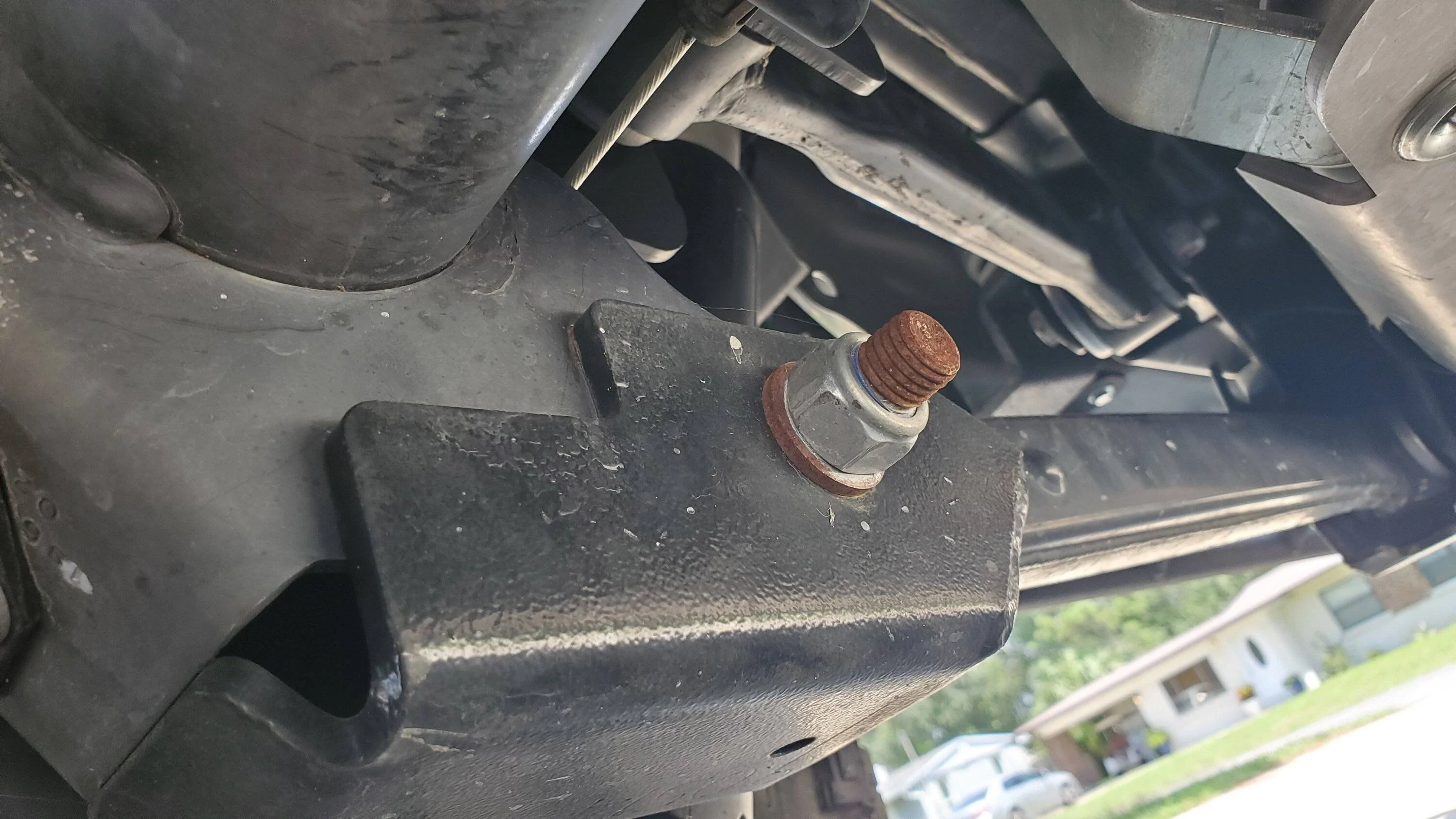

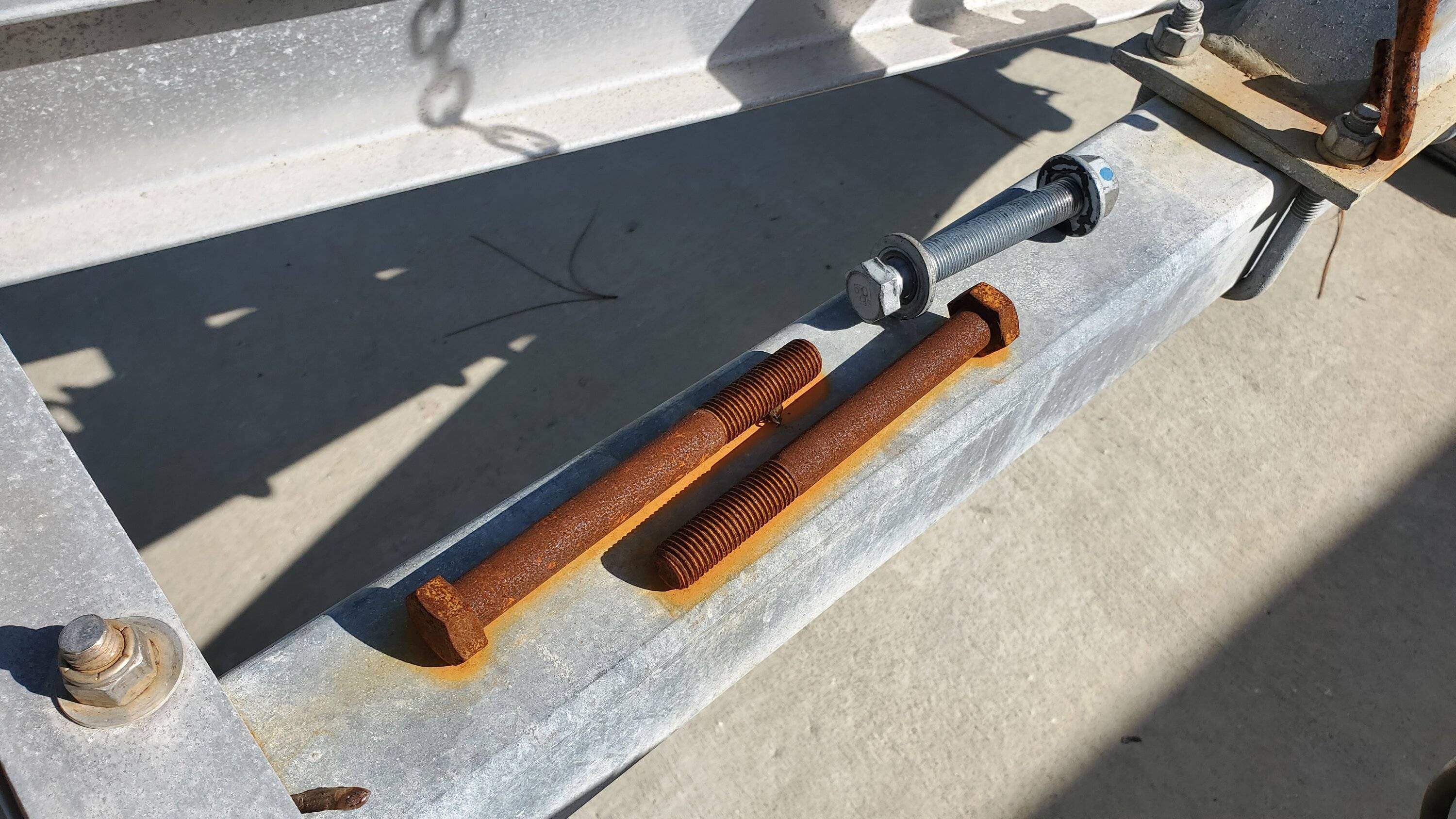

And now that I see @Pliny paid $100 before shipping in 2024 for new bolts for the lca skids, that may change what skids I buy in the first place. I'm not sure if that covered bolts for the shock mount skids.
Belmetric is where I order metric bolts from.

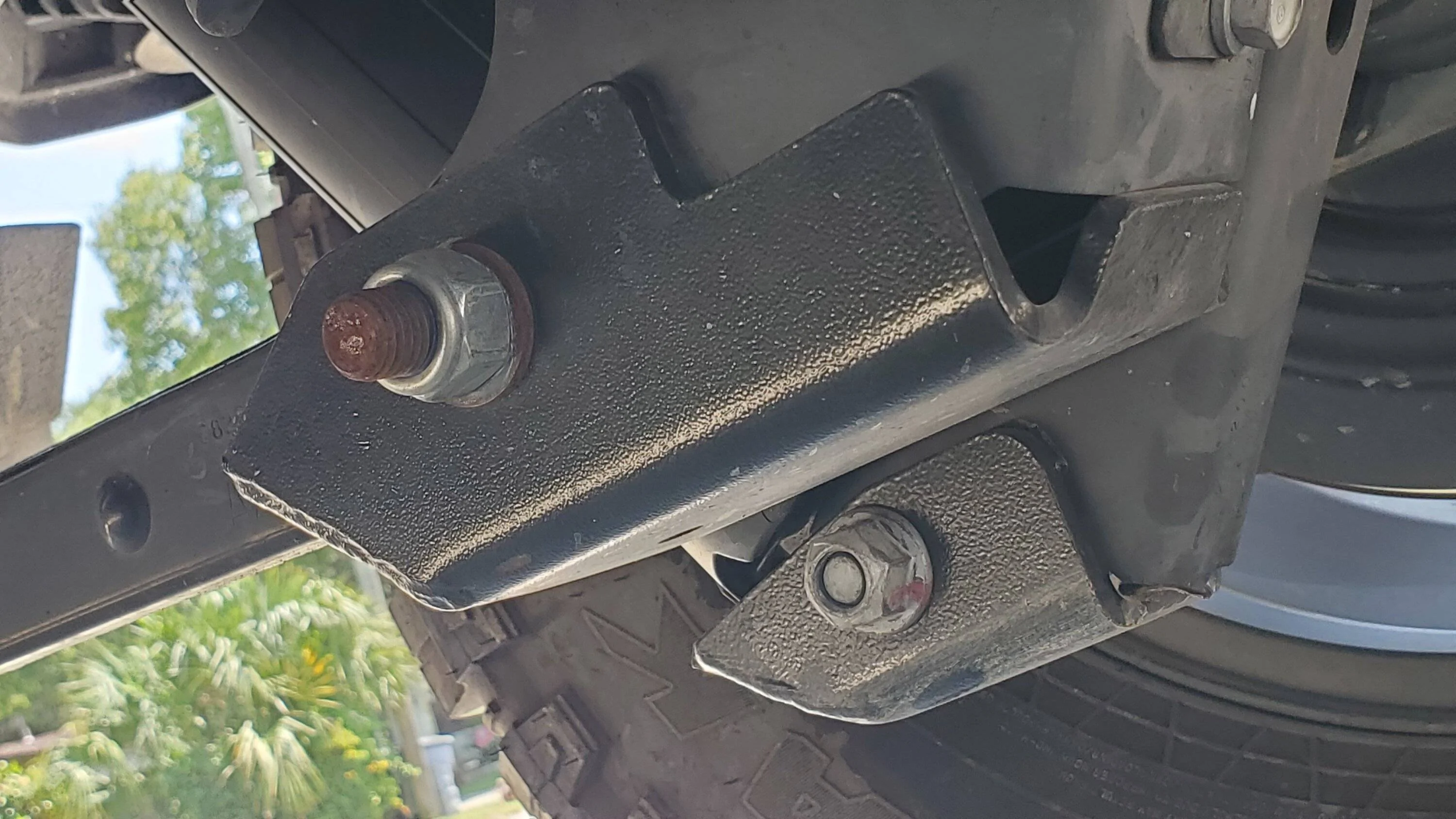

I was pissed that (at least when I got them) the RH rear shock skids had you re-use the OE bolt, which was too short given the thickness of the skid. Got the first one put on and torqued, then saw that the end of the bolt was inside the nut, not extending at least 2 or 3 threads past as you'd want.
So I said screw it and ordered these:
https://datinfab.com/jeep-gladiator-jt-shock-skids/
which are bomb proof but required even longer bolts.
For me, that rusty rear frame side LCA bolt would draw my eye every time I walked up to the drivers door and would annoy me. Enough so that I was willing to spend the money and do the work to replace all of the RH supplied bolts.

Thanks. Reading the RH instructions it looks like the shock skids now include bolts, but the factory nuts that are reused.
Maybe I'm missing something, but it looks like your Belmetric order included 6 bolts. Which should have covered front/rear Lca (4) and shock mount (2) skids. Why did you get Datinfab shock mount skids if you already replaced hardware for the RH kit?
You say the Datinfab require even longer bolts, were they included?
Now that I look under my Jeep though, I might be focusing on the wrong products. I hit frame side of the lca, not really on the axle side. Not saying I shouldn't consider both, but wrong focus.
I have the RH front and rear axle side and frame side LCA skids. The front frame side skids are still using the OE bolts and nuts.
I immediately uninstalled that one RH shock skid. Never ordered longer bolts for them.
Yes.

The rust on those bolts are going to tear up the nylon in the nuts when you remove them. And I would recommend removing and replacing the bolts and new lock nuts.
