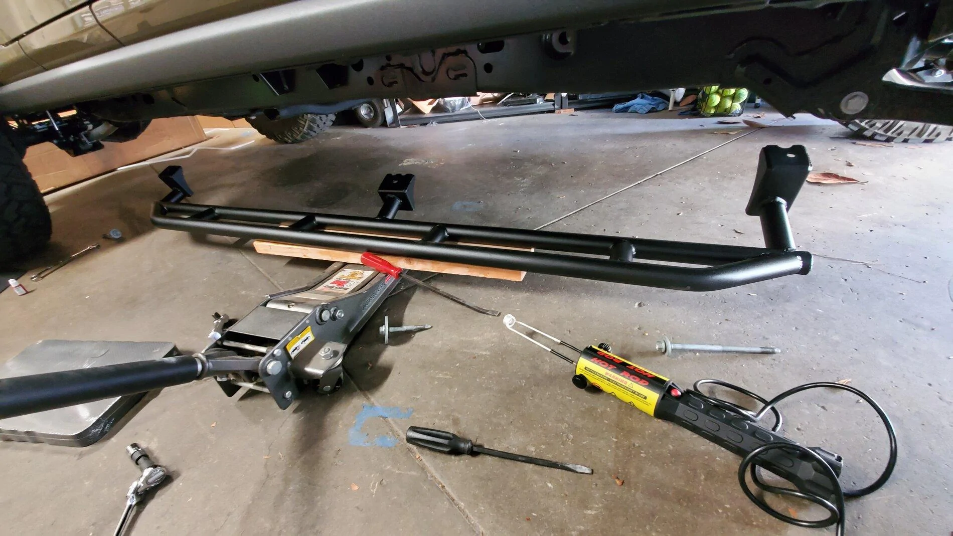

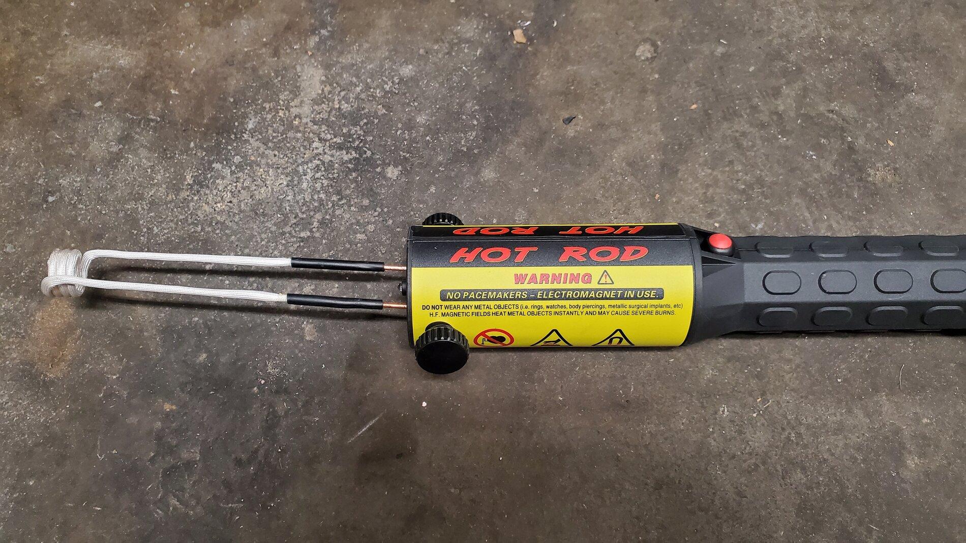

I cheated and used a Induction Heater. Came out with little fuss.
Did you heat them all and for how long on each?
180
29,428
35,004
Yes I heated them all, each for about 30 seconds. They get hot quick.
I'll bet they did.
It reminds me of a school science demonstration where an aluminum ring was placed on an electro-magnet and a momentary switch was literally just pressed and released. The ring shot into the air was was so hot it couldn't be touched or picked up.
That form of heating is efficient as heck, fast.
I need to get one of those heaters as I run into stuck pole shoe screws constantly in my restoration business. Sometimes I drill things out but what a waste - and the time it takes.
